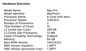

Thought I would add mine to this list as well
after upgrading to 144.0.0.0.0 and 10.14.5 I am getting shutdowns/Kernel panics when my cMP sleeps. this is a completely new behavior, I haven't noticed any other issues. Specs in sig.
Here is the first part of the log.

Add me to the list with the sleep crash (2010 CMP w/2 x 3.46/64GB AMD HD 7950 10.4.5)
First time for this crash.

Unable to gather system configuration information.Model: MacPro5,1, BootROM 138.0.0.0.0, 12 processors, 6-Core Intel Xeon, 3.46 GHz, 64 GB, SMC 1.39f11
Graphics: AMD Radeon HD 7950, AMD Radeon HD 7950, spdisplays_pcie_device, 3 GB
Memory Module: DIMM 1, 8 GB, DDR3 ECC, 1333 MHz, 0x80CE, 0x4D33393342314B37304348442D4348392020
Memory Module: DIMM 2, 8 GB, DDR3 ECC, 1333 MHz, 0x80CE, 0x4D33393342314B37304348442D4348392020
Memory Module: DIMM 3, 8 GB, DDR3 ECC, 1333 MHz, 0x80CE, 0x4D33393342314B37304348442D4348392020
Memory Module: DIMM 4, 8 GB, DDR3 ECC, 1333 MHz, 0x80CE, 0x4D33393342314B37304348442D4348392020
Memory Module: DIMM 5, 8 GB, DDR3 ECC, 1333 MHz, 0x80CE, 0x4D33393342314B37304348442D4348392020
Memory Module: DIMM 6, 8 GB, DDR3 ECC, 1333 MHz, 0x80CE, 0x4D33393342314B37304348442D4348392020
Memory Module: DIMM 7, 8 GB, DDR3 ECC, 1333 MHz, 0x80CE, 0x4D33393342314B37304348442D4348392020
Memory Module: DIMM 8, 8 GB, DDR3 ECC, 1333 MHz, 0x80CE, 0x4D33393342314B37304348442D4348392020
AirPort: spairport_wireless_card_type_airport_extreme (0x14E4, 0x8E), Broadcom BCM43xx 1.0 (5.106.98.102.31)
Bluetooth: Version 6.0.12f1, 3 services, 27 devices, 1 incoming serial ports
Network Service: Ethernet 1, Ethernet, en0
Network Service: iPad, Ethernet, en5
Network Service: Wi-Fi, AirPort, en2
PCI Card: PXS2, USB eXtensible Host Controller, Slot-2
PCI Card: AMD Radeon HD 7950, Display Controller, Slot-1
PCI Card: AMD Radeon HD 7950, ATY,HamachiParent, Slot-1
PCI Card: pci1b21,625, AHCI Controller, Slot-3
PCI Card: PXS4, USB eXtensible Host Controller, Slot-4
Serial ATA Device: HL-DT-ST DVD-RW GH61N
Serial ATA Device: WDC WD1001FALS-41Y6A1, 1 TB
Serial ATA Device: ST2000DM001-1ER164, 2 TB
Serial ATA Device: ST2000DM006-2DM164, 2 TB
Serial ATA Device: ST3000DM008-2DM166, 3 TB
Serial ATA Device: SanDisk Ultra II 960GB, 960.2 GB
FireWire Device: built-in_hub, Up to 800 Mb/sec
Thunderbolt Bus:
Anonymous UUID: AF64C102-BCDE-47D2-D6C0-4375DAAB7CA9
Fri May 24 08:55:49 2019

You have a starting point to debug this, your Mac Pro still has BootROM 138.0.0.0.0, from Mojave initial release.
Upgrade to 144.0.0.0.0 using the full Mac App Store Mojave installer for 10.14.5
Just like with the bootROM update issue I was having because of using a NVME SSD, it now seems that the sleep issues I'm having on my Mac Pro (not waking back up from deep sleep) is also being caused somehow by using a NVME SSD as the boot drive.
I've tried sleep using my SM951 AHCI SSD, and all is fine waking up from deep sleep.
All these issues started around 10.14.4. Has there been changes to the NVME implementation somehow that is causing all this?
Thanks...was able to upgrade to 144.0.0.0. Will let it sleep overnight and see what happens.
