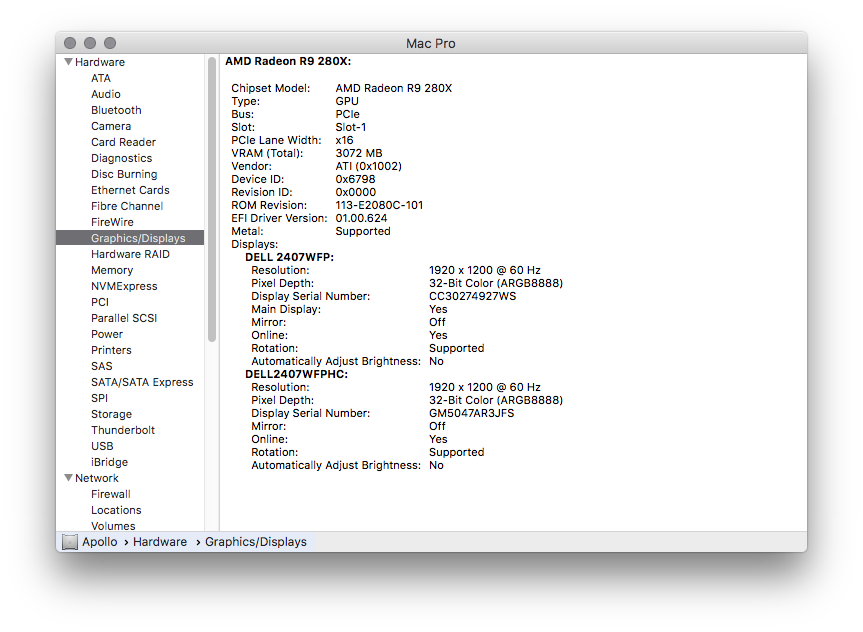

here is my current setup. I'm leaning towards a yes for my question but I do not know the answer absolutely so here goes..
wondering if this video card will support two 4K Displays via the mini DisplayPort outputs?
that is two displays @ 3840 x 2160 resolution running at 60Hz

here's my current setup.. two Dell 2407WFP's. 3840x2160 would be nice but 2560x1440 will work fine too..
