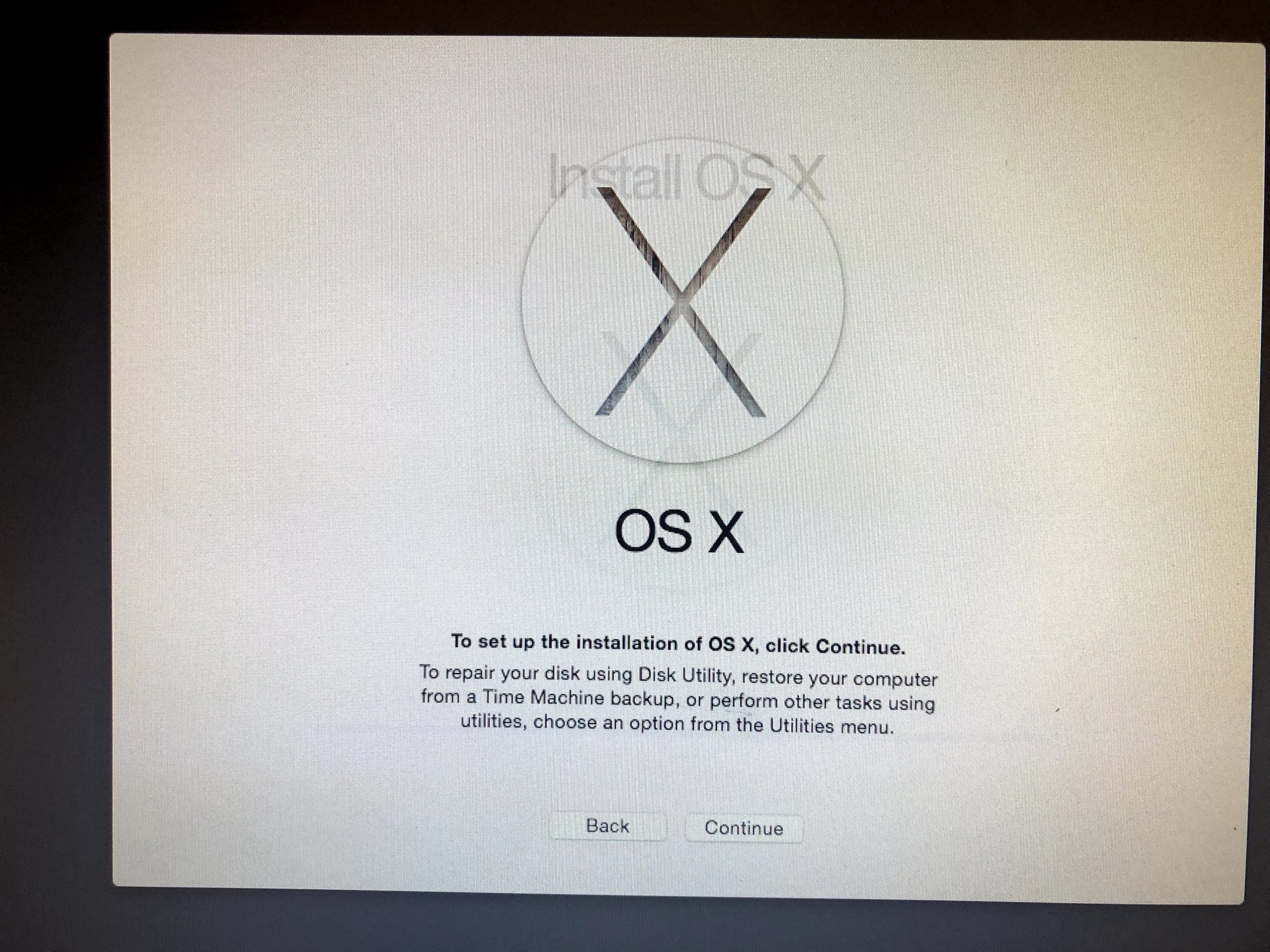

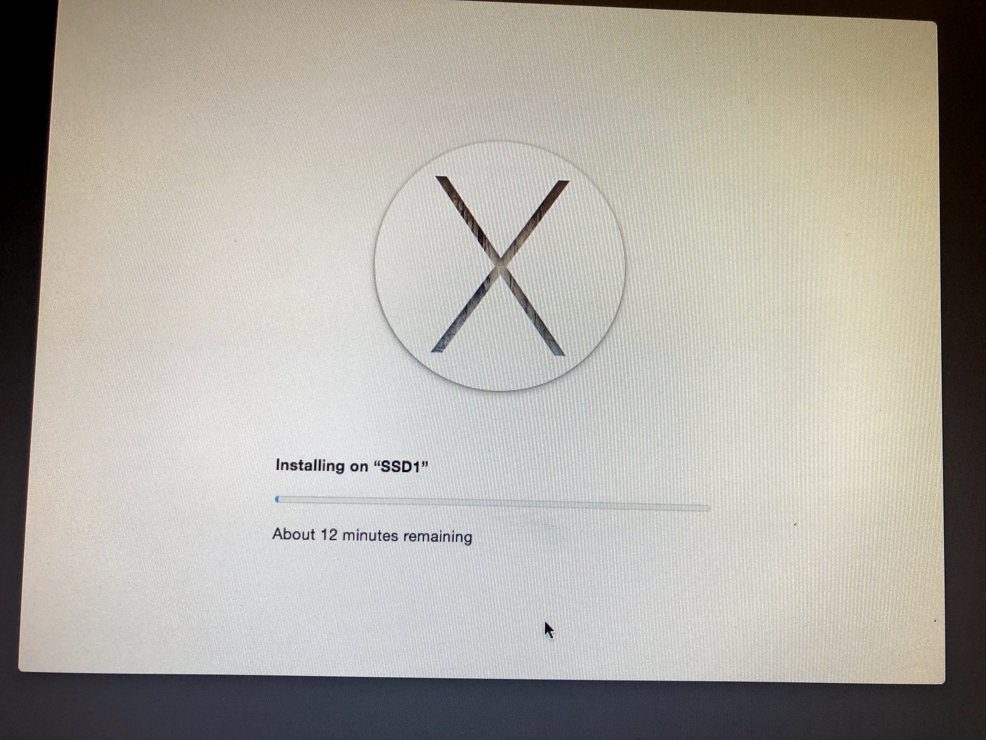

I managed get the install process a lot further than I have ever before with any of the OS I tried. Yosemite I managed to get to the below stage as shown:
Yes, you guessed it, the install process started and about 15% along the machine crashed. After a few timse reaching the same stage and not getting any further and the machine crashing I decided to leave it off and try again in the morning.

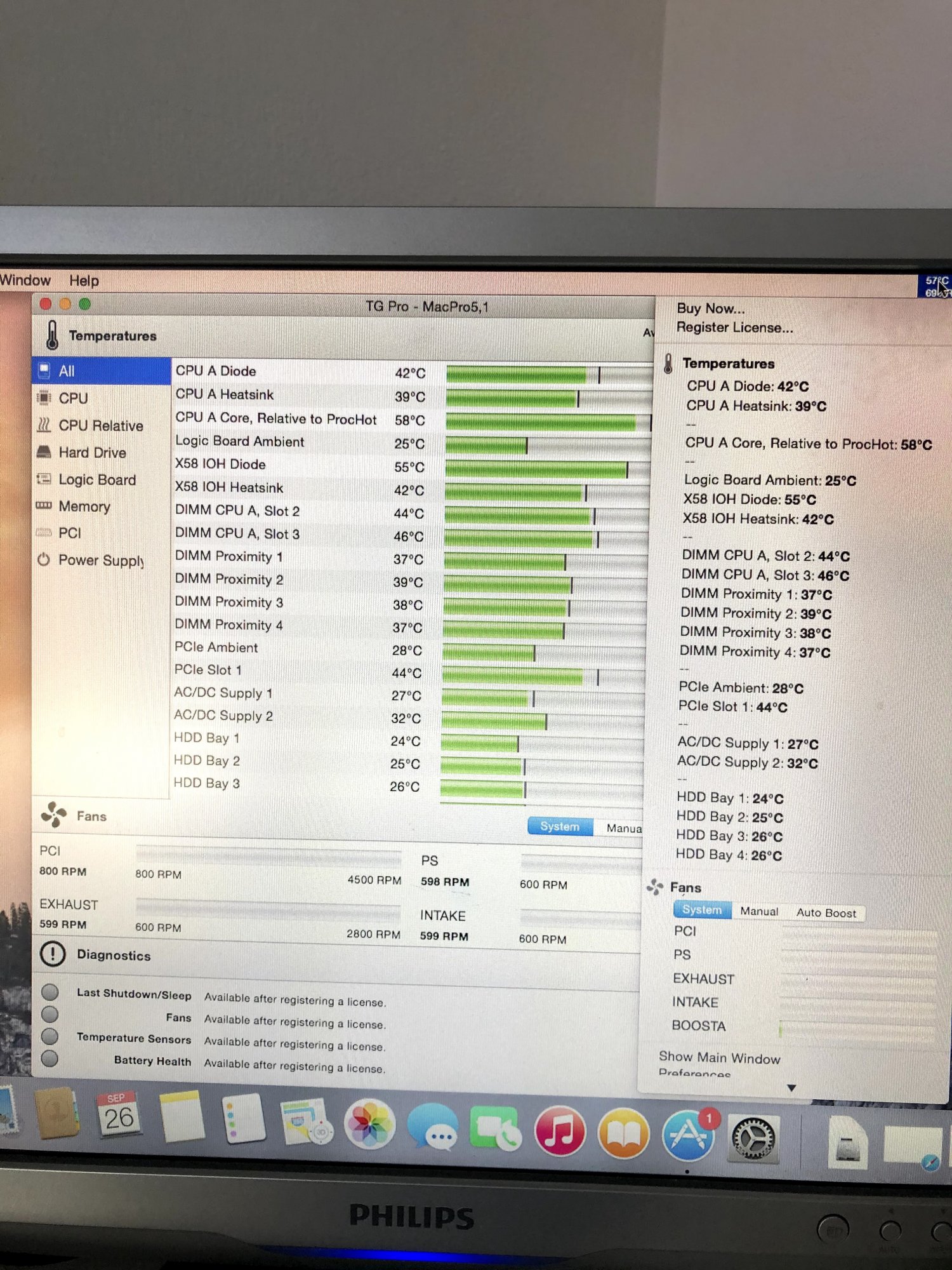

In the morning, I booted it expecting for it to do the same thing, and low behold it installed and I had a running OSX. I ran a few system updates they downloaded and installed all fine. I also managed to find a programme that checks the temperature of the various parts on the machine as during my research there are instance where some part of the system gets too hot, and the temperature senor shuts it down to prevent damage occurring to the hardware.
Below is the screen shot I managed to take; yes you have guessed it; it crashed while the OSX was running and seconds after I too this picture.
