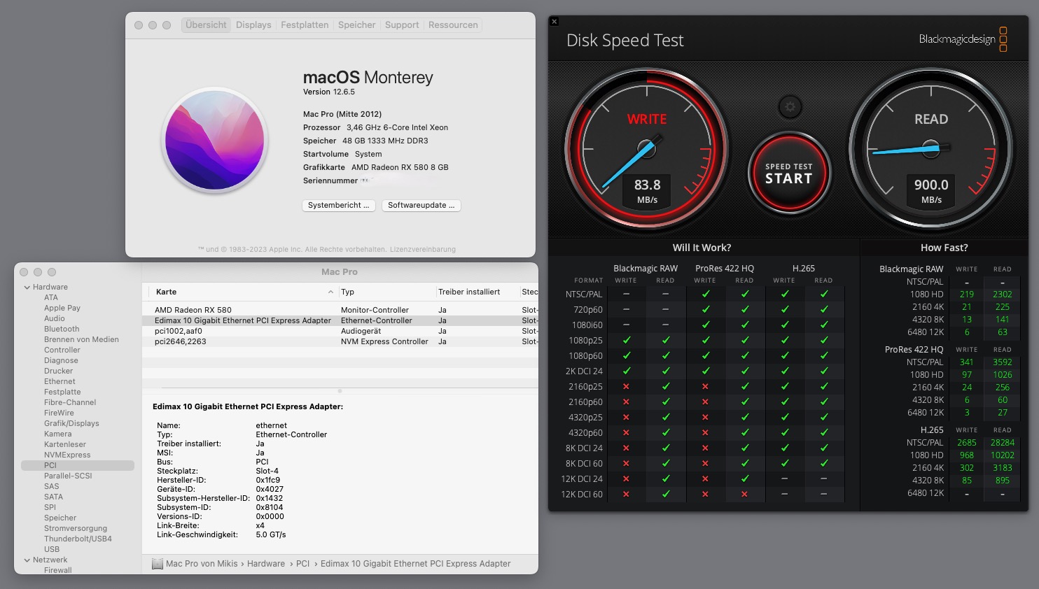

I can confirm, that the Edimax EN-9320TX-E will work with Monterey up to 12.6.4 and OCLP in a MP. You can get the latest driver from here: driver. But to be clear: Tehuti is out of business and the latest driver is from early 2020 so Monterey is probably the end of the road for Tehuti based cards.
Did you test this with cMP 7.1 or cMP 5,1? They may behave completely differently with Monterey 12.6.4. one reason is the different intel architecture.
The Edimax card work with the latest akitio driver, Monterey 12.6.4 and OCLP in a MP 5.1 2012 and MP 4.1 2009 flashed to 5.1.

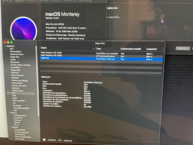

Hello, I just received the card. I installed it with the latest driver. the card is well recognized but the driver does not seem to be recognized.
the card is installed on PCI port 4.

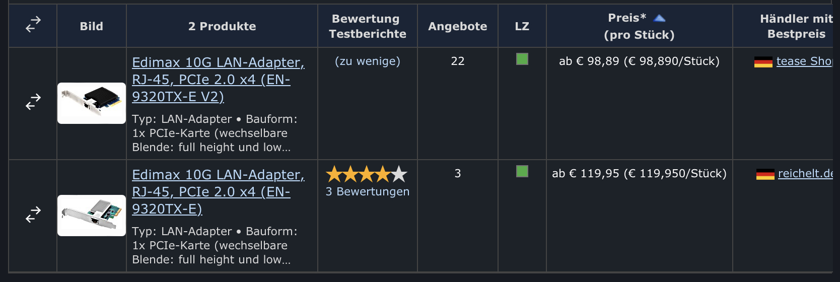

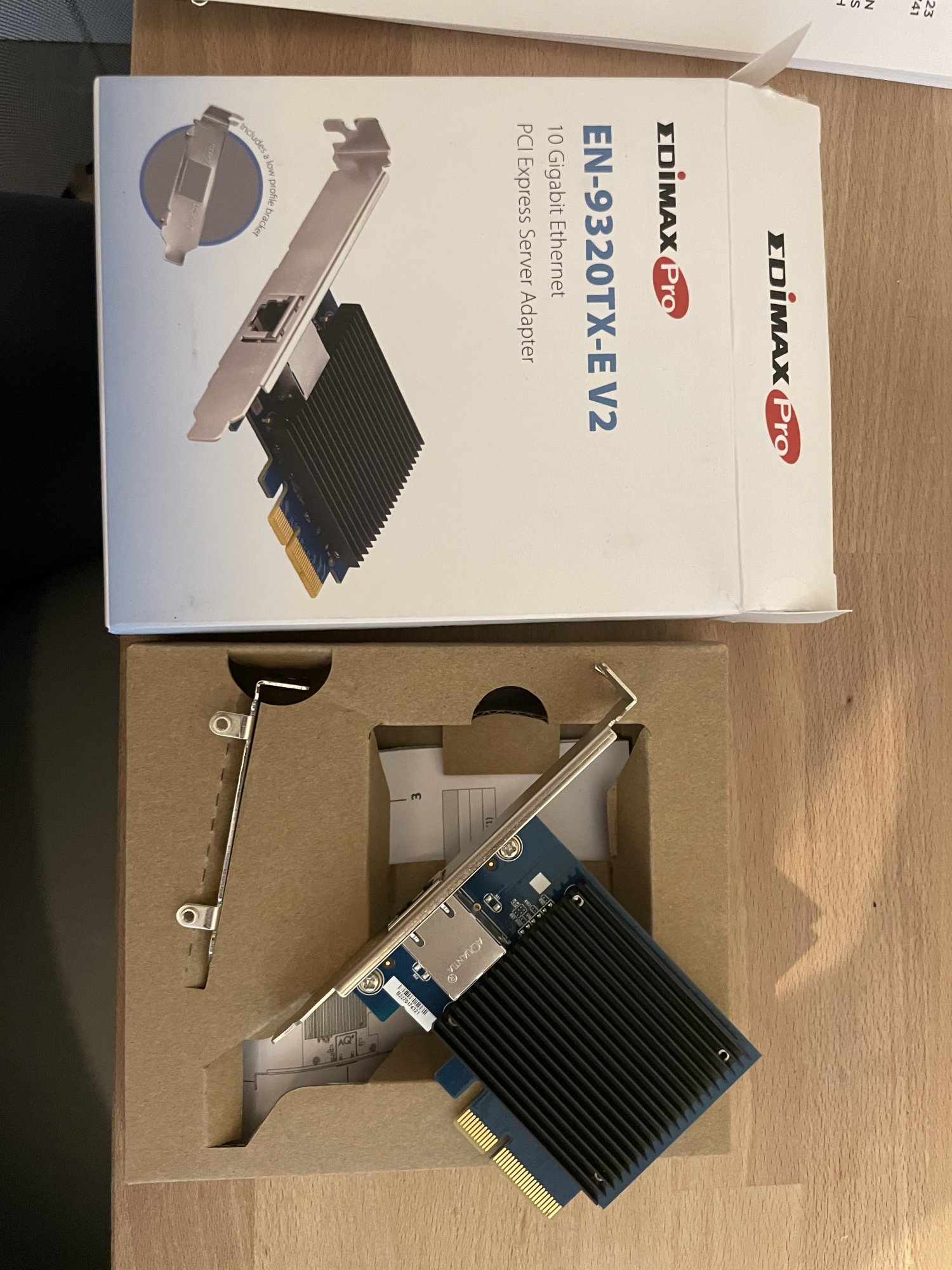

Just checked and there are two versions of the Edimax EN-9320TX-E and EN-9320TX-E V2, first with silver and the second with black cooler. Unfortunately the second one has another chipset from AQtion, so the driver for the Tehuti based one will not work.
Hi,
Indeed I received the second with a black cooler EN-9320TX-E V2.
I will be making a return of this card.
I ordered the EN-9320TX-E version.
She arrives in four days.
THANKS.
