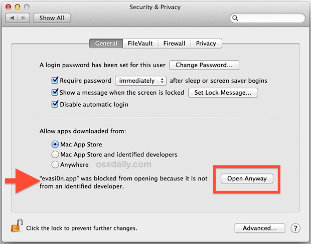

When you installed the web driver did you have SIP enabled? If you have never disabled SIP then it was on by default. SIP needs to be ENABLED when installing the drivers. It's very easy to check with terminal, type "csrutil status" without quotes to find if SIP is enabled or disabled. The first time you install the GPU driver you need to add a gatekeeper exception. I believe for the CUDA driver also. To add the exception, during the install of the drivers you need to go to System Preferences/Security and Privacy - General Tab and choose "Open Anyway". That adds the GateKeeper Exception. Here's just an example of the window I found on the web. Hope this resolves your issues.
P.S. If I remember correctly when I first installed the drivers I didn't add the exceptions but the installer appeared to finish, like all was okay. It looked like the driver was loaded but it was not complete. I saw the same things you are seeing. Re-installing the drivers and adding the exceptions resolved all issues.

The key is the Gatekeeper, if you want to keep Gatekeeper on, you have to Enable SIP for Nvidia web driver installation (and then you have to manually allow Nvidia web driver manager to run in the security preference).
But if you are happy to keep Gatekeeper off, then my recommendation is also keep SIP off. I am running with both OFF, and no issue so far. And no extra procedure to allow the Nvidia web driver manager to run.
