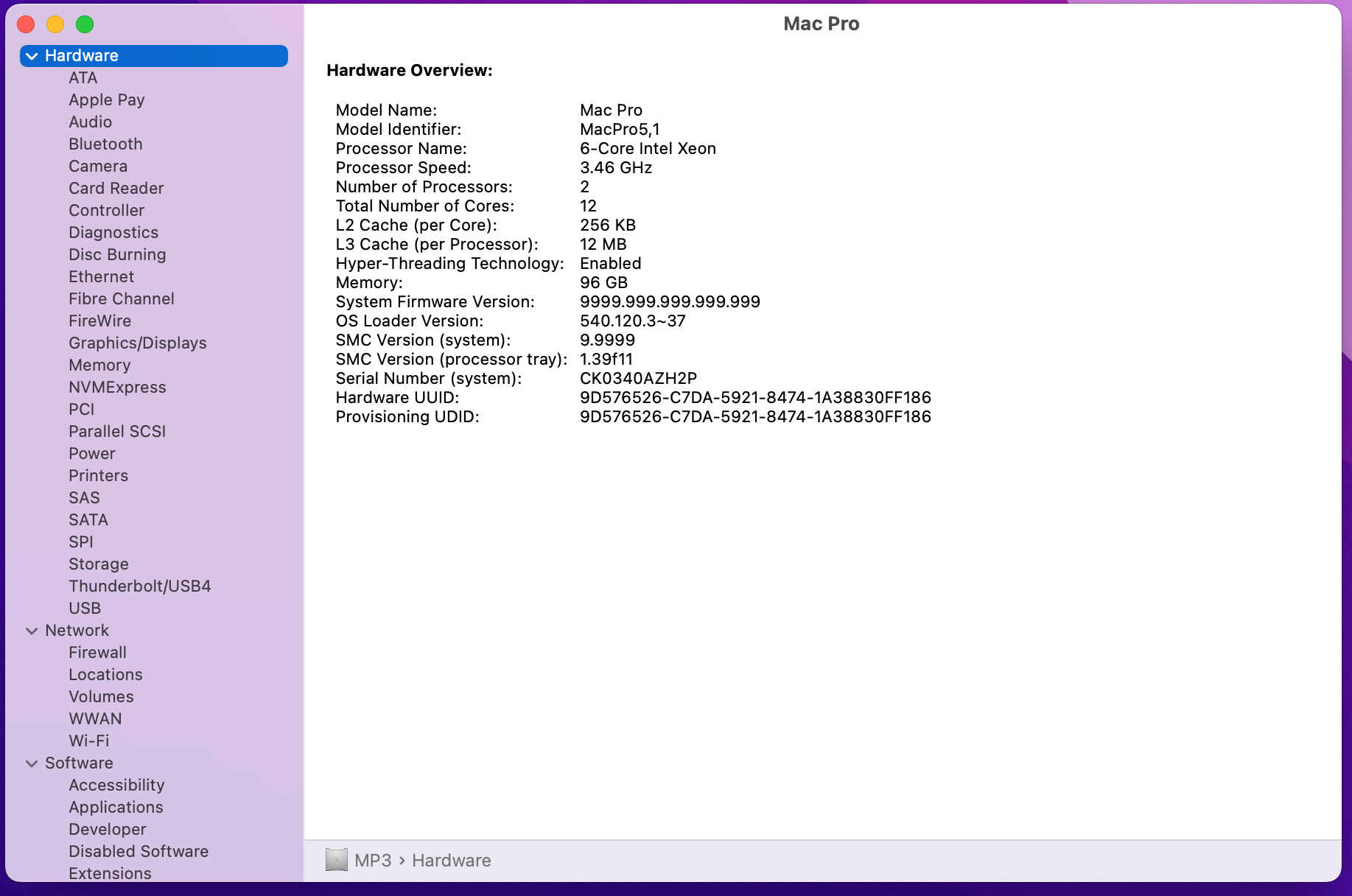

Firmware version 9999.9999.9999.9999.9999.
What?????
Something's obviously badly out of whack here
I have no idea what to make of this.

It's probably the battery. I seem to remember this sort of thing happening on one my other machines a few years ago

You still need to boot anything between 10.6 to 10.14, native/without OC/OCLP, and check the real BootROM version.
If your Mac Pro doesn't have 144.0.0.0.0 yet, you will need to upgrade it.
