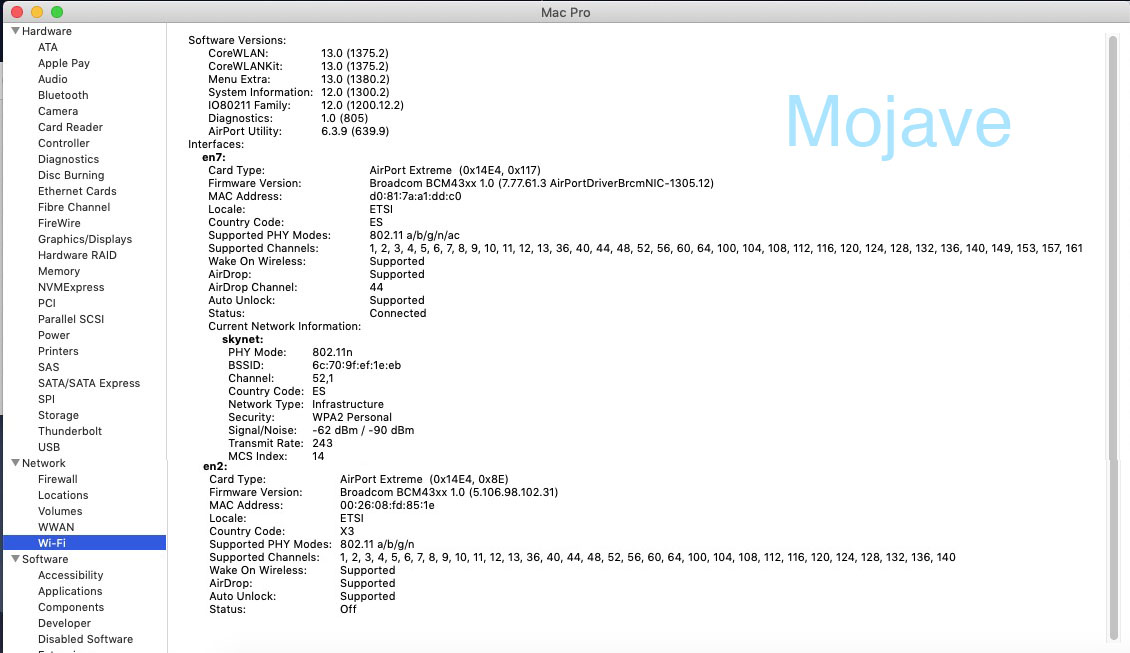

Yesterday I took the plunge and did a clean install of Monterey on my MacPro 5.1.
Everything went well and to my surprise both the USB3 cards and a flashed RX580 worked great from the start.

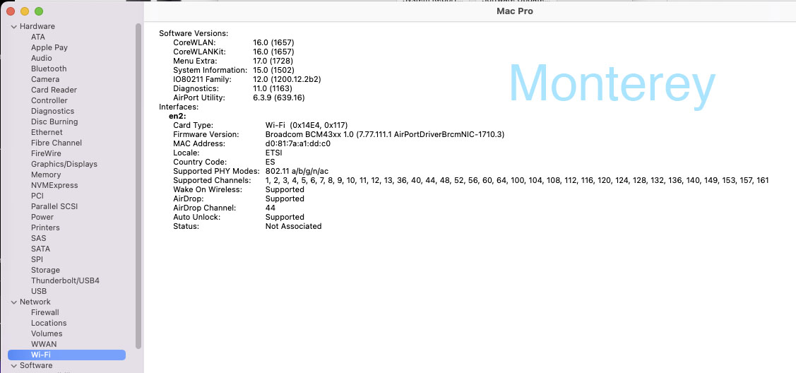

I'm also surprised to see that bluetooth through a cheap WTXUP BCM94360 still works in Monterey. However, WiFi through the same card does not.

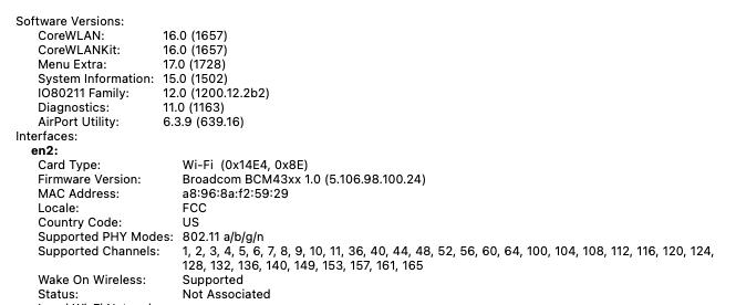

WiFi (and Bluetooth) still work fine on Mojave. But I never removed the original Airport card from the computer, I just disconnected the antenna and power cable from the Bluetooth card.
Is there any hope that wifi can get to work in Monterey with this card? Apparently it is similar to the simpler Fenvi card.

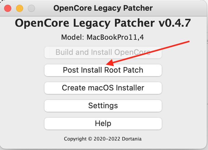

Use OCLP to install the old WIFI driver Kexts.
I have an old 2010 5.1 with the original Airport card and BT 2.1 card.
Upon installation the Airport did not work. I went back into the OCLP app and clicked "Post Install Root Patch"
The software automatically installed the missing drivers and airport worked upon reboot.

I would reconnect the original apple airport and BT cards.
Then run the OCLP kext patch. to see that you have working wifi and BT.
After that you can try to get that Chinese PCIe card to work.
I never removed the Airport card. Followed you suggestion and removed the Chinese card and reconnected the BT card, restarted the computer ant voila!, the Post Install Root Patch was available.
But after running the patch and rebooting a few times, wifi and bluetooth still do not work.

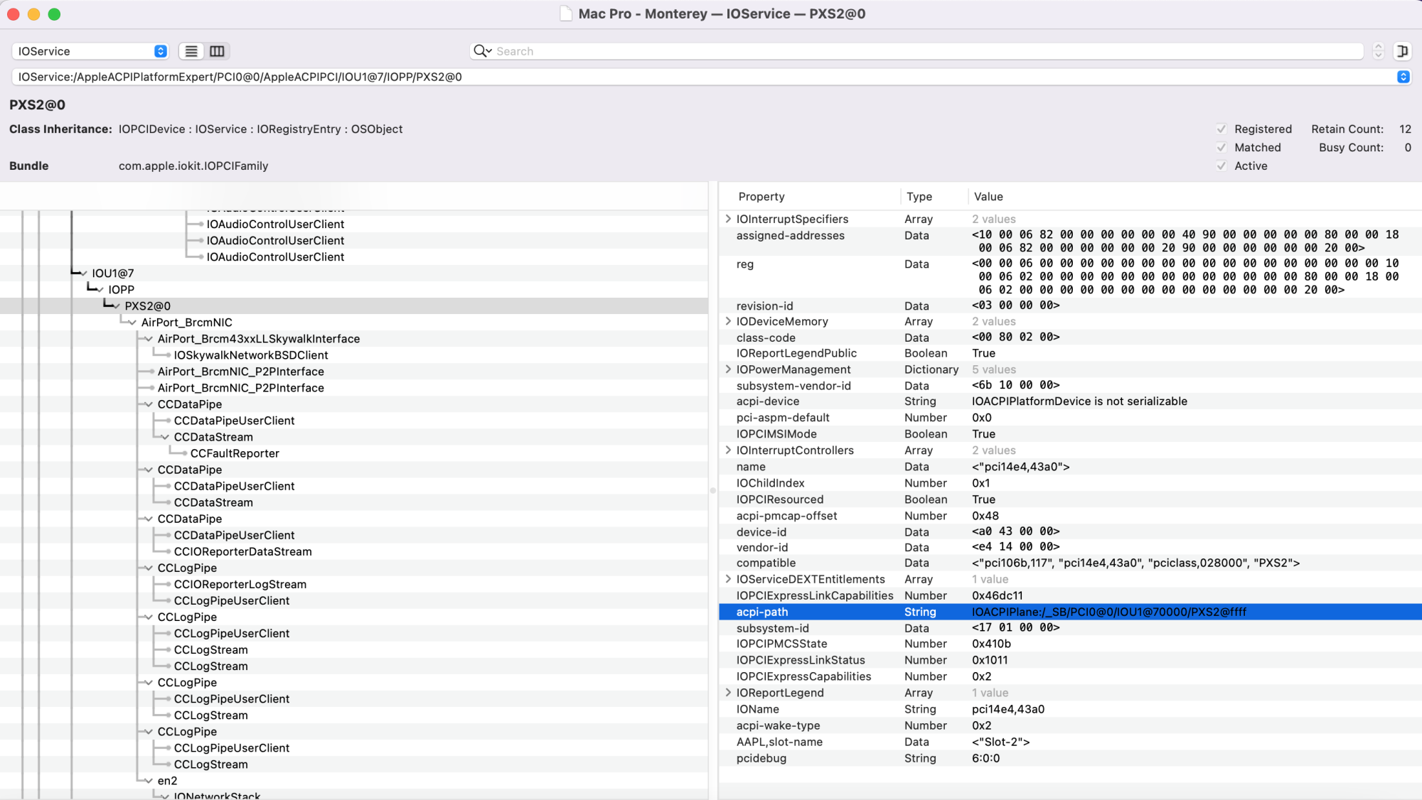

That means that the wifi in use is the original one where you disconnected the antenna cables. Without them the wifi will not connect to anything. Why don't you disconnect the original card to avoid confusion?

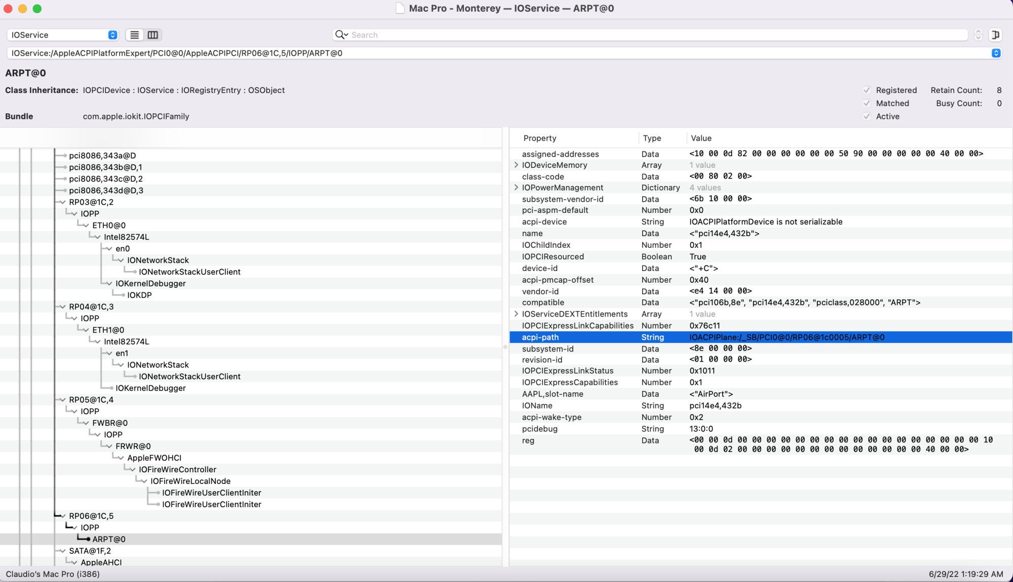

I can see 2 cards in the ioregistry, but the FENVI wifi is not attached properly and does not appear as an ARPT device:
And here is the original card properly registered, but without antennas:
As you can see the devices RP03, RP04, RP05 and RP06 are all occupied by the 2 ethernet ports, the firewire port and the original wifi and there is no more RP0X devices available to attach. So, you need to free some resources. Remove the original card and make a back up from the registry.

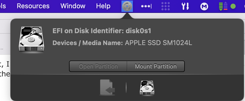

Download OpencoreConfigurator. When you run it and click on it in the menu bar it will show several disks and one of them will say Opencore partition. Select mount partition. There are your OC directories and files and the config file:

  1. Manually connect using the "other" option on the Wi-Fi menu bar or manually adding the network on the "Network" preference pane in system preferences. Make sure you are logged into iCloud, when I had this problem with an old airport card I could not manually add my wifi ID and password. However I used a network cable to connect to the router in order to complete the set up and once I had Keychain in iCloud set up it automatically connected to the WIFI.
  2. if the above does not work, open OCLP and click "Post Install Root Patch" and let it do its thing. At least it will get the old Airport card working. And if it doesn't automatically connect to your wifi then you will need to manually connect using the "other" option on the Wi-Fi menu bar or manually adding the network on the "Network" preference pane in system preferences.
the other suggestions above seem to think you installed OC manually, which is causing confusion.
I did the Post Reinstall Root Patch once again and did exactly what you suggested.
Now WiFi works fine with the original card.
I noticed that no matter how many times I did the Post Reinstall Root Patch, the Legacy Wireless patch shows up as available, even after having WiFi working fine.

After more than a year of operation without problems with OCLP 0.4.7 and Monterey 12.7.1, after installing OCLP 1.3 and Monterey 12.7.3, wifi has stopped working.
In the original installation I also had a problem that I solved by deleting the Wi-Fi preferences and activating iCloud, but after doing it 4 or 5 times I can't get it to work in OCLP 1.3.
The only thing I see that has changed is that the previous AirportDriver version in Monterey was BcrmNIC-1710.3 and when updating it is BcrmNIC-1710.4.
