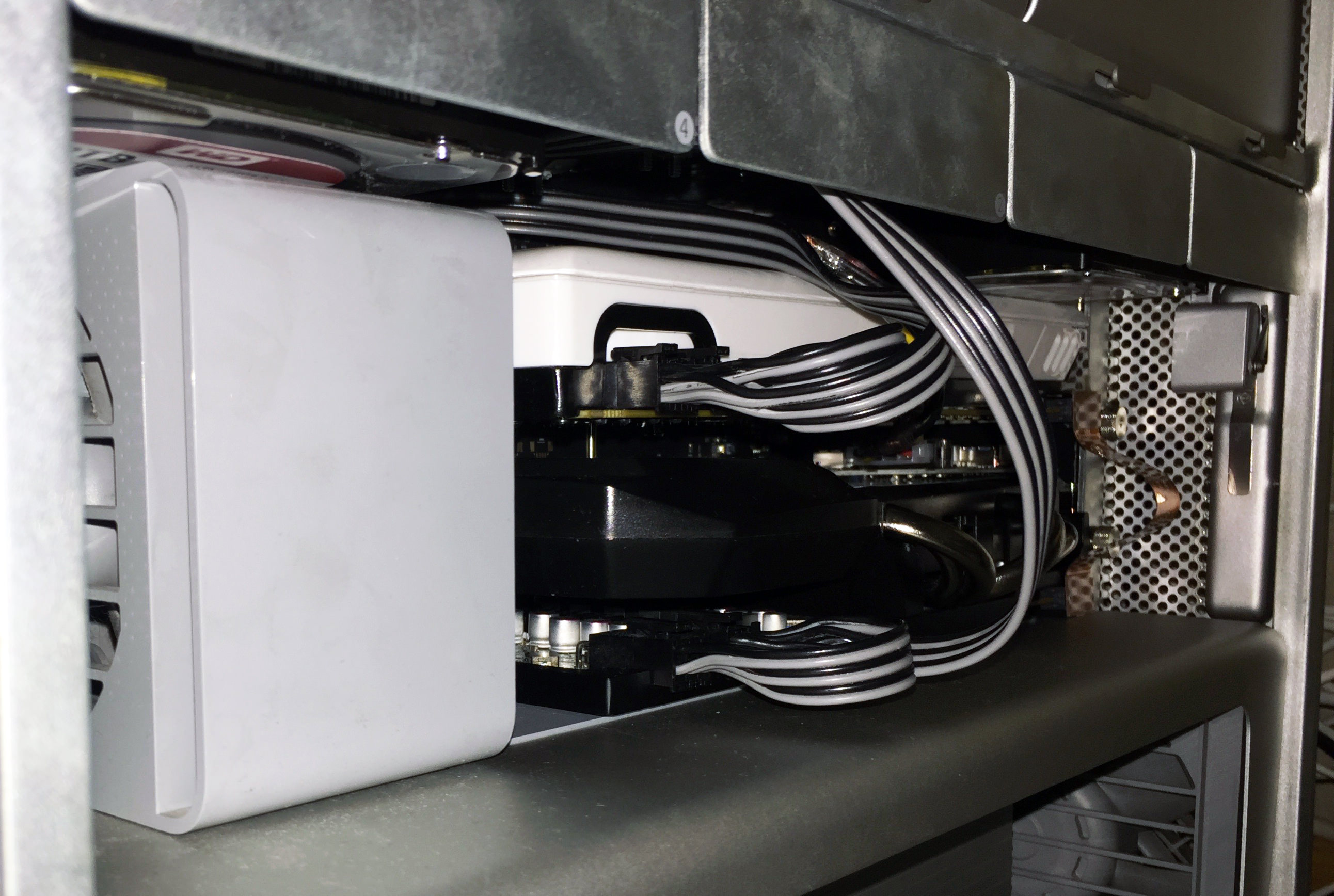

Anyway, this is my original setup. Both GPU installed into the x16 slots. And let the USB 3.0 card to use the remaining x4 slot. This config should give out best performance.
However, as you can see, the fan on the white card (7950) is fully covered by the black card (280). End up the 7950 run very hot and noisy (max 88C @66% fan). Even though it seems that the HDD also block the 280's fan, but it isn't. Also, this particular fan can suck air from below, so cooling is not a problem for the 280.

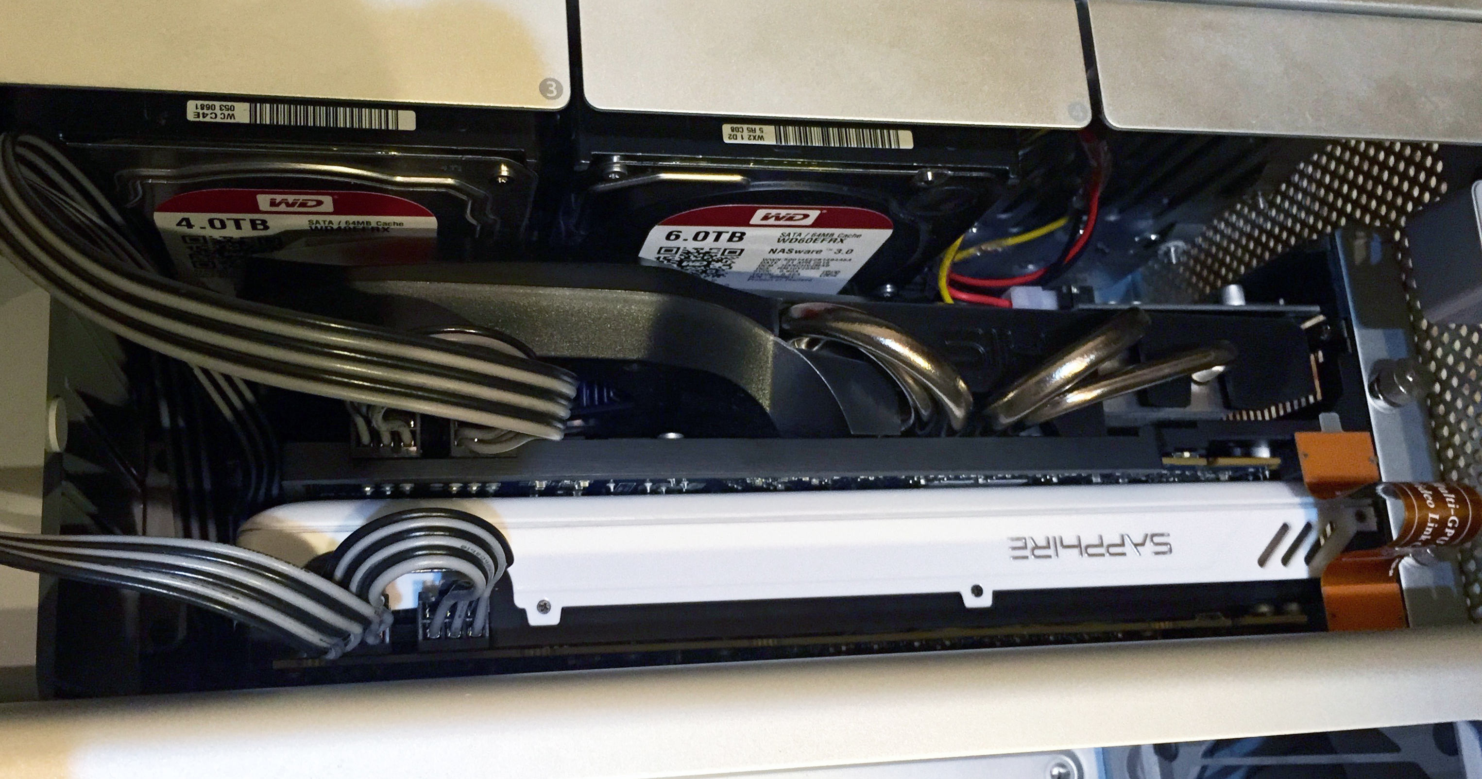

Since I don't want to kill my 7950 again (by heat). I re-arrange it as follow.
By installing the 7950 in slot 3 and move the HDD to bay 4, now there is enough room for the fans to work properly. Both card now run very quiet under full load. Even though it's not necessary, this config also provide an extra gap for the 280's cooler to suck air from above.

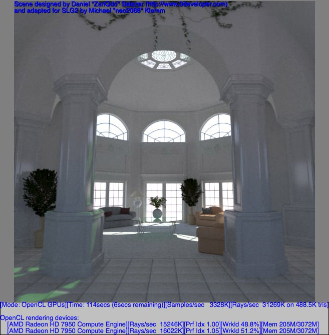

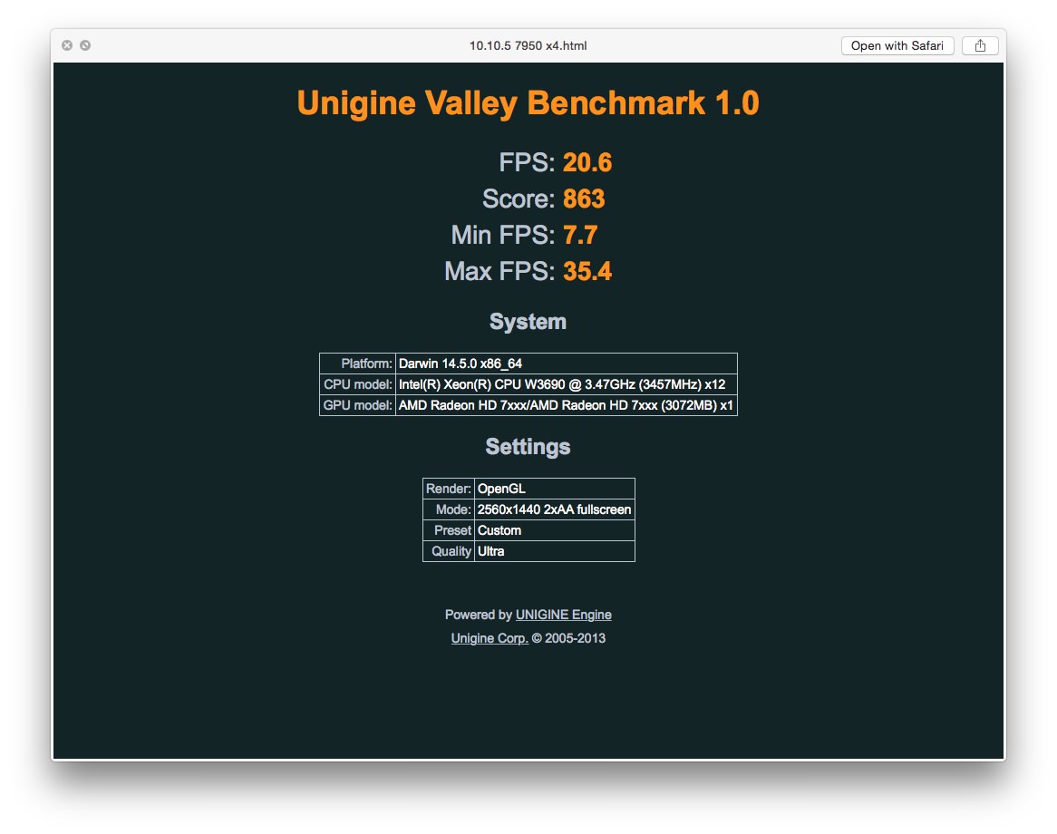

However, with this config, obviously I have to scarifies some performance from the 7950. Because slot 3 is a x4 slot, but how much I actually lost? Here is the result.
From this result, the GPU in a x16 slot contribute 51.2% and the card in a x4 slot contribute 48.8%. That means total performance penalty is just 2.4%, not significant at all. I am more than happy to trade 2.4% performance for much much better cooling (max 71C @36% fan) and 10 times less noise (of course, this is just my feeling, but not scientific figure).
In fact, there is almost no real world penalty.

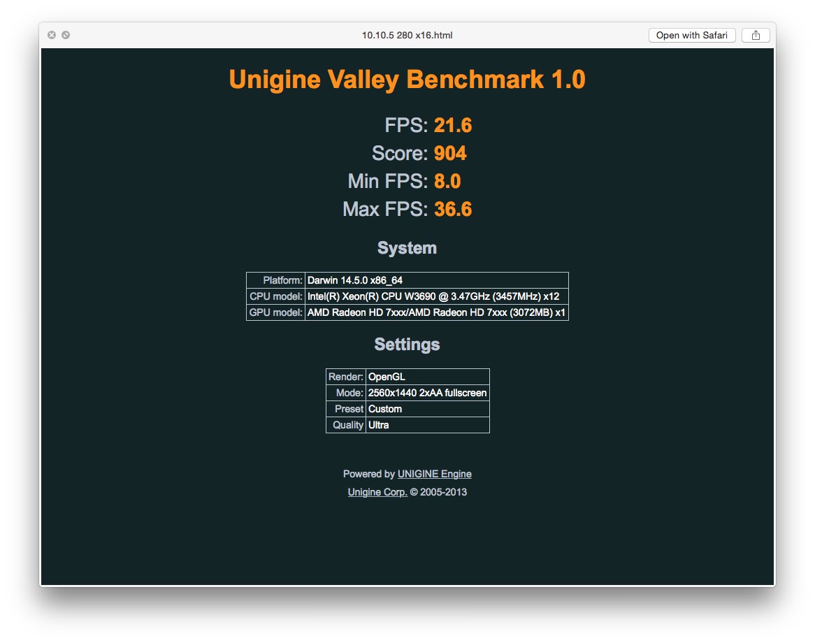

Just did more tests, and this time mainly focus on the 3D performance.
The result from the R9 280 which installed in the x16 slot.
The result from the HD7950 which installed in a x4 slot.
I only run this test for once due to time constrain. From the FPS or score, there is a 4.8% performance hit for the card installed in a x4 slot. So the overall performance hit is 2.4%, exactly the same figure shows in the Luxmark test.

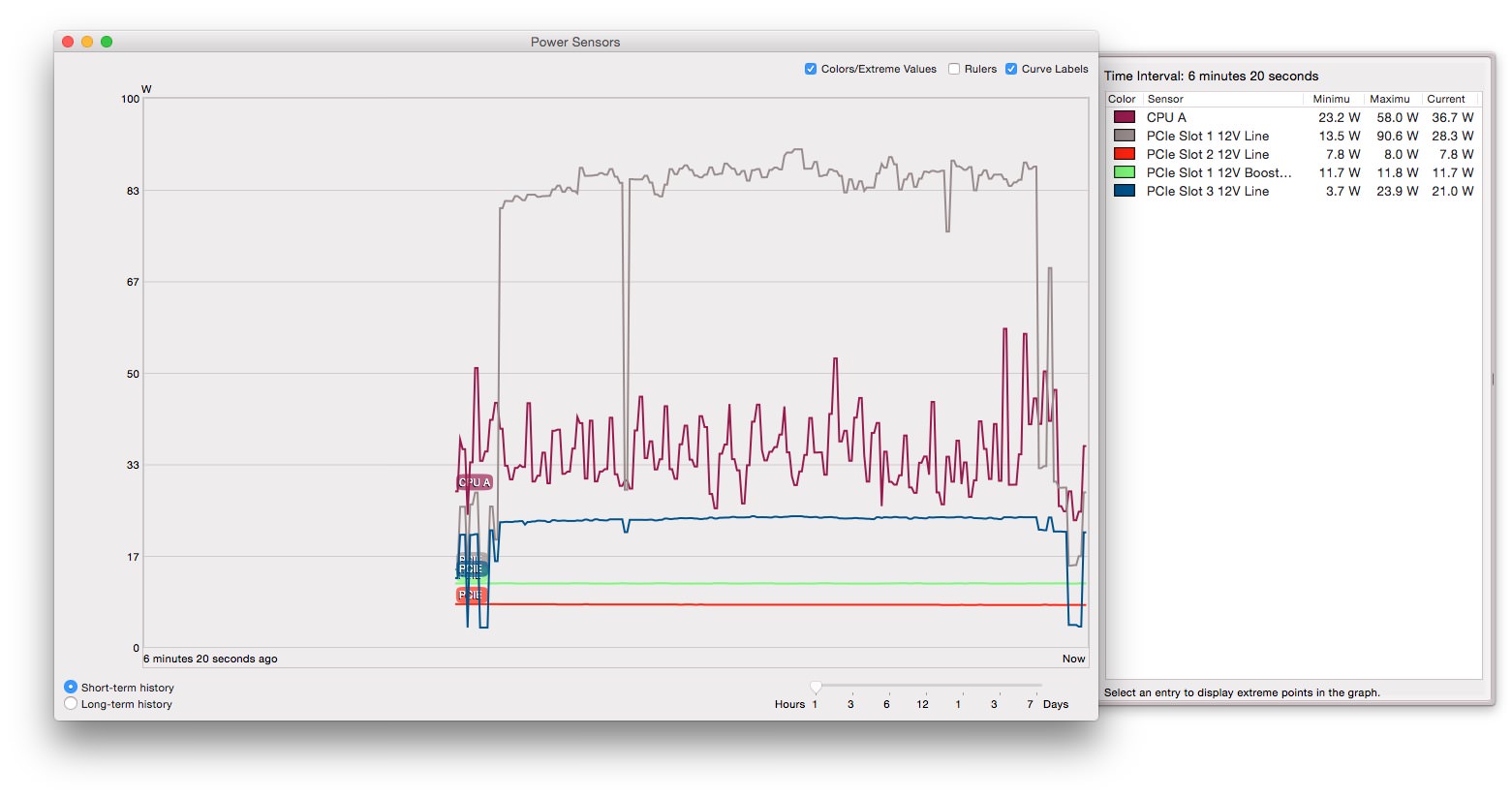

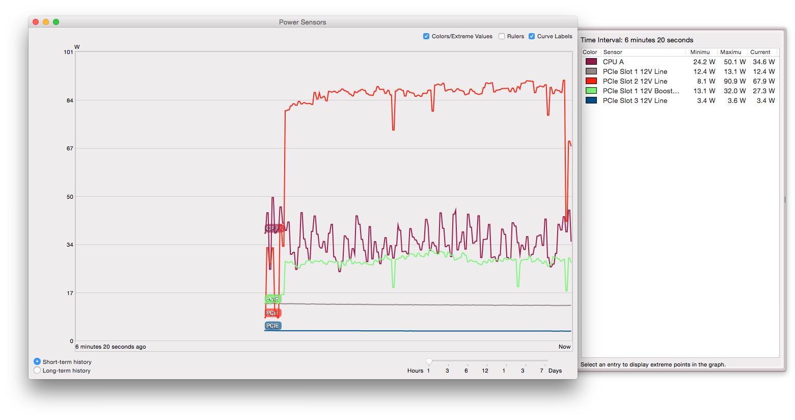

And now, let's see how about the power consumption. Since there is no Crossfire in OSX and I only connect one monitor to the Mac at this moment. So I simply capture the power draw during the last Valley benchmark.
During the R9 280 test (slot 1), total max power draw from the card = 90.9+32 = 122.9W
During the HD7950 test (slot 3), total max power draw from the card = 90.6+23.9 = 114.5W
