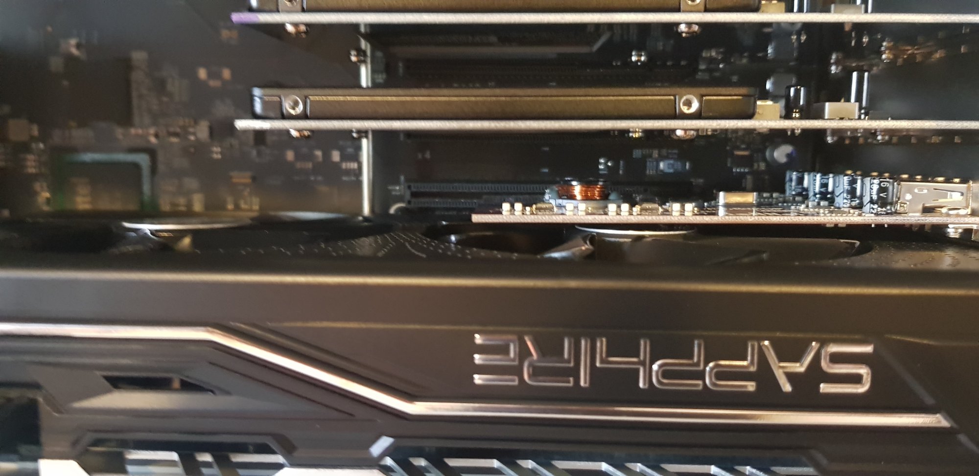

how harmful can a usb3 card be so close to gpu?
do I run the risk that the GPU will heat up too much?
the cards do not touch each other, between gpu and usb about 5 millimeters.
I do a lot of video montages, so the card is always at work.
can the fan that runs so close to the sonnet usb3 compromise usb3 data with interference?
I know they seem silly questions. but i'm never sure to break my precious mac 🙂

If I were you I would attach a thin piece of plastic to the sonnet card from underneath and let it extend a little more to the space between the two fans on the video card.
I have an RX580 in slot one, and a PCIe SSD in slot 2. They are close enough that I made a little spacer (about 1mm) to ensure the fan blades wouldn't hit. HD and 4K editing on all manner of FCPX projects - no issues.
From the picture, perhaps slot 4 is open? Can you move the USB3 card to slot 4?

I don't think that it would be an issue. One fan is completely open, and more than half of the second fan is open.
Maybe put a small plastic (non-conductive) spacer between the two to get an extra mm of clearance - but don't put too much force on the two cards.
Watch the temps when you put them under stress, and take other action if the temps are too high.

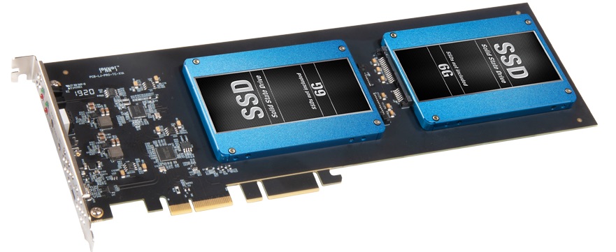

I decided to replace my Allegro Type A usb 3 sonnet card, with Fusion Dual 2.5-inch SSD RAID sonnet, so as to have in a single card 2 ssd and a usb c. in this way free slots over gpu.
I will keep owc accelsior s as the boot drive.
can there be contraindications? does anyone own it and can you give me feedback?
thanks
Why not use a NVMe SSD with the really small Adapter Card? For the price of the fusion card you can buy an adapter and a new NVMe SSD.
The problem is we don’t know your setup, so it is not easy to give you a solution.
What are the the two SSDs for? Are your 4 drive slots in use?
I switched from Sapphire 580 Pulse to Vega Frontier, but before this switch I had a bit more distance to my dual SSD card than you.
Sometimes one can get one or two mm by moving the cpu cage down a bit.
Open the 5 cpu support bolts and the backplane screws in that area and carefully force the cpu cage down a mm or two.
Yes, this gives an extra mm also.
Sounds nasty but 2mm from the cage and 1 mm from moving the Backplane is a lot if the cards are pretty close.
