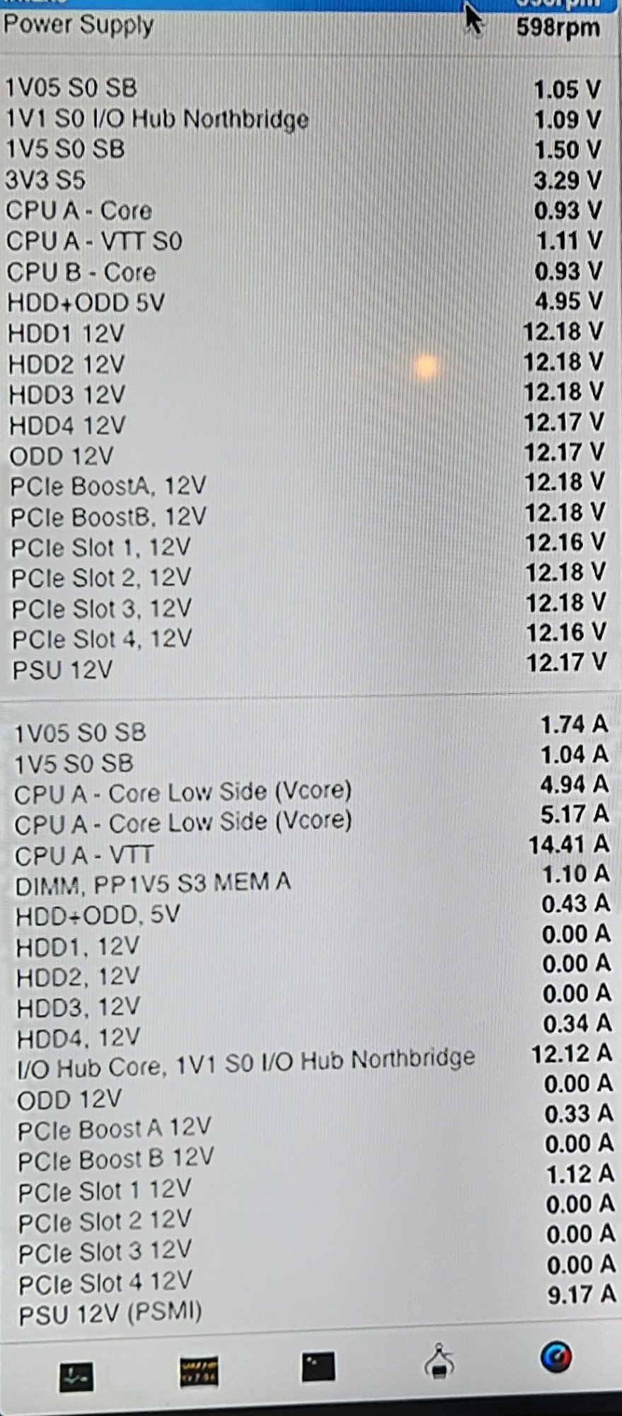

Mac never power up. But then I unplug the power then wait 2 or 3 days Mac power up, boot and every thing working perfectly. I already check the voltages with Istat menus there is a picture for that.
but one or two hours some times 2 days it shutdown like unplugged. and never power again or waıt 2 days🙁.

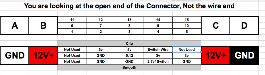

I search that power ıssues at that forum. than firstly I test my PSU. I found PSU voltage schematic as the attachment
and I tested PSU every voltage is same, there is no problem with voltages. But there is a clock sound coming from PSU ı don't know is it normal? the sound is ;
