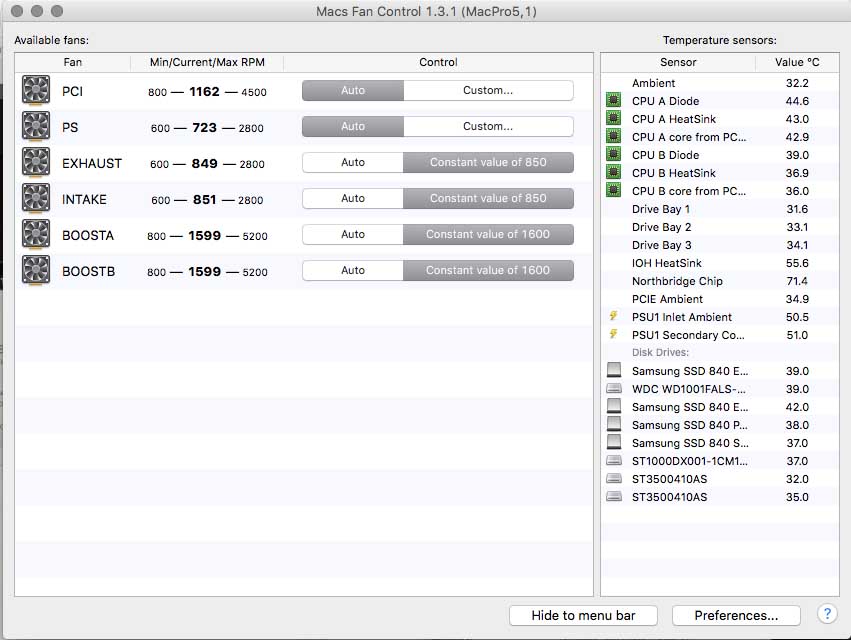

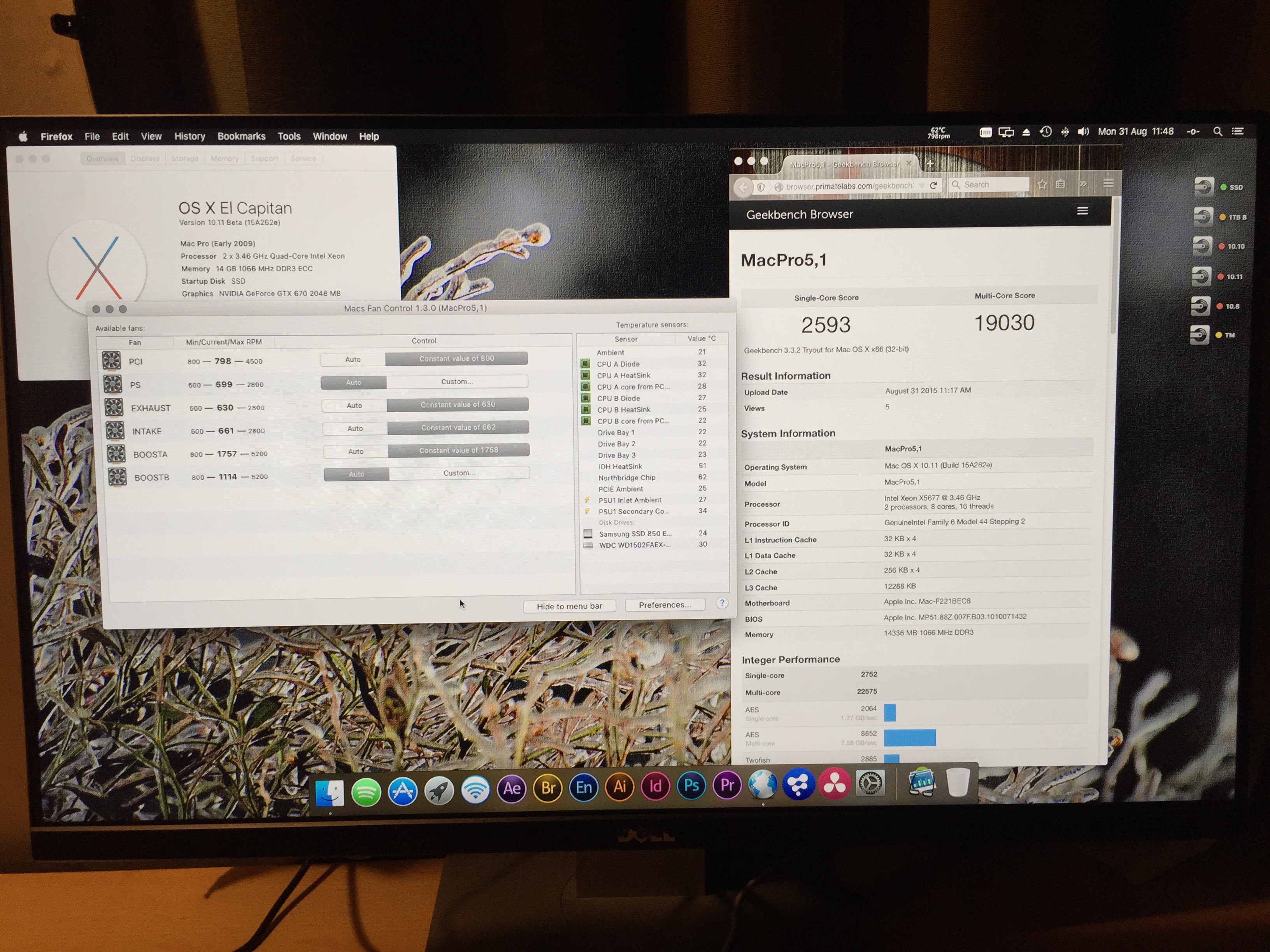

Got them in, all went to plan. Took me around two hours being super careful. Do these shots below of temps etc look ok? Northbridge goes up to around 72c if BoostA is left at stock speed, didn't repaste the NB, worried that I could have broken one of the retaining clips.

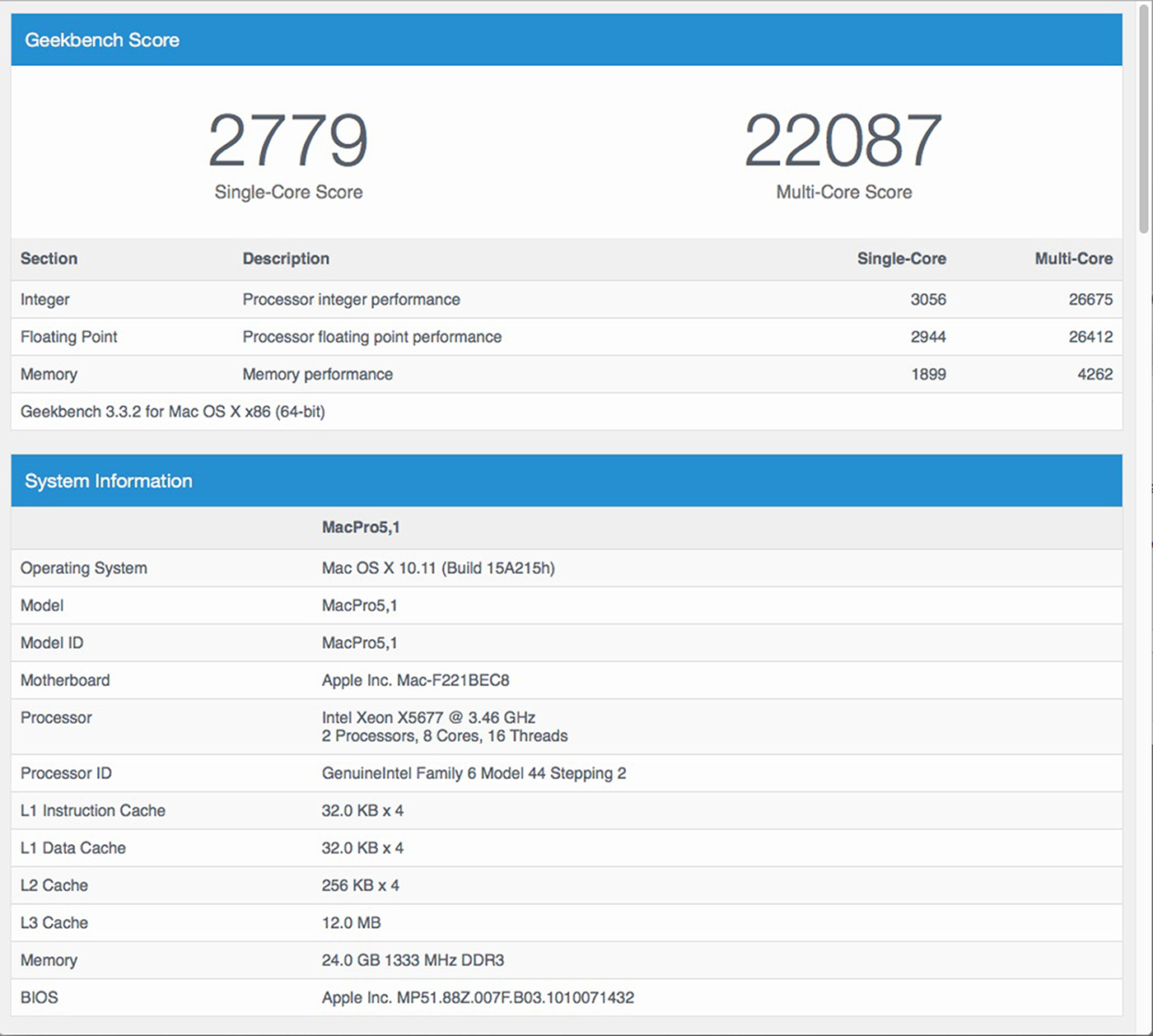

Glad things went OK😀 Temps look fine to me. Notice your running Geekbench @ 32 bit. See my chart running @ 64 bit.
Lou
