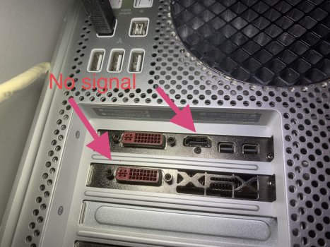

Hi everyone I'm still rocking a MacPro 5,1 with a Radeon HD 7970 that I bought off eBay a few years ago, it works great for work and some SD video editing and light gaming on the side.
I was updating my monitor setup and noticed a couple of the ports don't have any signal, marked below (lower DVI and HDMI ports).
Was it maybe flashed incorrectly? Is there any way to fix this? Really don't want to brick it as it's my work computer.

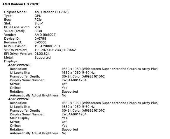

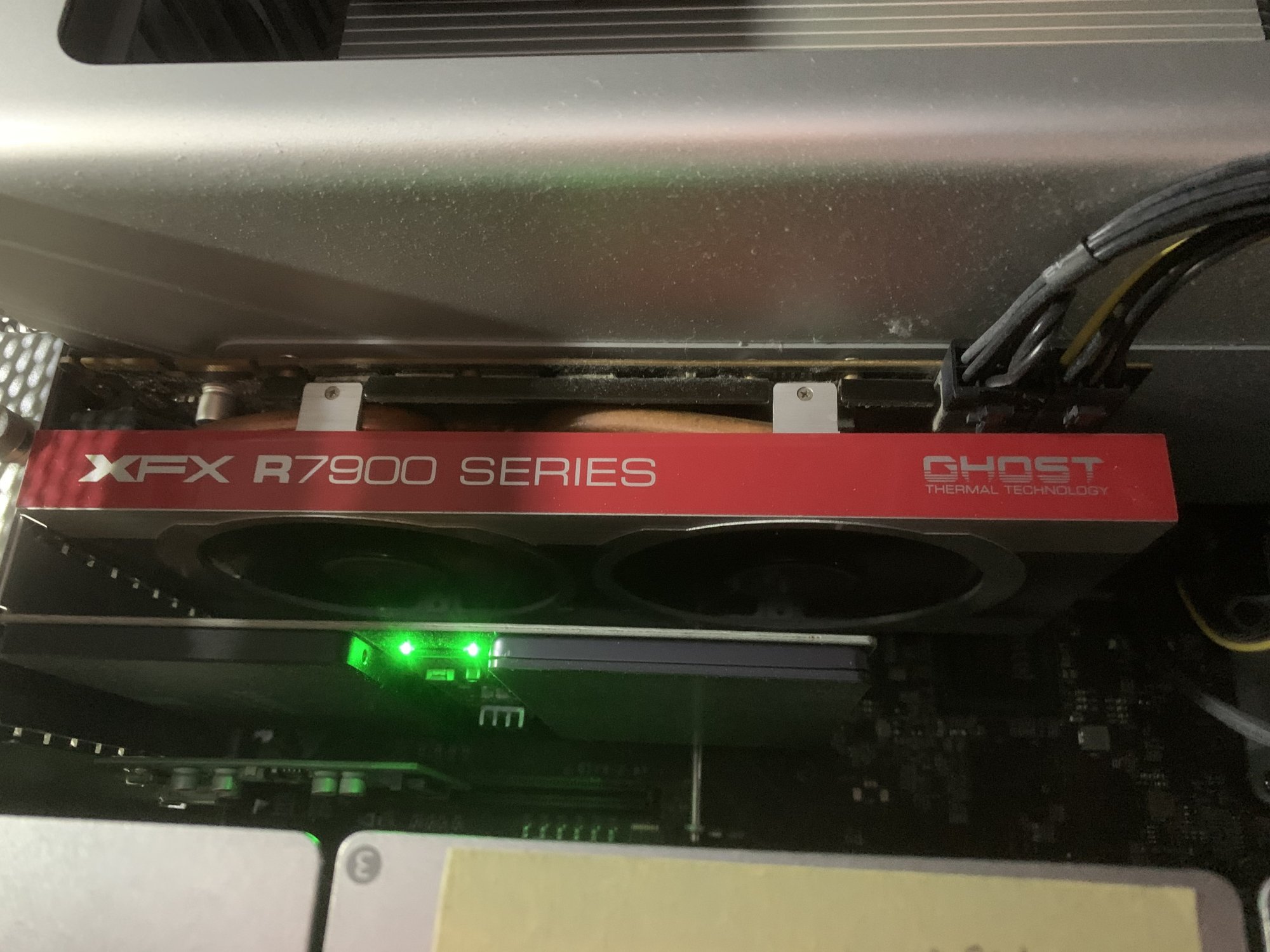

If it is flashed with the "Mac-EFI", this is expected behaviour: The card ports do not match to donor (Sapphire HD7590 Mac Edition), some ports will loose function.
I wrote several days possible solutions for this problem here: https://forums.macrumors.com/thread...m-issues.2413627/?post=32800170#post-32800170
If the card isn't flashed, it won't have the bootscreen, but all ports should work fine from OSX 10.8.3 up.
