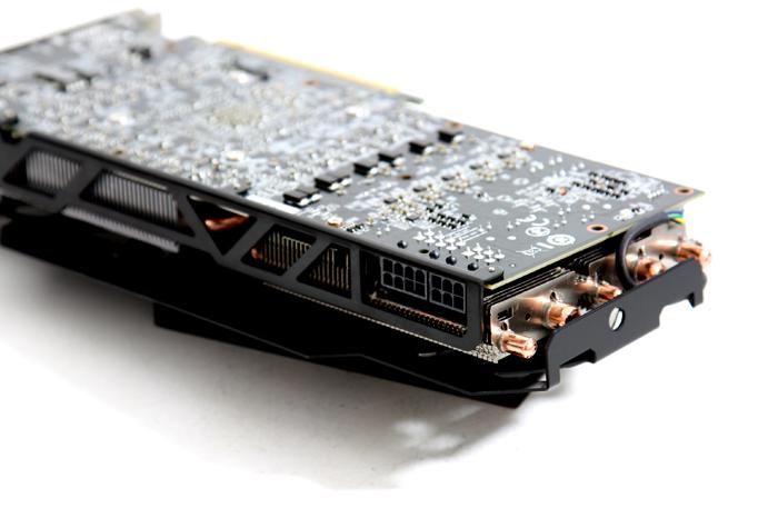

The R9 290X has both 8 pin & 6 pin power sockets. Both MUST be powered.
Gigabyte R9 290X
How are you powering the 6 pin socket ?
It MUST be powered. A 2 TWO X SATA to 6pin cable will do the job.
This card will also work with the EVGa powerLink
