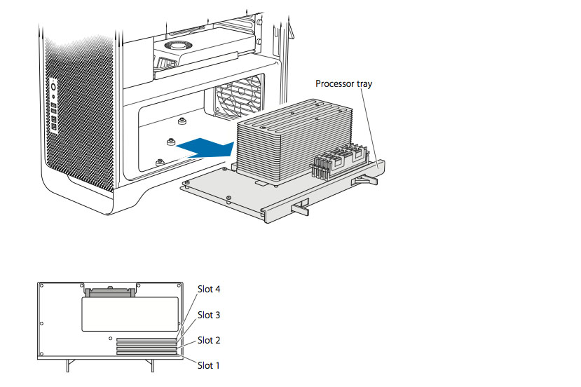

Are the slots labeled? Is the first slot closer to the CPU, or closer to the case door?
^^^^They are marked, but for clarification see attached.
Lou

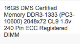

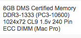

^^^^Thanks for your input. The 8GB DIMMsthat OP has and the 16GB DIMMs that DMS carries are indeed 1.5v.
Lou
