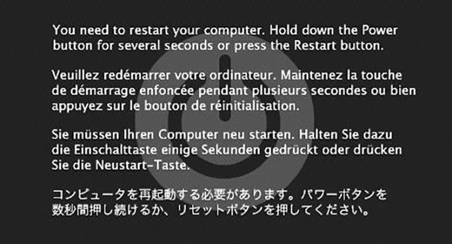

The moment I turn on my Audio interface Mac Pro restarts and then starts with kernel panic shown as below and then restarts once more time. after that only my audio interface gets connected. this whole process eats almost 10-15 mins,

Just bought a flashed Titan-Ridge T3 card, and when connecting my UAD Apollo, it restarts

My other issue is with install. Although I'm on Big Sur, it did not come without pain. I can never get through a full install without having to restart the computer. Yes, that's right, reboot after getting that shameful message saying "support.apple.com/mac/startup". Every time, no matter what setting or wishes I might say, it never runs through a full installation without crashing and me having to reboot at least 2-3 times. Everything works perfectly except the audio interfaces on Big Sur.
Something else to throw in there; whenever I restart Big Sur it doesn't boot back into Big Sur. What I mean is, I get the Apple logo and it sits there for a few moments with the progress bar just stuck and I end up finally having to hard reboot; or sometimes the support message shows up with the circle and line... if you know what I mean. Been trying to get this installation pinned down for a month now. Anyway, I really hope someone throws some magic my way. Please feel free to ask any questions.
