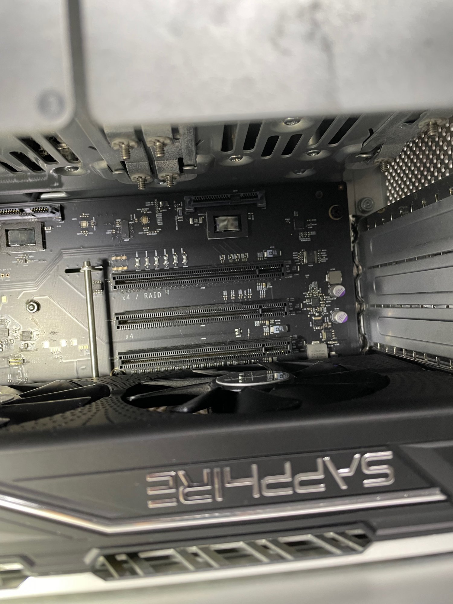

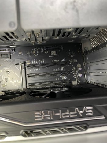

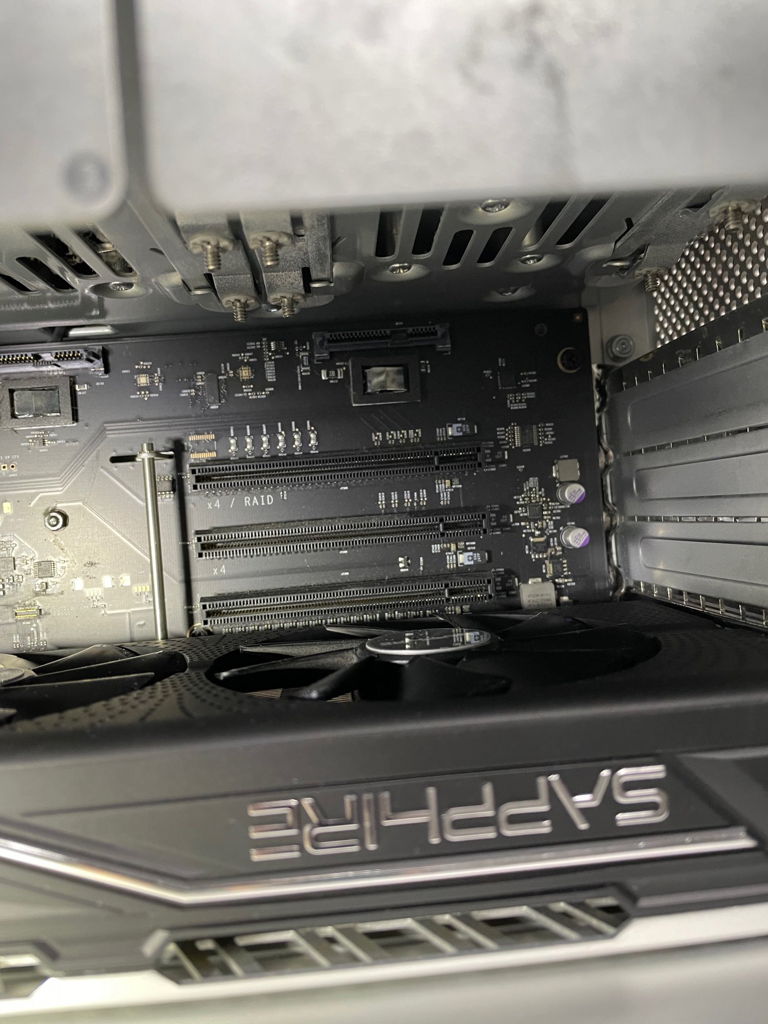

yes the RX580 is in slot 1 as you say and it has 2 fans on it! Theres always a pondery!
I'm guessing the presence of 2 fans means that it's a Sapphire Pulse RX 580 which is a 2 slot card, not 2.5 so that should work fine with a SSD7101A in slot 2. It will blow hot air directly on the back of the SSD7101A but that may not be a practical problem IRL. Double check that the RX 580 card you have provides clearance for slot 2 when you get a chance.
Ive had a quick look and there is clearance but not a lot.
Well it doesn't look too bad! there is some clearance between the two cards.
