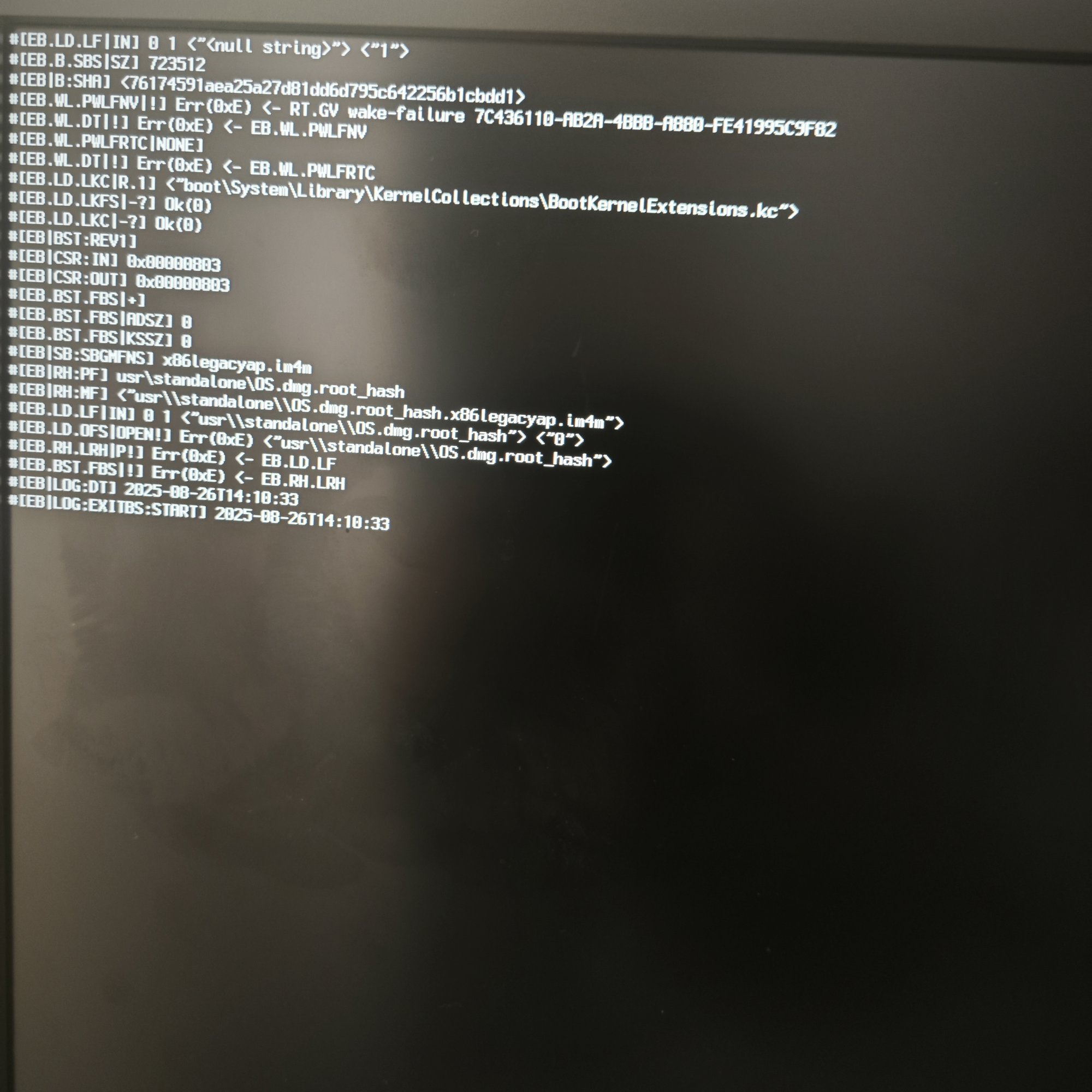

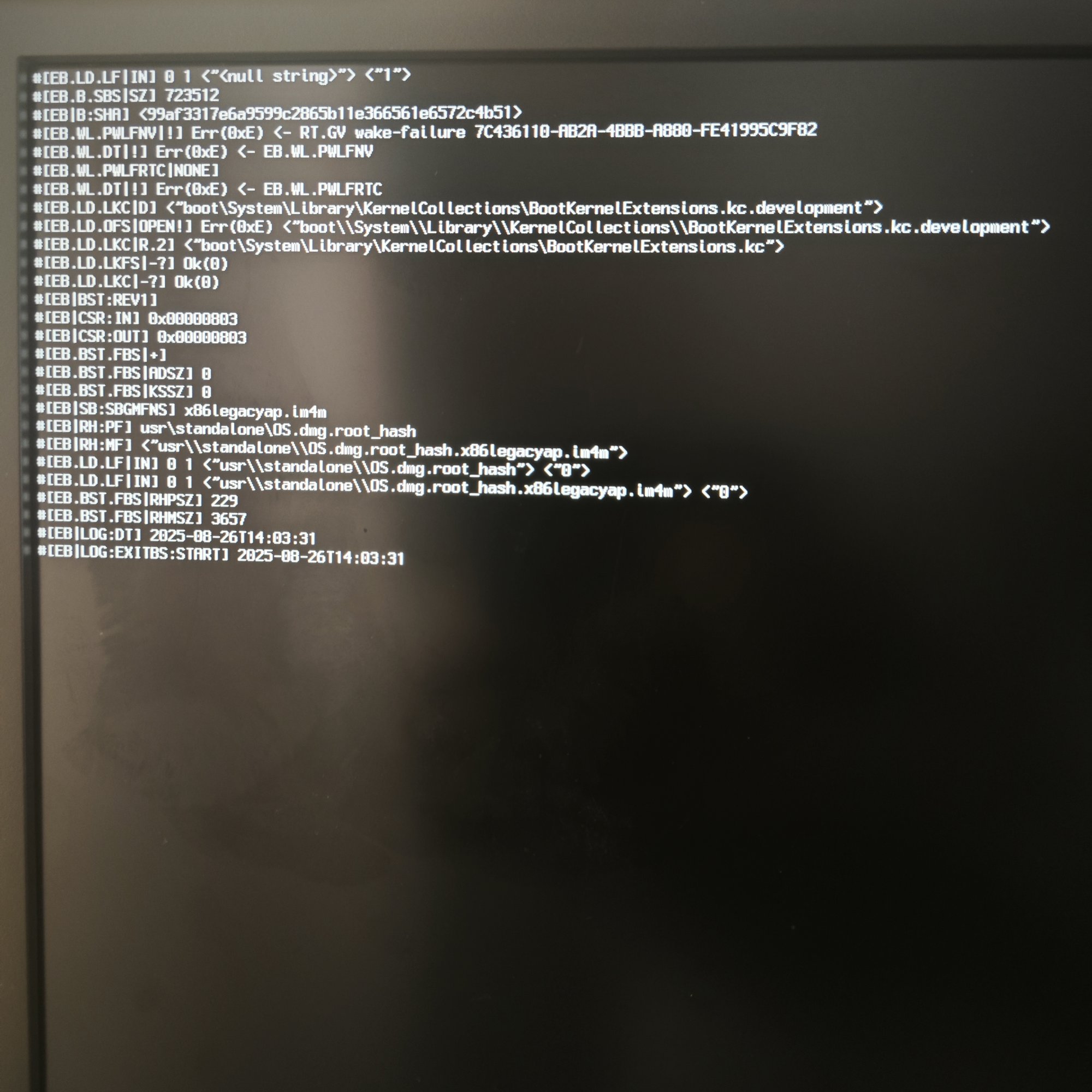

I have a mac pro 5.1, while I am waiting for another card to arrive and meanwhile I have the mcfiver laying around I was trying to install os X (I am on pcie slot 3 because slot 2 is tight fix I have a saphire rx 580 pulse and it blocks the fans, this is one of the reasons I don't want the mcfiver and the other is the exact problem for the boot within this thread). Anyway I was able to install OCLP Seqoia apply the patches and the build it to disk. However after OCLP boot menu on any options (even usb boot to reinstall) It does not bott it keeps on the apple logo forever, I was able to extract logs though. If I remove the mcfiver boot, shutdown, reseat the mcfiver and turn it on I can boot that once into Mac OS X 😐. Is this happening to anyone else and is it related to this issue or am I jsut doing something very wrong here? from the messages above we need to install OCLP EFI to every drive? I only have one nvme on my mcfiver but I do have a SATA III SSD on tray 3.
Thanks all in advance.
PS: The NVME I am using is a Samsung 960 Pro so should be compatible
... Anyway I was able to install OCLP Seqoia apply the patches and the build it to disk. However after OCLP boot menu on any options (even usb boot to reinstall) It does not boot it keeps on the apple logo forever, I was able to extract logs though. If I remove the mcfiver boot, shutdown, reseat the mcfiver and turn it on I can boot that once into Mac OS X 😐.
Your problem is the Abuantia 10G ethernet driver for the McFiver 10Ge port. See my post here for how to disable the 10Ge driver in OCLP, which allows boot again in Ventura through Sequoia.
Right below my post there, the1010 linked to a manual solution to get the McFiver 10Ge port working with the later macOS versions. I have not tested that solution yet, but it sounds good. Just like my solution, it will require manual OCLP driver adjustments every time OCLP is updated.
