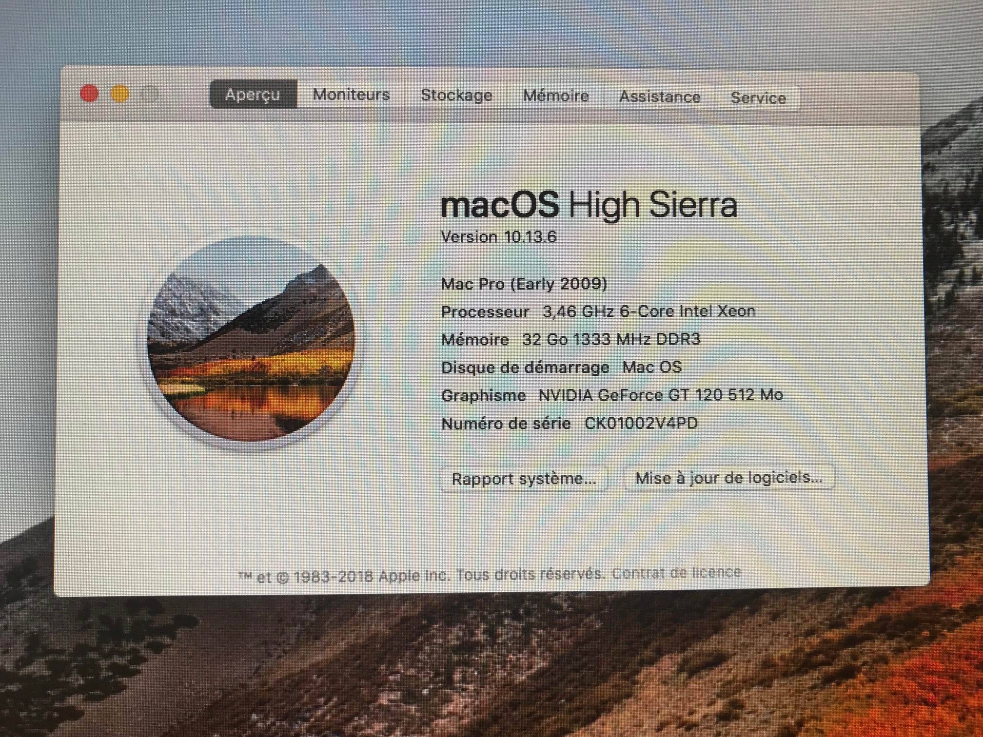

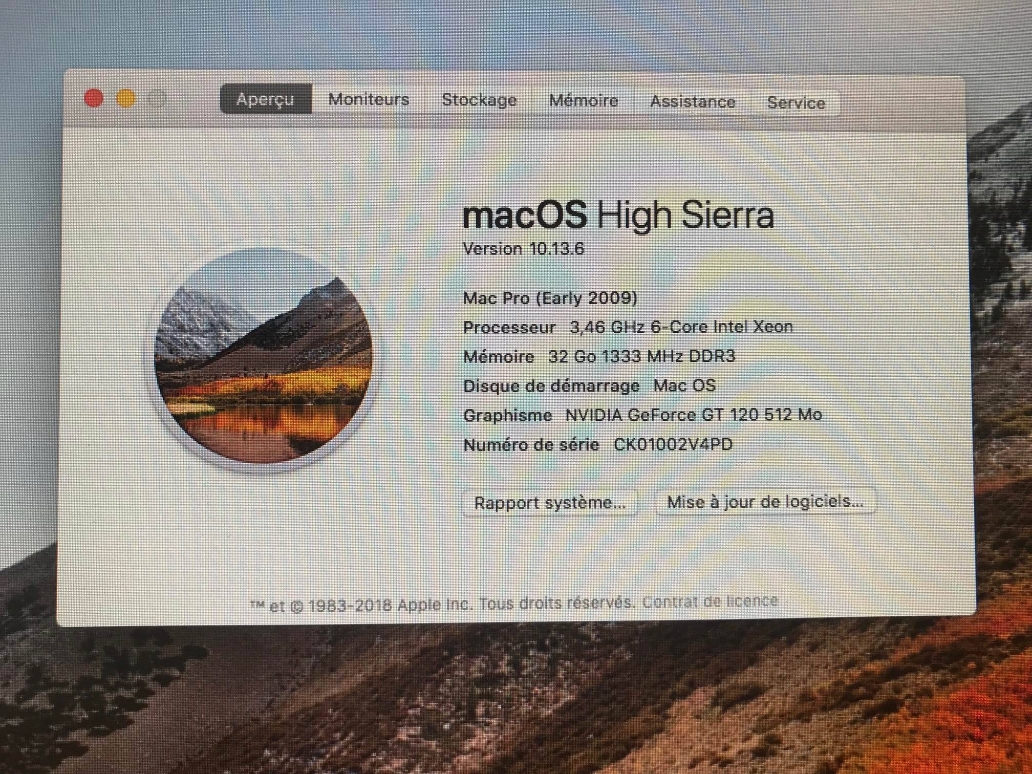

So, with regards to the 2nd option: I will ask more details about the CPU. I remember reading that it's a late 2009 model, but will come back to it. The guy says he's willing to lower the price to 600 with no graphics card and no USB 3 card. Which I am not so bothered about as I will update the card I figured already. As for the hard drives, I have 3 external LACIE drives that I am currently using, which is fine for now.
Unfortunately we don't have ebay here, so it's hard to compare unless I am looking at France or something. The end model I have a print screen of attached here. I've asked the seller the other questions too.

Edit: $750 down to $600 is definitely better. The GT120 video card is the stock card in the 2009 and it will not work in Mojave (and is weak and underpowered even in previous versions of macOS). They sell for about $50 US. USB 3 cards can be had for $20 US or so (you can also buy more expensive ones, but basic models are very cheap). I still say that $600 is too much for a single-CPU cMP though. It's entirely possible the new Mac Mini will only be $100 or so more than that--of course it will also have less RAM (and non-upgradeable RAM), so that will be a consideration too. But I still think it's worth waiting to see what Apple announces in the coming weeks.
