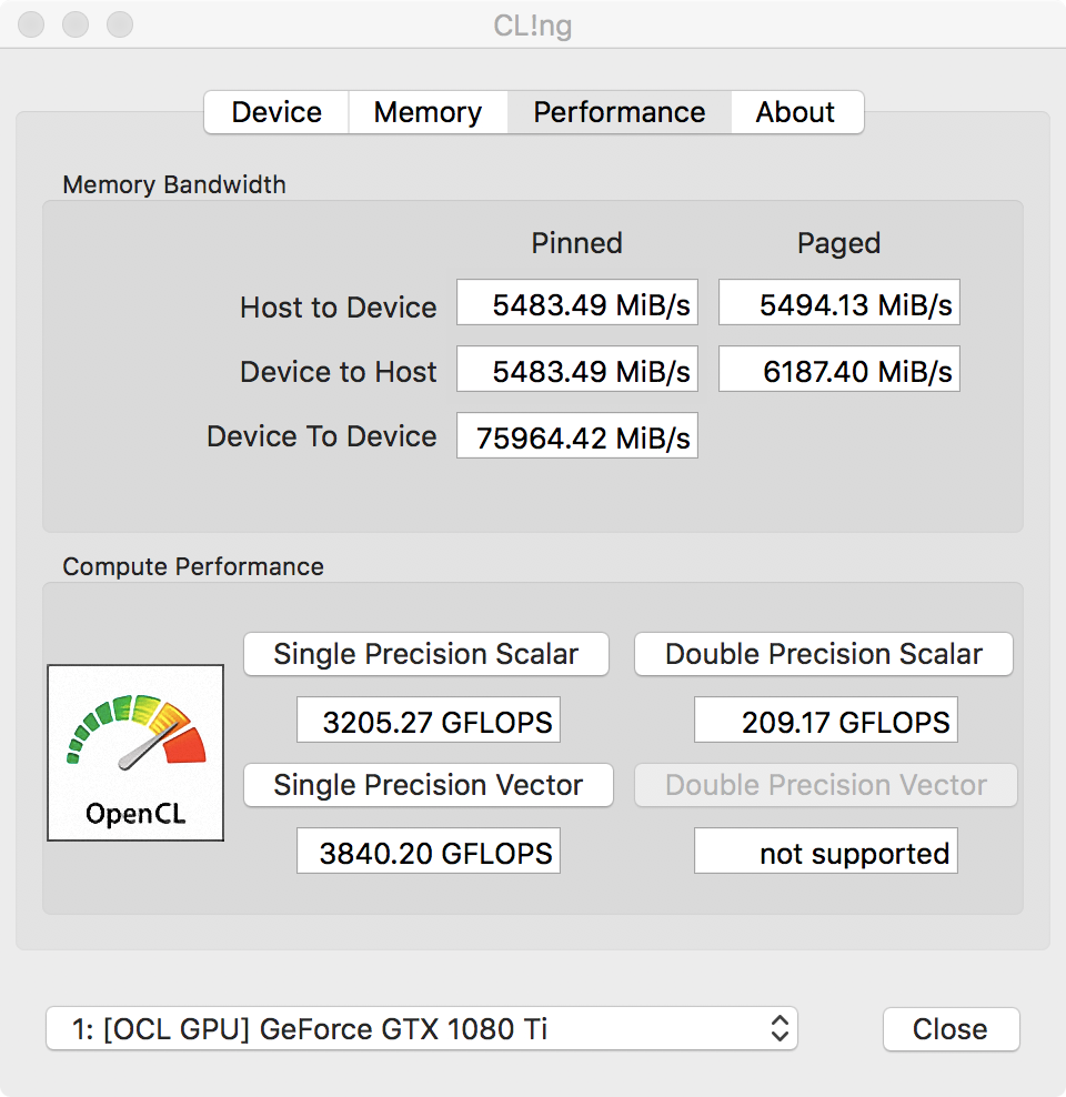

I have read on here that in Bootcamp that the Unflashed 1080ti will run at Pcie 1.0 speeds. But 2.0 speeds in macOS. I am hoping to to use the full 2.0 in bootcamp, is this true? or any solution to this other than flashing of the card?
If you are running the latest firmware I believe that all cards are able to run pcie 2.0 in bootcamp windows. Otherwise non flashed nvidia cards run at 1.0 in this instance, although the performance difference is negligible between the two.
Upgrade your cMP's firmware to 138.0.0.0.0 or later (the latest official one is 141.0.0.0.0 now).
This will fix the PCIe link speed issue. All PCIe cards will able to run at PCIe 2.0 speed in any OS.
Amazing, yes I am running 138.0.0.0.0.0. Still unsure how to upgrade to 14 with High Sierra as I will be needing to do this for nvme upgrade.
Just to clarify as this seems to good to be true. Even with a UNflashed GTX 1080ti? I have my finger on the buy button if this is true!
I got 2 GT-640's one with original bios and one UGA flashed. Both show 2.5GT/s in OSX in both x16 slots with 141 ROM.
Run CL!ng (free Appstore apps) to check the actual memory bandwidth. Nvidia GPU use dynamic link speed to save power. System report may not able to show you the correct max link speed.
