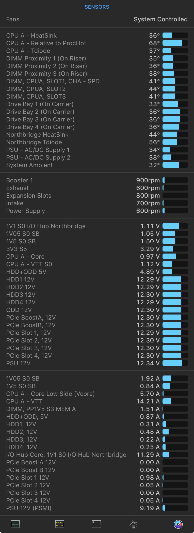

Idle temps:
CPU A Diode: 37
CPU A HeatSink: 35
CPU A core from PCECI: 38

You better ignore that PCECI temperature. High reading usually means nothing.
Focus on CPU diode, and CPU heatsink.
Your idle temperature looks very good to me. I don’t think it temperature issue.
Unless your W3690 CPU diode temperature can touch 90C. Otherwise, can’t quite because of CPU overheat.
If VM seems causing issue. Just stop using it for a day or two (but keep the cMP running 24/7). If no more KP, then 99% is VM software issue.

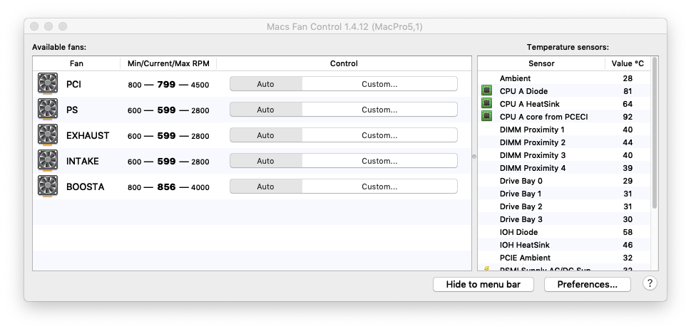

85C is normal. That's how the cMP programmed to do so, until the W3690 diode temperature goes above 80C, the fans will stay at idle. And just spin up tiny bit to keep the CPU at around 85C. In my experience, it can never touch 90C with native fan setting (assume the heatsink is reasonably clean).
Anyway, it so much easier for us to determine if the temperature is normal if you can post a screen capture. Something like this will help us to have a better picture about if the cooling is adequate.

Cool, I've been yes'sing the CPU for 10 minutes now and it looks like this...
Is it me or the temperature difference between the heatsink is too much to the cores?

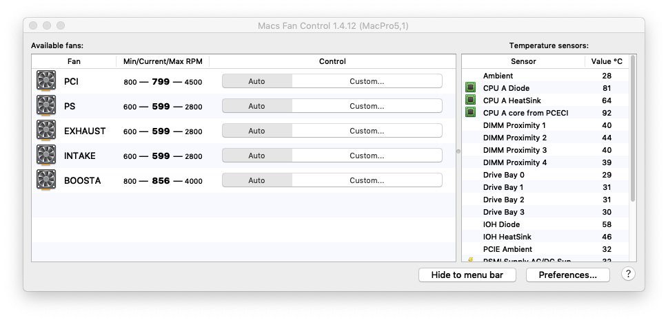

20 minutes later...
