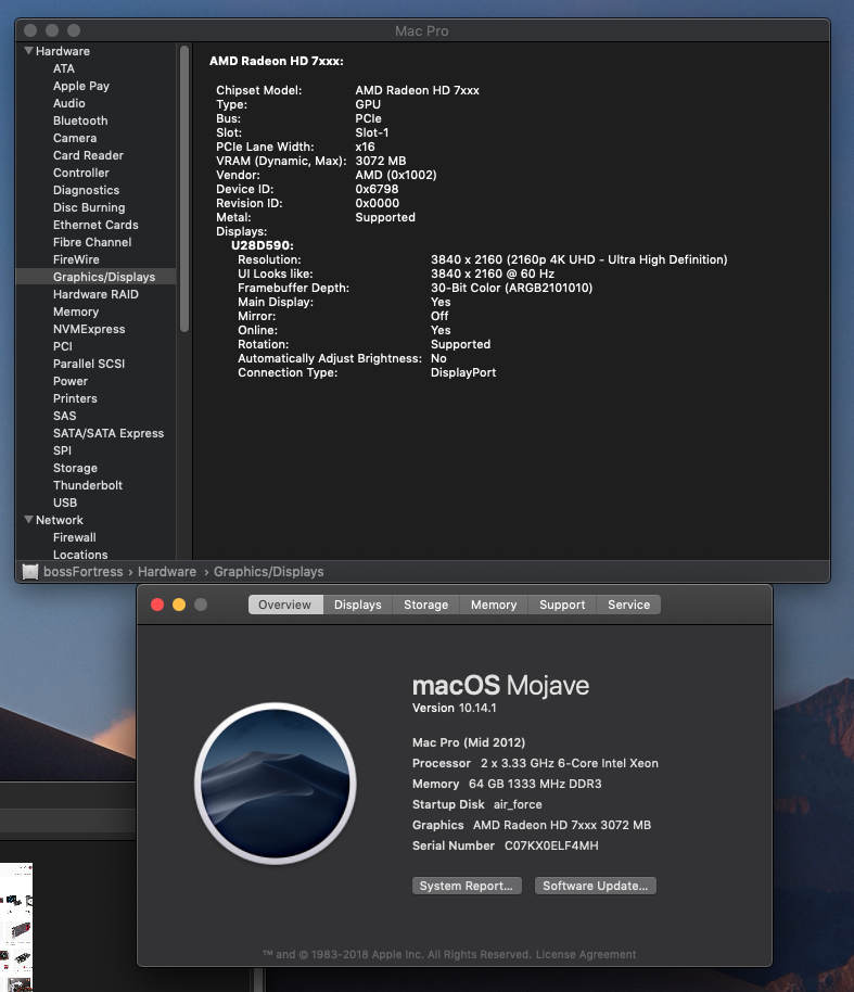

However, I have had problems with a Samsung U28d590 4K monitor connected to that card via displayport. Regardless of the screen resolution selected, the monitor goes black for a second or two.

Switched to hdmi cable, plugged into the hdmi1 port on the samsung U28d590. Had to hassle with the process for getting the monitor to switch from displayport to hdmi. The hassle is caused by the fact that once the monitor is connected to displayport, the button for bringing up the monitor's menu stops working. That problem is documented elsewhere. Carefully following the instructions, I found the magic key to getting the monitor to switch to hdmi. I have read in a few places this will eliminate the blacking out problem, at the price of reducing the frame rate from 60 fps to 30 fps. I didn't think I would notice the difference in frame rate, but that turns out to have been incorrect. Still, the slower frame rate beats the black outs.
It looks like the cost to fix this problem is a different 4k monitor. This one was way cheaper than any other I could find, and I would have to say the performance of this monitor is not great. It is 4k, which is nice, but it is noticeably less responsive, even for typing as I am now.
Also, the image is not as crisp with the hdmi connection as it was with the displayport.
Another surprising result: System preferences for displays is set to 30 frames per second. Running Cinebench Open GL test, it scores 49 fps.
