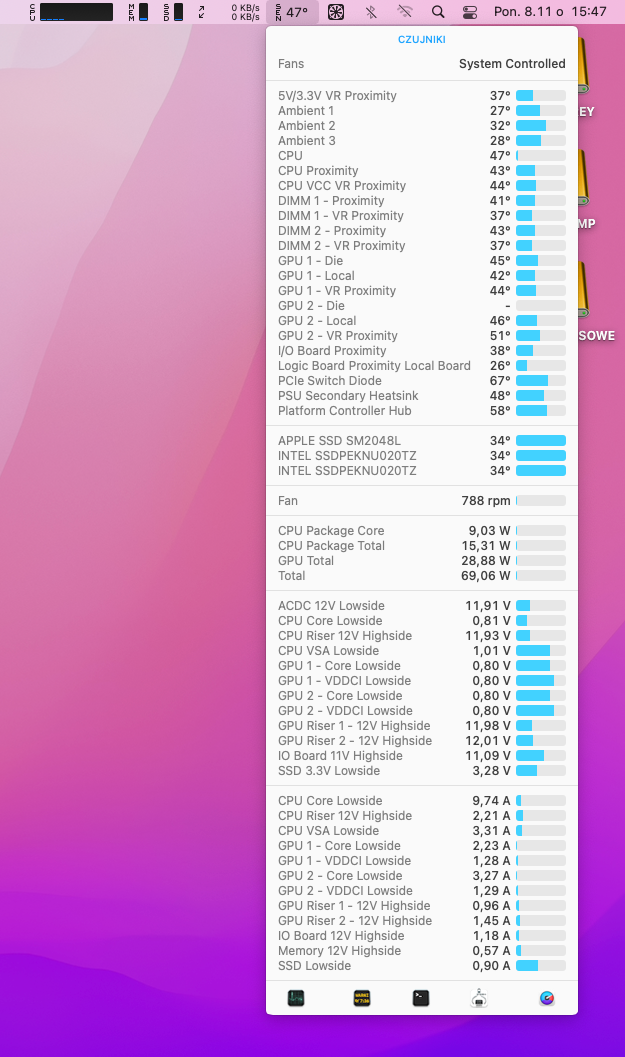

Looks like second GPU 2 - Die sensor is gone
Seems both GPU's are working well under Windows - FurMark showed Crossfire working and both gets proper temperature readings.
I've removed one GPU (the one with SSD slot), then reinserted it. GPU2 die sensor reappeared. LuxMark shows both GPU's core clock 850 MHz (previously first GPU showed just 150 MHz). Fan is now working properly. Apple diagnostic shows no issues at all.
