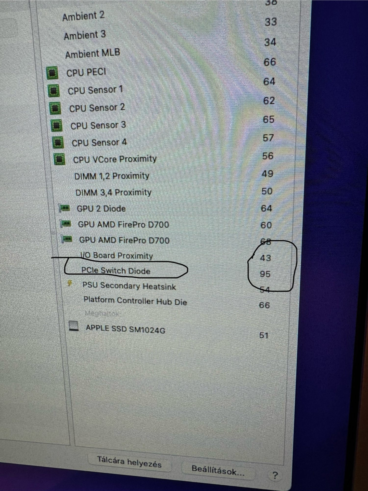

Unfortunately, the Pcie Switch diode on my MP 6.1 is too hot (95C) during operation. There is no error anyway….. Is this normal? Thanks!

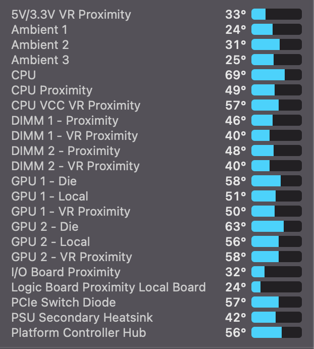

Mine is 58ºC and I don't think I have seen it above 70ºC so you should look at Activity Monitor for an errant process. Your SSD temps look rather high as well.
Hi, This is nMP, not cMP. Mac Pro 6.1. All temperatures are normal, only this one diode is hot. Yes, it was cleaned.
While mine never exceeds 70°C since I placed it on a shelf and set a slightly more aggressive fan curve, I remember other reports of up to 85°C.

Yes, 2x Cinema Display 30", There is nothing else. It's a constant 23C in my office......
It is interesting that the fan does not turn on by itself and there are no problems even during the benchmark test.

I would say 70 °C is normal on my 6,1 and 95 °C looks a bit too high, I would say.
Is dust inside? What CPU is in your 6,1? I'm not sure, but I remember that trashcans with lower CPU cores having a hotter PCIe Switch.
Disconnect one of the Displays and check temperature again.
You can also use the Thermal Test from the ASD 3S159 (Apple Service Diagnostic) found on https://www.macintoshrepository.org/
12-Core 6,1: Temperature of the Switch Diode ~60 °C

With a dust-free, disconnected display, it is 1-2 degrees cooler. I'll run Test when I get home. Thank you!

It is likely that the second Apple Cinema Display 30" is causing the heat. With one display, the temperature only goes up to 80 degrees. Is this possible?
