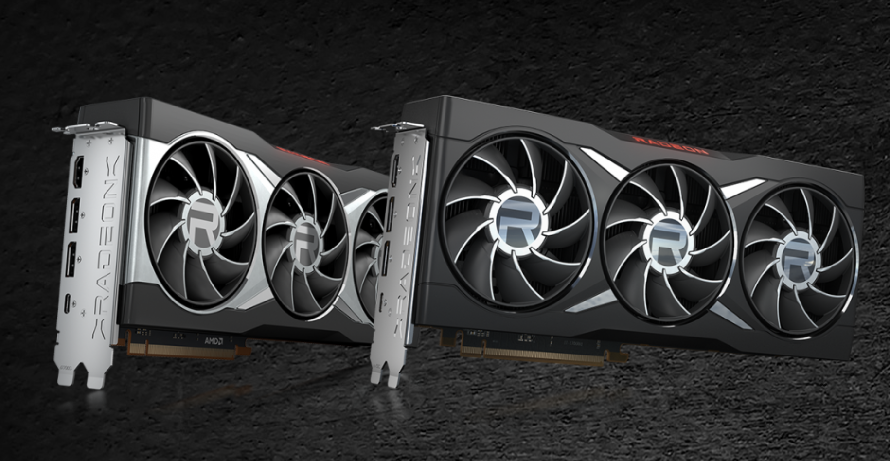

Ya know, there is another option. A few of the third party cards have a USB-C output. One off those cards is the Reference AMD Card.
Apple says those USB-C ports might not have full functionality on the 6000 series cards. I'm not sure why that would be if AMD follows the XHCI spec like they did with their 5000 series cards.
https://support.apple.com/en-ca/HT208544
So if you want USB functionality from the XDR, then you might have to use USB-C of 5000 series card or go with the Belkin Charge and Sync cable or similar method.
Reactions: Canubis
^^^^Before my Gigabyte RX6800XT I had an AMD Reference RX6800 and used the USB-C output with a quality USB-C cable and it worked just fine. It did not work with a TB cable.
And, again, you can use the BiDirectional cable I linked above. I am using the cable right now with my RX6800XT.
Apple said it was a wake from sleep problem, so maybe everything else about the USB-C port is fine. Makes sense it wouldn't work with a TB cable but it should work with USB-C cables (that support 10 Gbps USB) and Thunderbolt 4 cables (which are supposed to support everything).
Bidirectional cable will work but you'll be missing the USB features of the display (presets, brightness control, USB ports).
