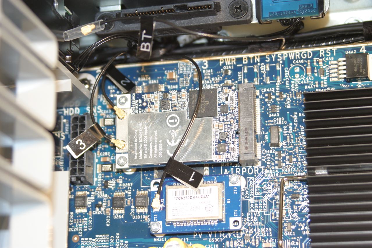

Thanks for the answers!
I opened the case and I shot a foto (see attachment).
It seems to me that my cables are also not correctly installed.
Furthermore it seems that to fix this by myself is not so easy. Is there a detailed tutorial on the net how to change the wires? (I've some experiences with hardware and stuff, but I'm definitely not an expert)
Honestly it is easy to do, no tools are needed at all. The wires have small brass/gold connectors on the end which simply pop on and off the cards.
You have to apply a fair bit of force to pop the connectors back on. You simply have to make sure the conenctor is located right over the middle of the port on the card before you start to apply pressure.
However, from your photo I do not see wire #2?

Wire #2 was a little bit hidden, but I found it. Now I removed the #1 from the Airport card. I attachted #2 to this upper connector.
Afterwards I also removed the "BT" wire from the Bluetooth module and pluged #1 into the free connector.
Now I've #2 (upper), #3 (lower) for Airport. #1 in BT and "BT"-wire is un-attatched.
I do some testings, then I'll post my results here.

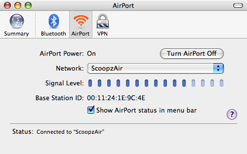

I tried swithcing the wires around with abosolutely NO EFFECT (well a slight anomaly but nothing major).
Before i was getting 100% signal (see 1st thumbnail)
Then after swapping 2 and 3 i got 75% signal (see 2nd thumbnail)
I then swapped back to original config and still only get 75%.
With no wires connected there was no signal as expected (see 3rd tmb)
So I think my first 100% was some kind of false reading. The base and macpro are only 2 or so meters apart but a few desks etc in the way and I've never seen 100% even with my old G4Cube. For those wanting to know, i have:
0 send errors
0 receive errors
after half a day.
