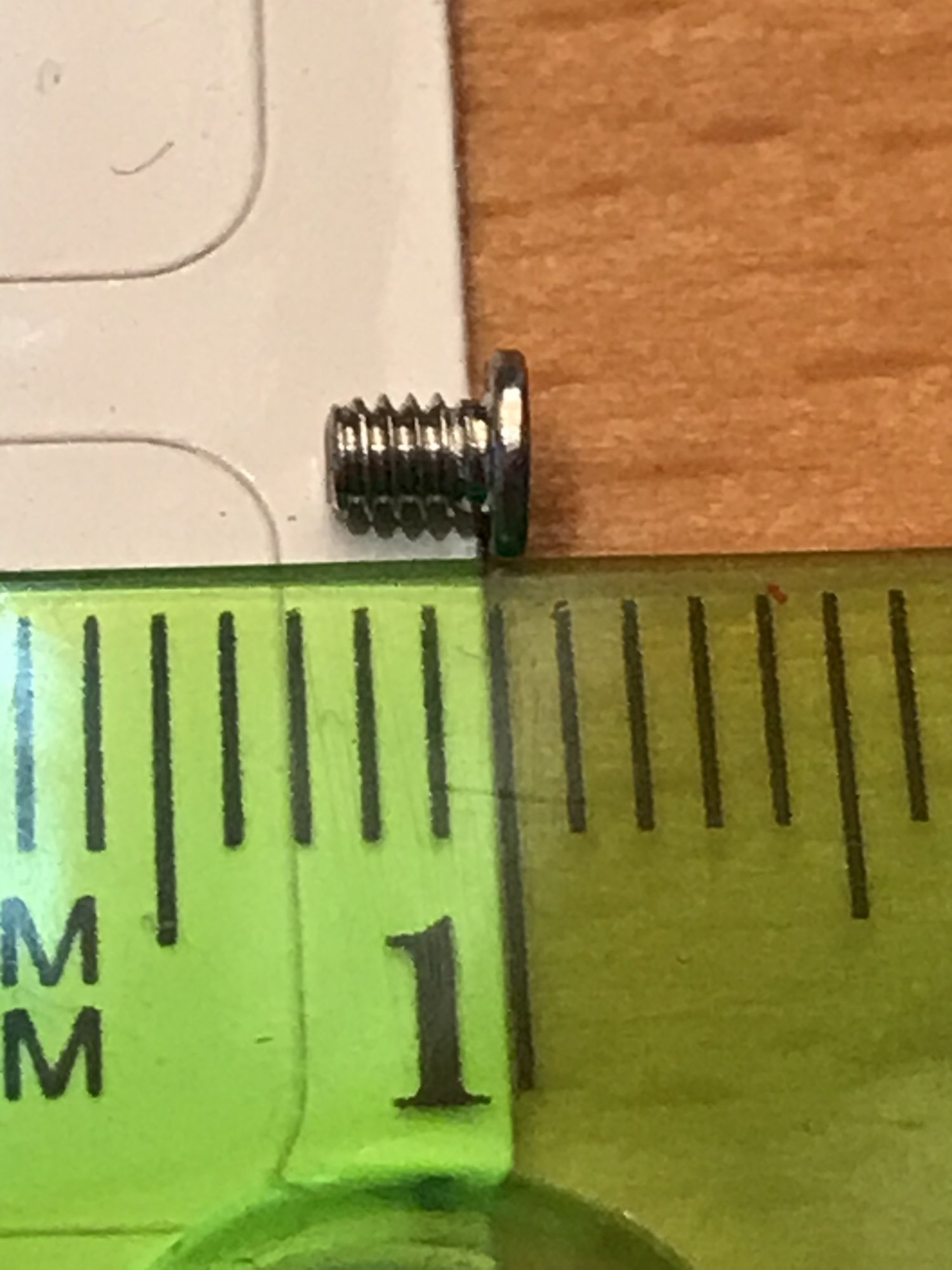

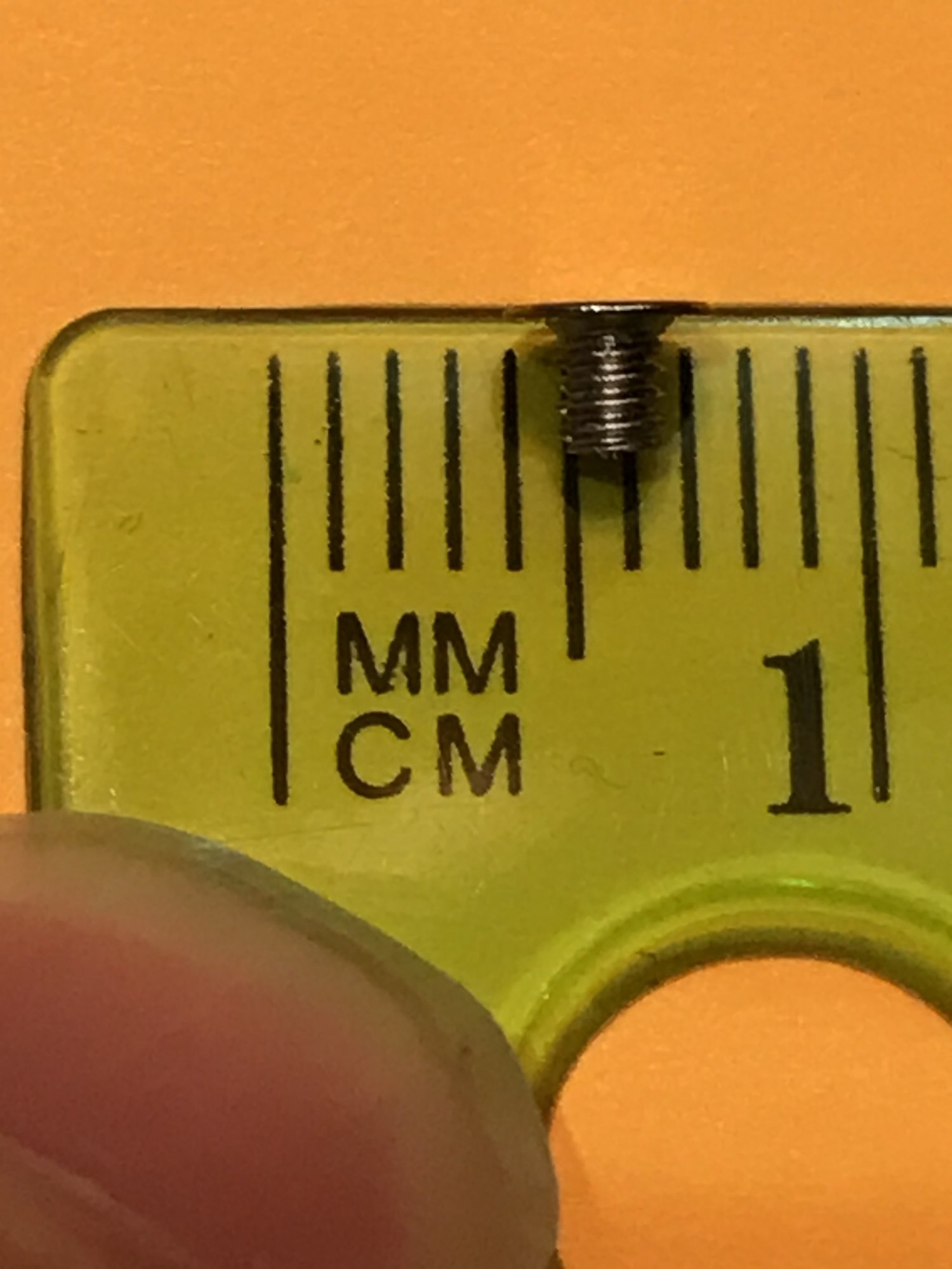

2) What size is the screw? I read somewhere it was M2 x 3mm, but I think that's wrong. Somewhere else it said a T6 screw would fit, and that has a diameter of 1.7 mm I believe. I also tried these MacBook screws and they fit in terms of the thread, although they seem too short (although I haven't gotten the BT and WiFi boards in hand to try yet). What is the size of the screw below, M1.6 x 2 mm? If so, perhaps 1.6-1.7 mm and 3 mm long is the right size.
Judging again by the pictures, the screws appear to be M1.6 x 2.5 mm. Because the Bluetooth module's circuit board is so thin, I tried these screws and they worked fine. It doesn't seem like they have a huge amount of thread in the nut, but it's secure.
I haven't received the WiFi module yet so I can't comment on that yet. I don't know if its board is significantly thicker or not.
Those M1.6 x 2.5 mm screws worked for the WiFi module too. The seller had sent one of these, as well as a M1.6 x 6 mm. The latter was way too long.
These are screws that are used in some MacBooks/MacBook Pros.
