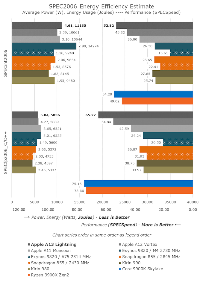

Apple’s basic recipe for performance (or at least, part of it) seems to be going really wide. Their designs are ridiculously superscalar, with estimated 13 execution ports (compare this to 8 ports on Skylake and 10 on ice lake) and tons of cache to feed them all. If they can scale the frequency of their CPUs, they will probably outperform Intel and AMD by 10-25% in single threaded applications.

A12Z GPU already outperforms Intel Iris by a healthy margin - even in the iPad form factor. If it scales - an 16-core GPU based on this core could be competitive with high-mid-range offerings from Nvidia or AMD.
There are two things that make Apple GPUs stand out. First, they are tile based deferred renderers (which means less wasted work overall). Second, they seem to be very good at asynchronous work. And these two things feed each other. Apple already have a clear performance per watt advantage over the immediate renderers style GPUs from Nvidia. The question is whether they can scale.

Apple is already king of performance per watt. The A13 (and the A12X/Z) is desktop class in performance.
Apple Silicon will be much faster having shed the restriction of low thermal design power and form factor limitations.
