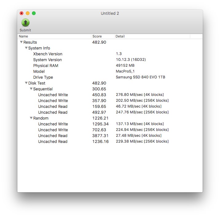

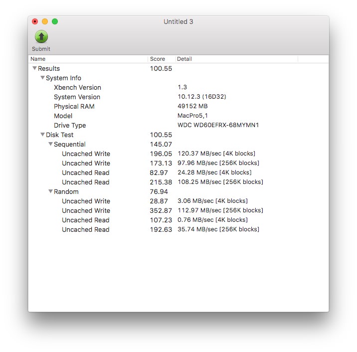

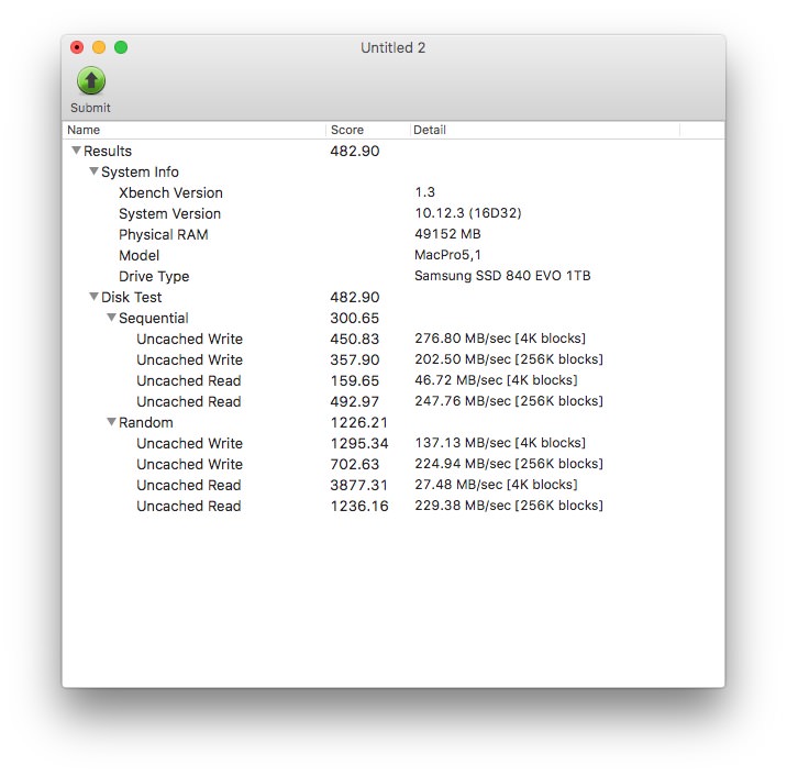

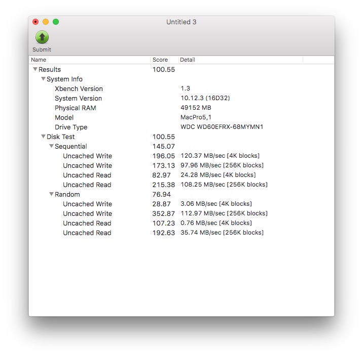

AJA doesn't measure that. You can go for Xbench, which is free.
http://xbench.com
This benchmarking software is not very up to date, so, don't use it for other test, but disk test actually gives you more details than most other disk benchmarking software.
You will see both sequential and random speed, and if you compare the SSD to your HDD RAID array, you will see the SSD is much faster on the random read (4K) section. You will realise this number is way lower than the Sequential read (256K speed (the manufacture marketing speed). And this is the real reason why HDD is slow on running OS and RAID 0 won't help (because OS is not a single huge file but thousands of small files).
Anyway, some example for you. (My 5,1 is working 100% on encoding, however, not much R/W on both the 840Evo and WD HDD. So, the performance figure there should be reasonably accurate. However, the RAM disk performance may be affected a lot).
A WD Red 6T HDD's 4k random read speed is ~1MB/s
A 840 Evo SSD connected to a SATA II port. ~30MB/s (lots of consumer SSD at this range), and it's ~30x faster than HDD . (This is also the reason why SATA III won't shorten the boot time. The SSD simply cannot saturate the SATA II bandwidth when loading small files. e.g. during boot)
A RAM disk (for fun), but I guess this is similar to what the PCIe SSD can do
If anyone has other SATA SSD, PCIe SSD, HDD RAID, SSD RAID, please post some benchmark here, so that OP can know more about on their performance. And decide which one fit his need.

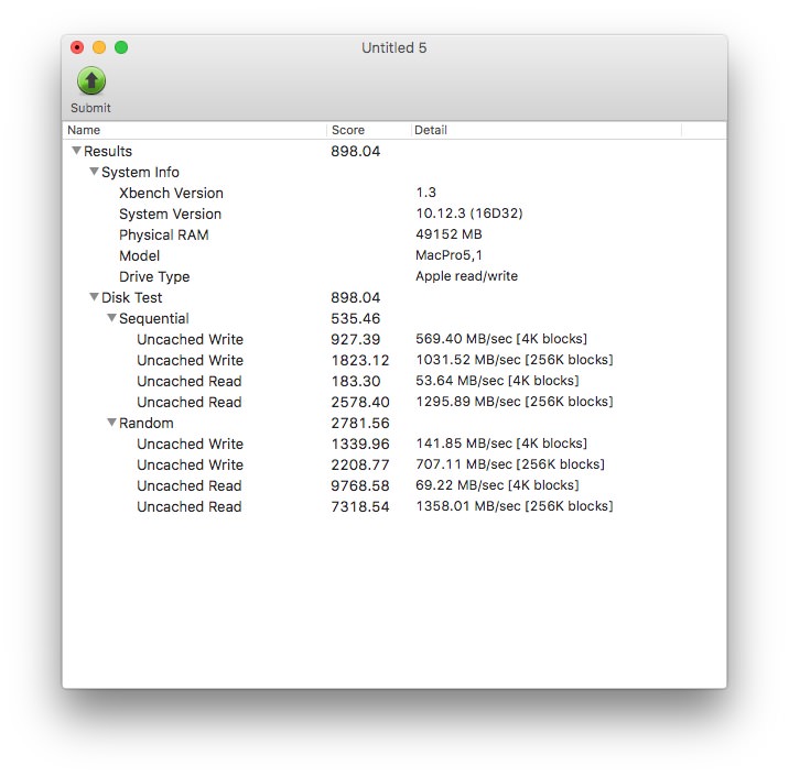

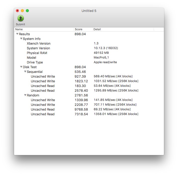

Thanks a lot! Will try that bench.
I'm surprised by the RAM disk test though.
I mean, RAM has basically same access time to any address (hence the "Random" in RAM), thus I would have expected that Random and Sequential to be similar (DDR can have banking issues depending on how the DDR banks are enabled for access).
Also, Uncached Writing is faster than Uncached Reading?
Looks like there must be some cache, if anything thru the CPU L3/L2 cache, right?

I don't know the technical details, but I guess writing is easier than reading, because the controller can write on any empty space, for reading, must go to the specific address. So it may require more time to locate the data, which eventually reduce the reading performance.
The RAM disk performance is not accurate anyway (because my cMP is now working hard), however, my guess would be the latency is not necessary from the RAM itself, but something like from the OS (e.g. I/O request). The RAM now work as SSD, so, it's under control of the file system, and the file system's latency will also affect the RAM disk performance. May be someone can give you better answer, I am a totally outsider in this area.
