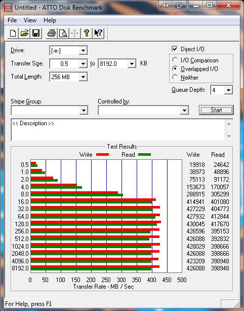

Anyways... I got the drives setup well enough that I can do some serious testing on configuration.
RAID5 at the moment. Theoretically I've maxed out these drives (at certain points) based on the speeds I'm getting. Not sure what else to test, I'm probably better off getting back to work.
Well, most of it's hovering around 400MB/s for both read and write. Quite nice actually for a 4 member set (assuming SATA drives). 😀
If they're 15k rpm SAS units, not so much. 😛
These are 1GB Seagate ES.2 7200 rpm (pseudo enterprise) drives.
This is at 64K block size. Because I work with files from 5GB to 20GB, do you think there is a benefit to trying larger block sizes?
Actually, with files that large, you might (big files benefit from sequential access, and larger stripes help this). Worth testing it IMO.

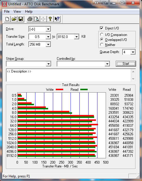

Worth testing indeed. I netted 25MB/s more on writes, and 30MB/s on reads. That's a substantial increase for a simple (but time consuming to rebuild) tweak. This is the same setup with 256K.
In your usage pattern, the larger stripe size makes sense (gives a nice return in throughputs), as the entire array contains large files. It's when you get mixed sizes, that testing is truly needed to find the "sweet spot" for the usage (what's accesed more; the smaller or larger files). 😉
