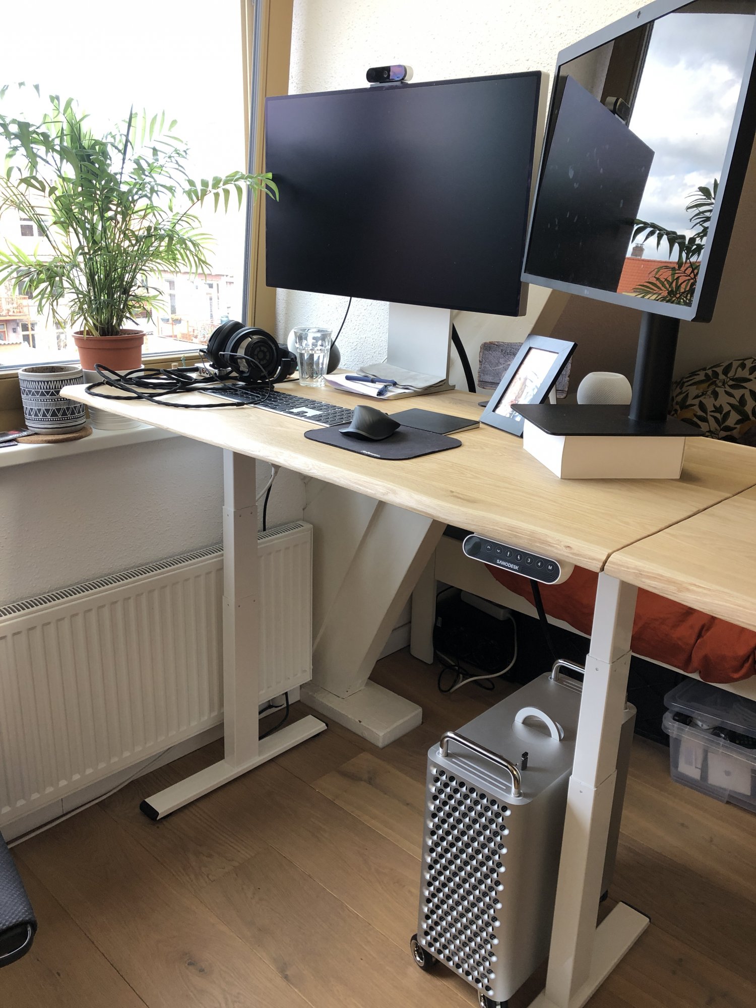

Hey,
I'm considering getting a movable desk that can move up to be used as a standing desk and was wondering how to mount the mac pro underneath - since the stupid thunterbolt cables only for the XDR exist only in 2 meter or at horrendous prices like 350€ each in 5 meters, which seems like an INSANE investment to me.
I'm not sure if I'm cool with hanging the mac pro at 19kg underneath a wooden desk though.
There's absolutely no way to extend the TB cables, right? Putting the mac on the desk is also not an option, for optical reasons in this particular room setup.
Any ideas?
A standard height for a table/desk is ~70-85cm.
A standing desk heigher than ~ 110cm will be very uncomfortable, supposing you like to use a keyboard placed on it.
So the difference in height is less than 40 cm ; I imagine this will be no problem at all with a TB cable of 2 meters...

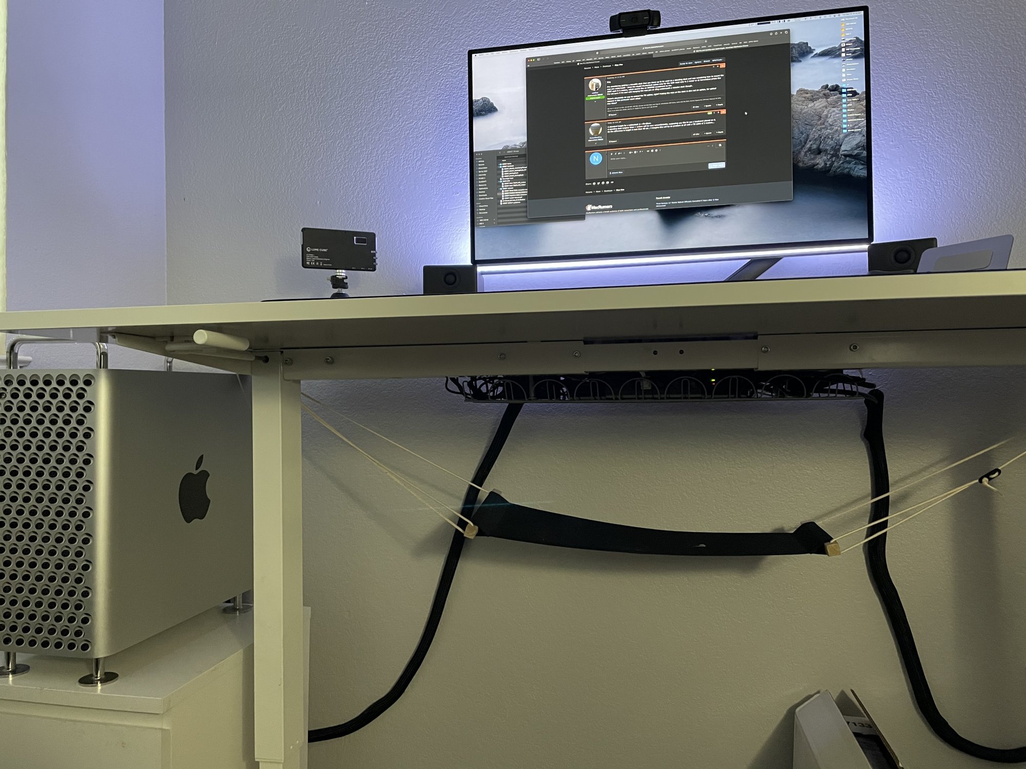

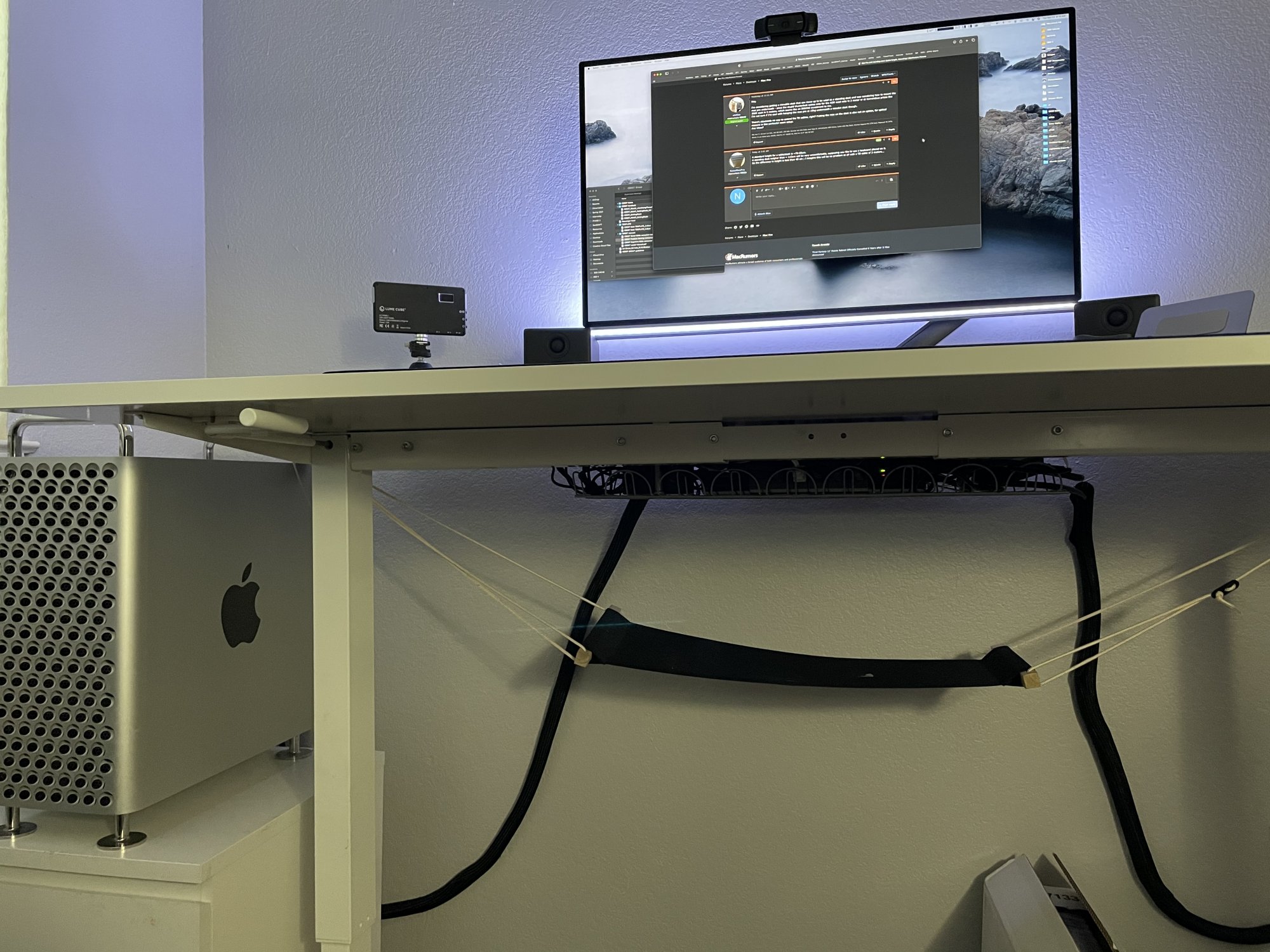

This is how I have mine set up right now. The Mac Pro is sitting on top of an IKEA dresser (21.25" height). My desk is set at 42.25". I had a cal digit ts3+ from my previous set up, so I use that to run all cables through the hub. Mounting the MP underneath the desk would be for a nice set up, but I think you'd have to find a desk and mounting brackets that can handle the weight. If you open up your case often I wouldn't mount it underneath.

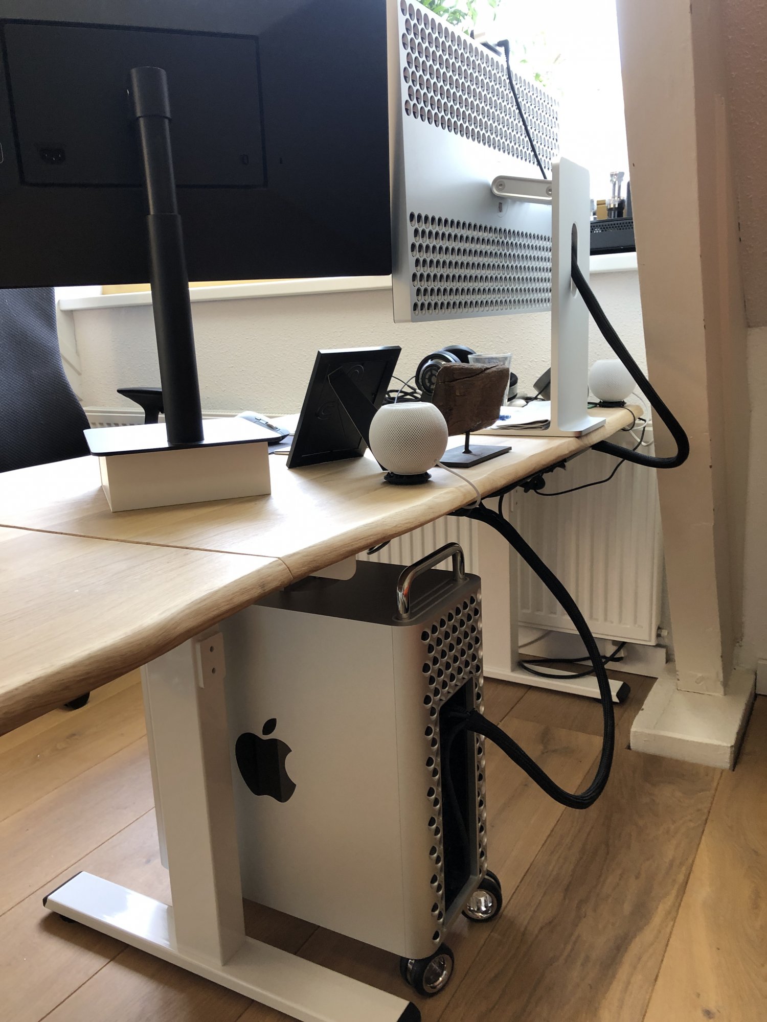

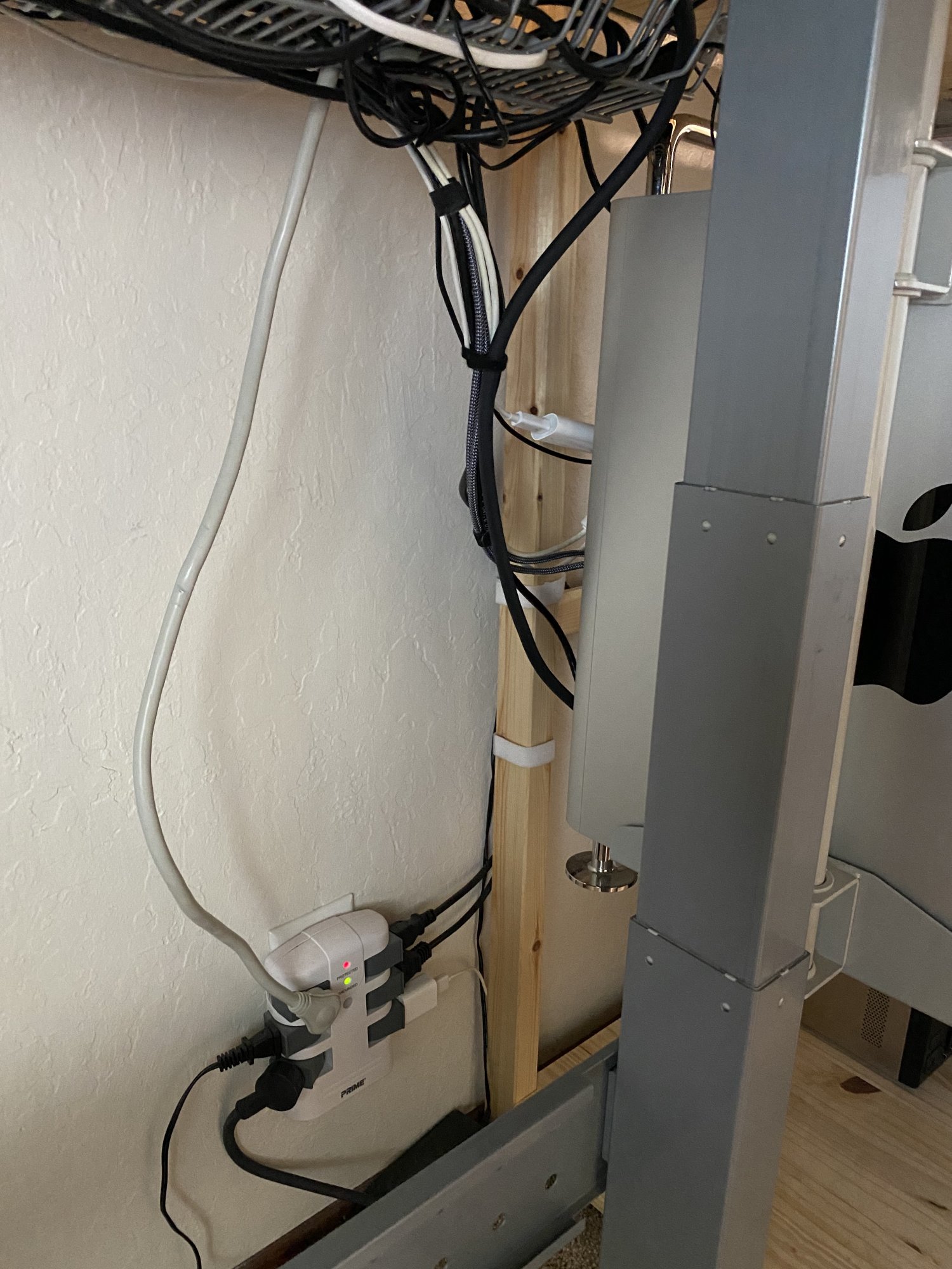

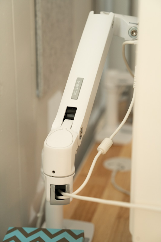

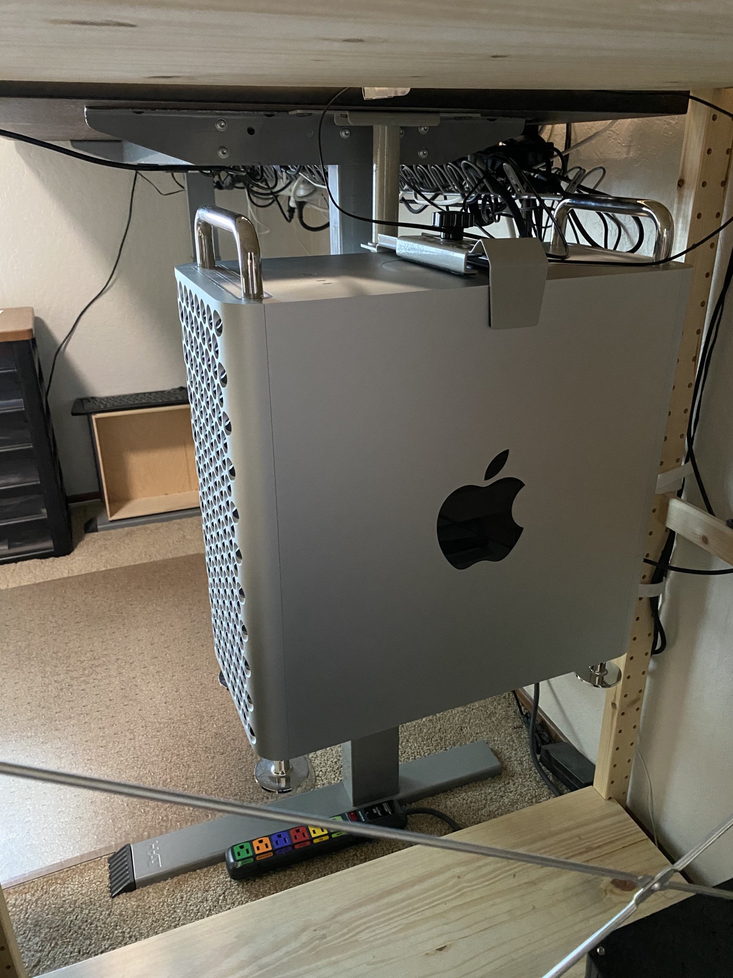

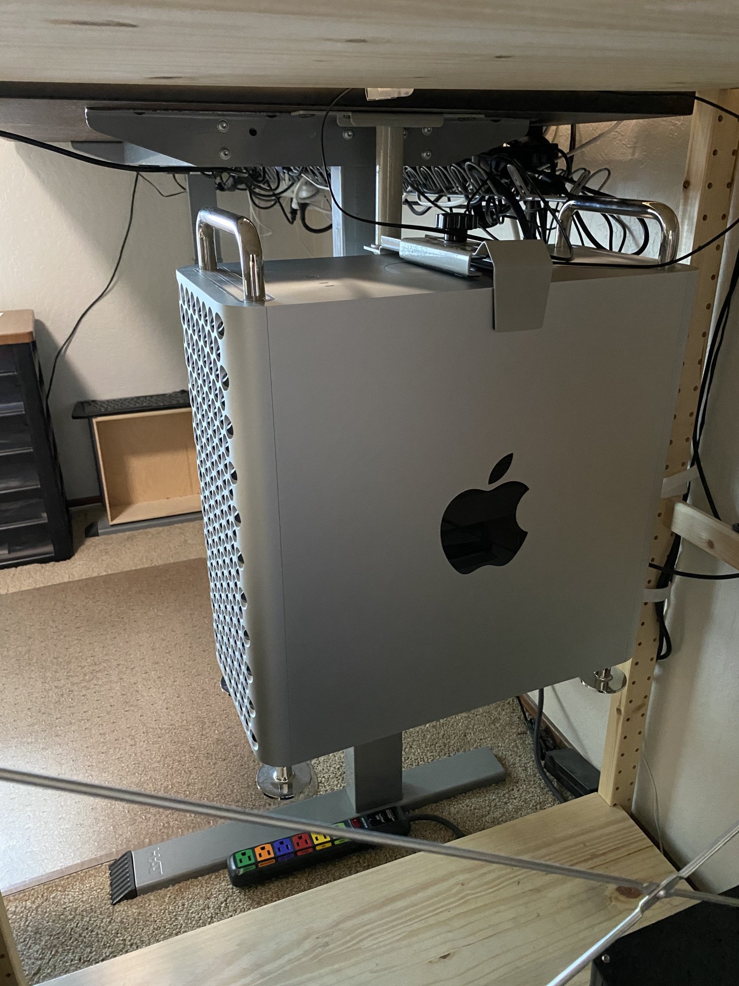

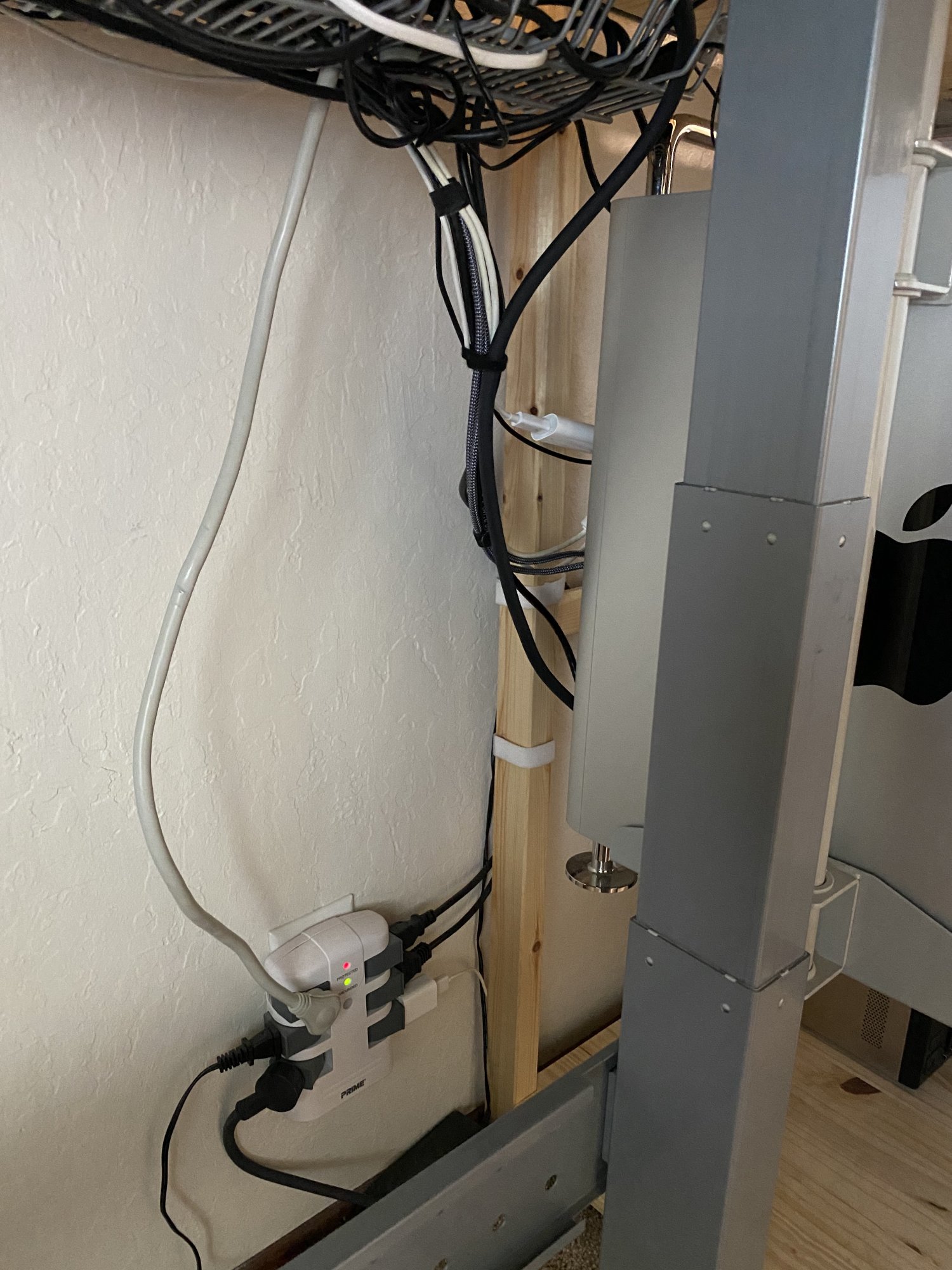

I attached my MP to my desk for this very reason. It shortens the length of the cables and I can still raise and lower my desk.
Reactions: OkiRun
Hey, looks great - what mount is that? I ordered the Corning 5 meter cable and it also doesn't work at 6k but only at 5k. WHY? Nobody knows, I spoke with my senior representative from Apple and he also just could tell me that he doesn't understand and some form of voodoo must be going on with the original cable+XDR so that it's NOT POSSIBLE to make a longer cable. So messed up.
I'm even tempted to accept the 5k resolution but not at that price. Your mount looks like a great solution though, hope I can order it here...
Hey, looks great - what mount is that? Your mount looks like a great solution though, hope I can order it here...
Its made by Eureka Ergonomic and comes in black or grey. I bought this one because of the small mount footprint. All of the mounts I found wouldn't fit where I mount it. I bought mine from Amazon in case it didn't work out, I could easily return it.
I added round rubber bumpers on the top and bottom holder brackets so that they didn't markup the MP case.
Reactions: chfilm

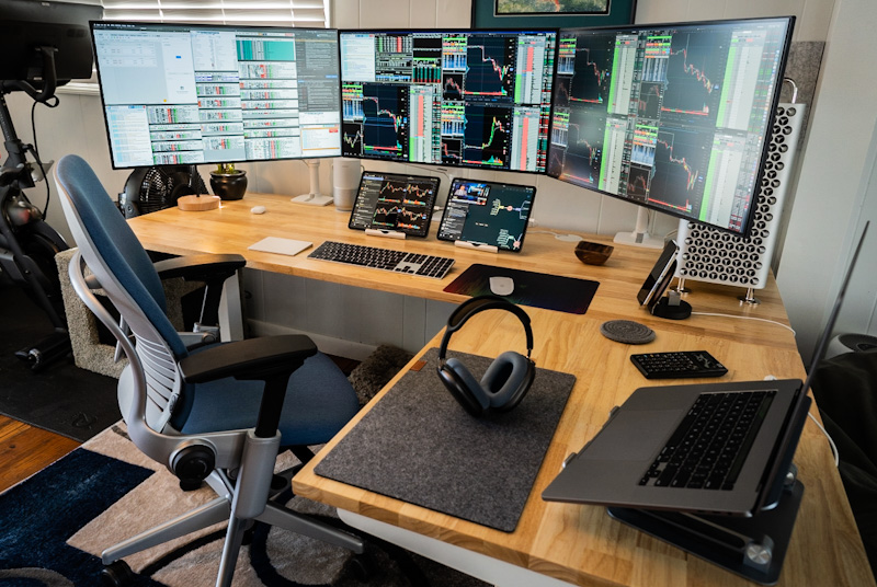

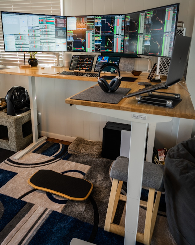

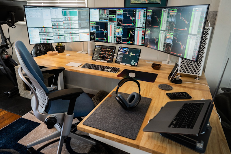

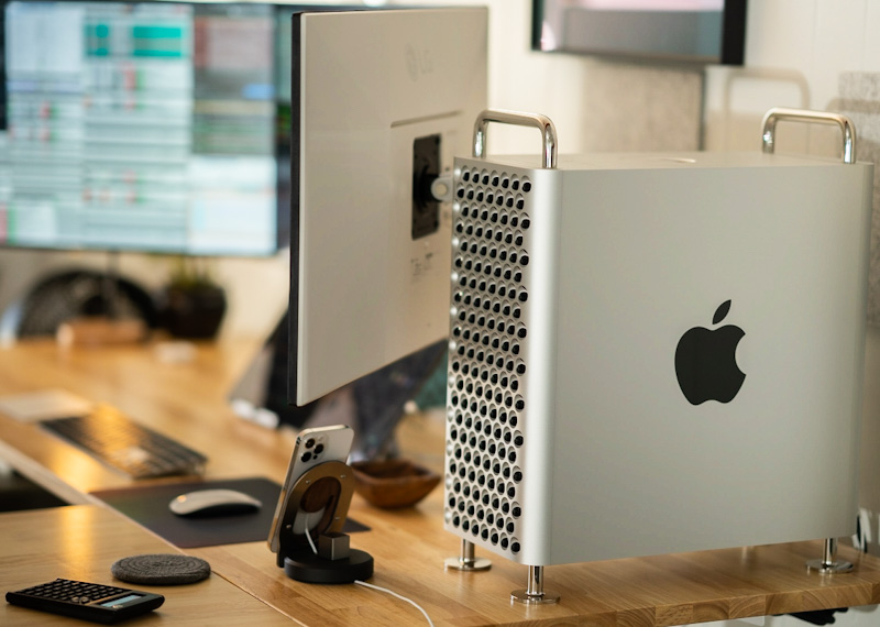

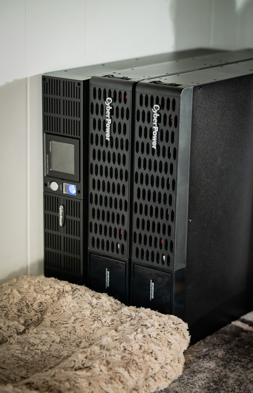

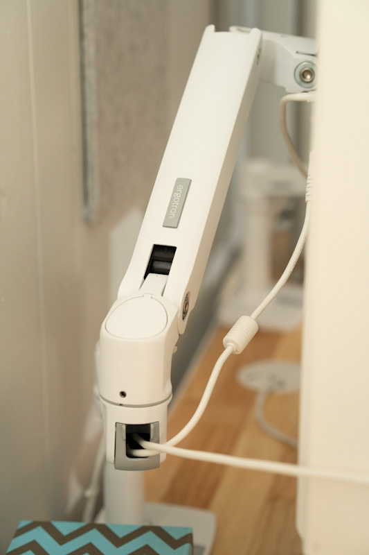

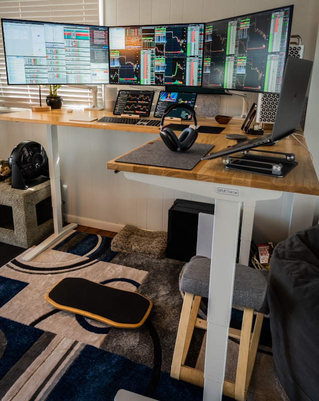

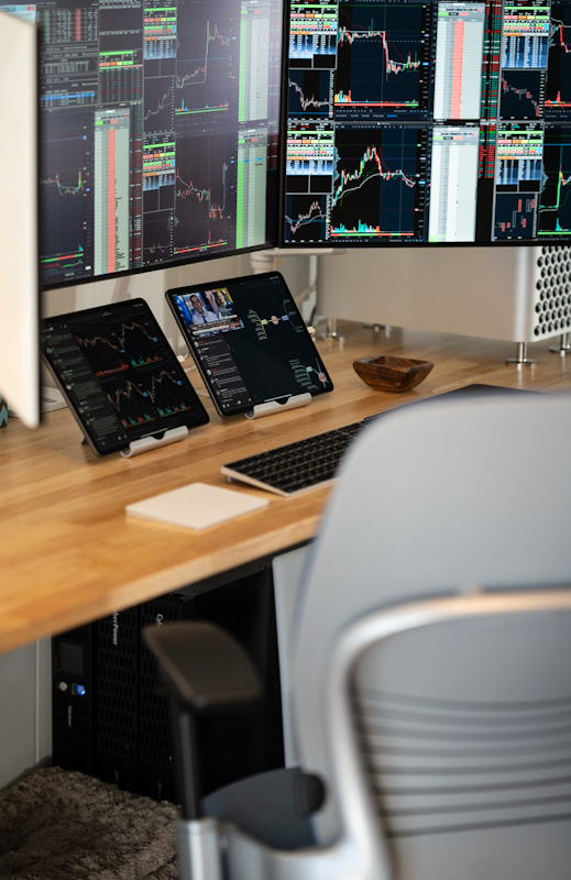

I keep mine on the desk. LG 4K thunderbolt displays...they do support daisy chaining, although I have each one hooked up direct. I did have to get one 3 meter 20Gbit thunderbolt cable to stretch to the leftmost monitor and still be able to hide the cord. The main desk is 80” x 30”, with a 42” x 24” return.
Duuuuude what a setup! Seems those cryptos/stocks you’re trading are paying off haha!
Lol. Thanks.
The standing desk setup totally worth it. My back was killing me before. Has been about 6 weeks and back pain totally gone. I'm standing about 2/3 of the time now, a lot more than I would have thought. I really love the rocker board, gives a pretty insane core workout when you are on it for a few hours.
