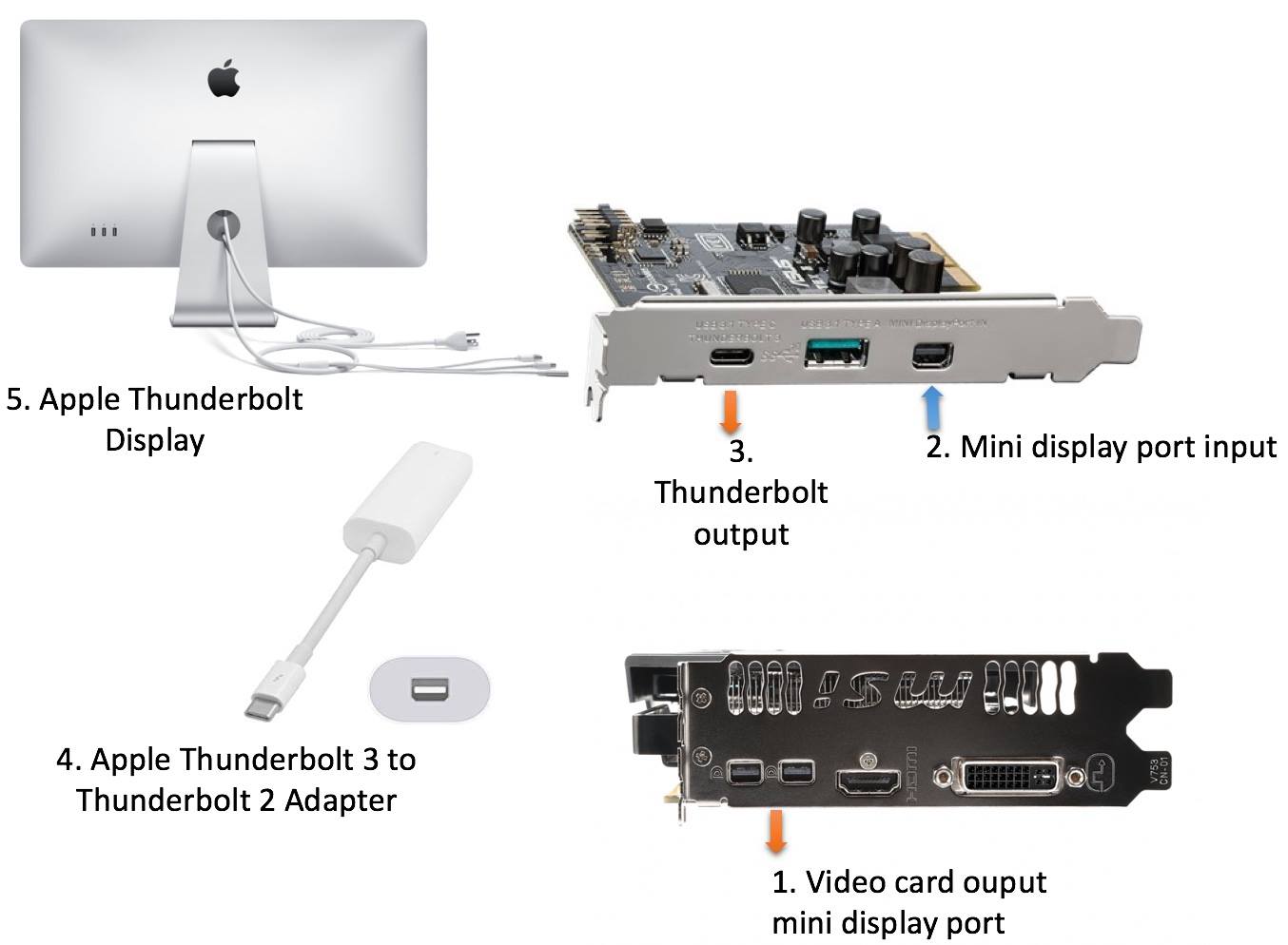

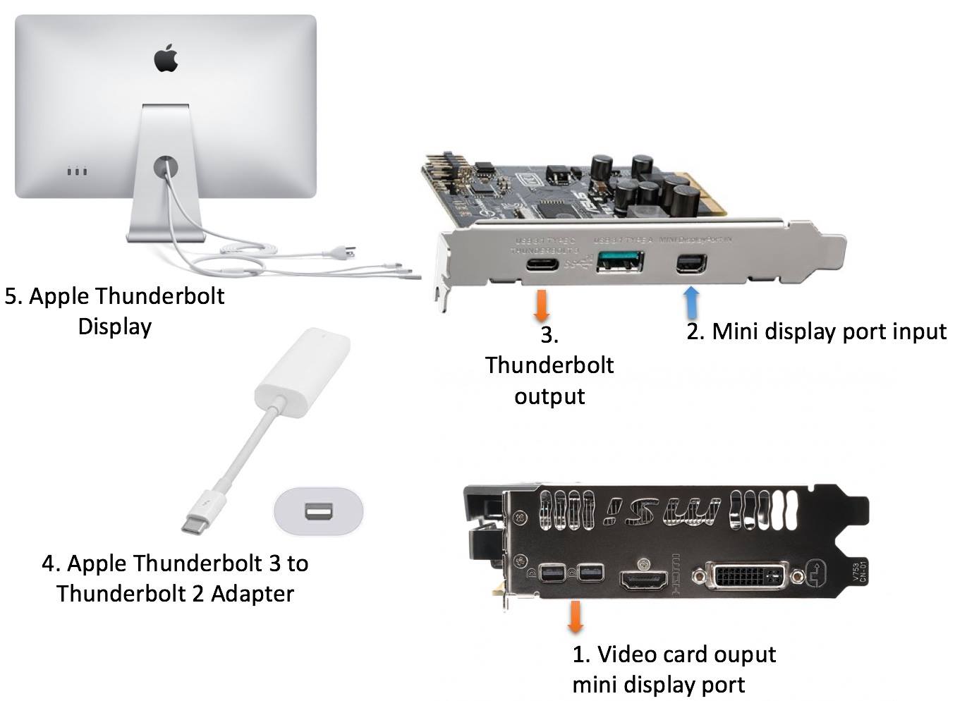

the only way is this (only for displays!):
could work without windows!?!

I did get this working buts its a bit buggy.
For example, sleep doesn't work correctly with a thunderbolt device plugged in so I need to unplug the Thunderbolt Display when I'm done working for the day, which is an annoying step. It consumes too much power at idle being from 2010 or earlier.
The Thunderbolt Display doesn't always come up when you power on the system, you need to unplug and replug it back in and wait 5-10 seconds for it to come on and then it requires a restart for the sound/webcam and brightness to work.
Its finicky but if you don't mind messing with restarts and unplugging it to get it work then its not a problem.
Once its working it doesn't fall off or flake out. It looks great, I run 2 thunderbolt display's in extended mode on my 5,1.
If anyone has any info to fix the issues I mentioned above I would love to fix them.

Wow, good job! I'm in a similar boat, trying to repurpose this otherwise beautiful Apple Thunderbolt Display.
Can you describe your setup and steps a bit more?
  1. What thunderbolt card are you using? Did you have to flash it and, if so, did you do it yourself or buy it like that?
  2. What version of macOS are you using?
  3. Did you have to install and use OpenCore?
  4. What Thunderbolt 3 to Thunderbolt 1/2 adapter did you use? Apple? StarTech?
  5. Do you need to boot into Windows first to warm boot the card and then boot into macOS?
Any details here would be great. Thanks!

I can warm boot into my 27" ATD using an Apple TB 2-> 3 adapter, hooked up to a Titan Ridge card in my Mac Pro.
However I can't cold boot.
OC 0.75 (Martin Lo package) with SSDT enabled and running Monterey.
Any ideas?

If you cold boot, all the features of the card doesn't work on a 5,1, like the sound or brightness control. I put in script that autorestarts it that first time and then comes back up correctly.
Could you please explain where I can find such a script? Presume requires auto login.
Just edit the autorestarter.sh and put your own username, it works great.
If I just want it to do a single restart I just delete the temp file it creates in the profile folder and then reboot it, if the temp file is present it will reboot twice.
