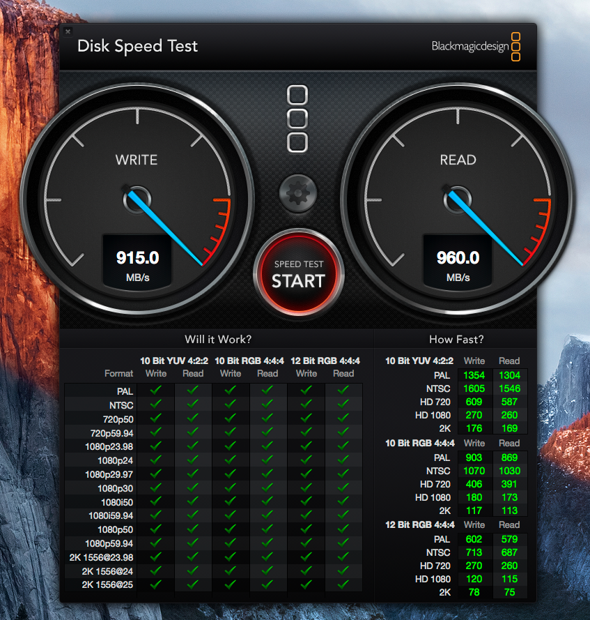

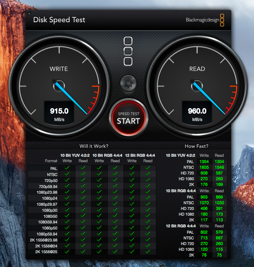

I upgraded my 2012 Mac Pro about 2 months ago with the AngelbirdWings PX1 PCIe Adapter and the Samsung 512GB SM951 AHCI M.2 SSD. I have noticed a significant speed boost on boot up and a slight improvement with apps such as Photoshop.
The Blackmagic app shows 915 single Write and 960 single Read (see attached screenshots). My questions is, are these numbers good for this upgrade? The Sonnet Tempo PCIe 3.0 SSD claims numbers of 1400+

Sounds like you've got it in slot 2. Move it to slot 3 or 4 🙂

I was able to get similar numbers if I let the app run beyond the first past. I will post new screenshot later today.
Yes, it needs to run a couple of times. It's simply because the needles in the app isn't quick enough to reach 1,5gb/s before the transfer is complete 😛 If they would just stop using that slow animation, or make a 10GB file instead of a 5GB, it'd show the correct speed.

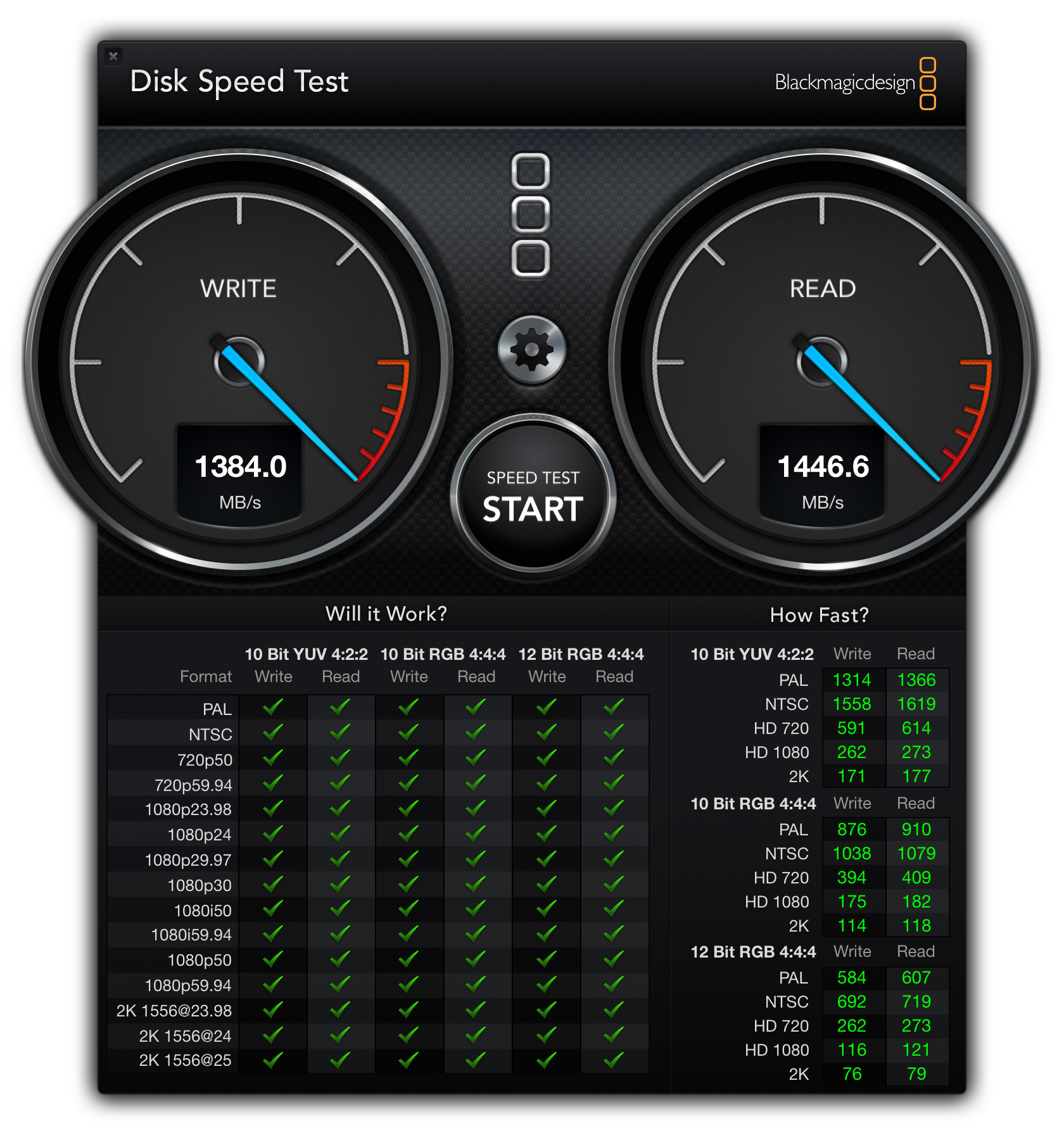

Ive got mine in a 2009 Mac Pro, 4th Slot. Averages about 1420 write and 1360 read.
Runs at only 90°F!

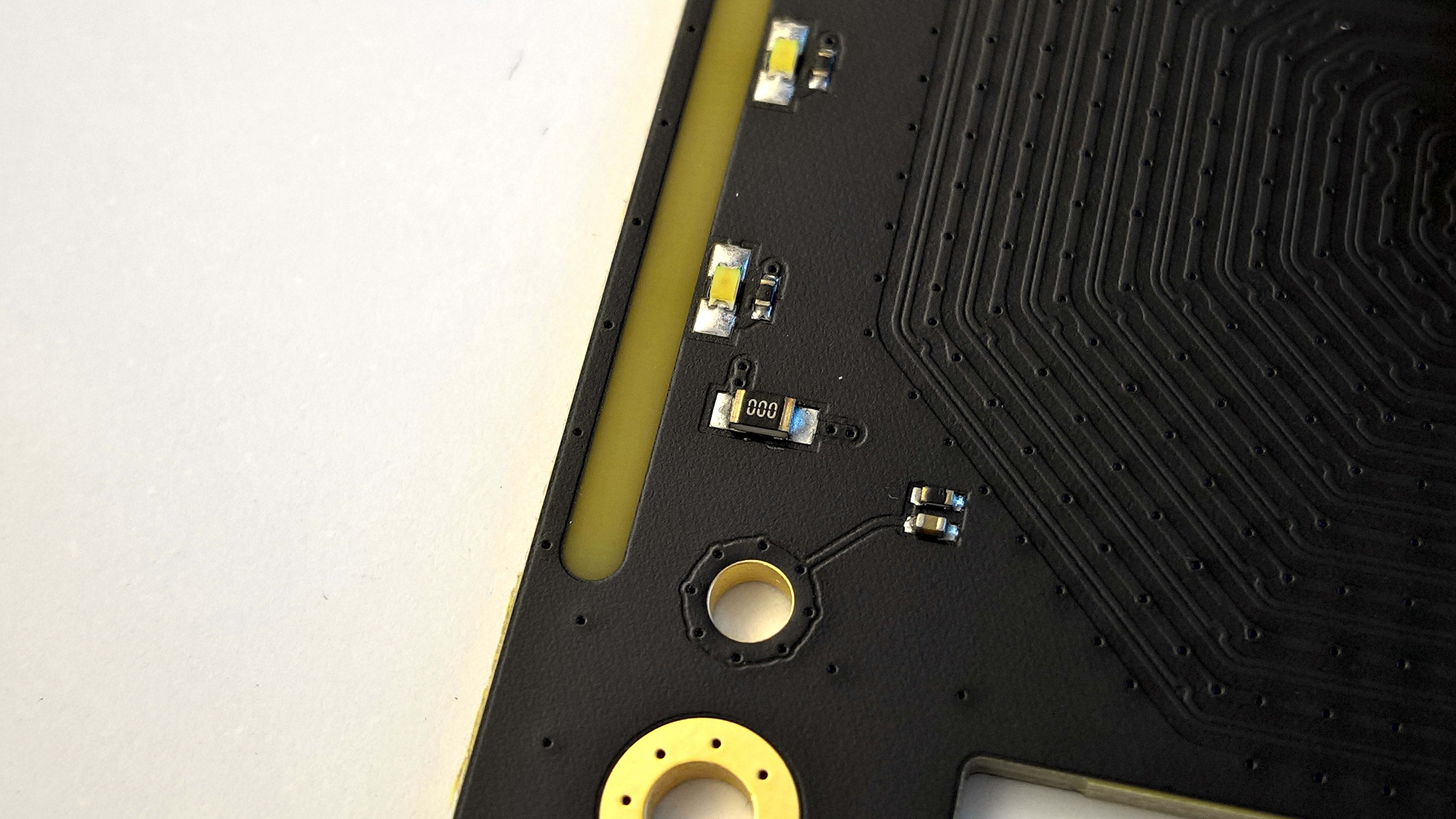

I did turn off the annoying LED lights by pinching off the 0-ohm resistor, otherwise my Mac was emitting way too much light for nighttime work.
Runs at only 90°F!
Could you, please, advise me where exactly is the 0-ohm resistor located on the PCB?
Thank you for the fast and very helpful reply!
So...When this is de-soldered ‘lights are off’, and it does not inpact anything else?
