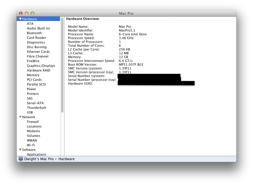

Theres a way of checking the SMC version. a real 5.1 has a different SMC on the board/processor plane. 1.39f11 is for the 5.1 and 1.39fs for the 4.1
and the 4.1 will be 1.39fs even if its been flashed to imitate a 5.1. you can PM me the serial when you have it and ill be happy to tell you any and all service history of the device if you wish.
Best regards.
"About this Mac" will normally still show the correct year (early 2009) even on a flashed 4,1 - 5,1. At least mine does.
It isn't until you get to the System Report section where you'll find any mention of 5,1.
Apparently not. I did specify, (How can I specify an ‘Original' 2010 5,1 system as opposed to a 2009 5,1 upgrade - by email), that it had to be an original 2010 5,1 model but we’ll see.
When it comes I’ll run System Prefs and check the frontside bus speed etc. The 4,1s were different were they not?
Mind you, I’m sure they have what it takes to re-write logic board serials etc….
Yeah with a 4,1 running a CPU native to that machine, it will show 5.8 for the QPI / bus speed. The 5,1 would be 6.4. However, if you flash to 5,1 firmware and install a Westmere CPU, you will get the same bus speed since the two machines have the exact same motherboard. Difference is only based on the CPU used and the 5,1 firmware.
Best regards.
Now that is very useful info. I’ll be sure to get in touch. Tks.
Never knew that either. Be interested to see if anybody else has that also.
Best regards.
Here we go…….
