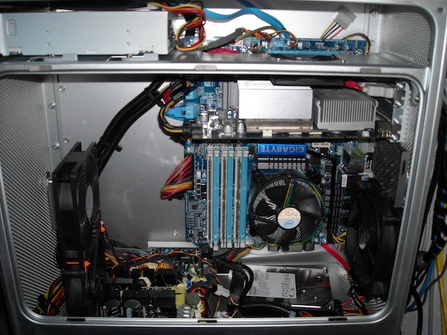

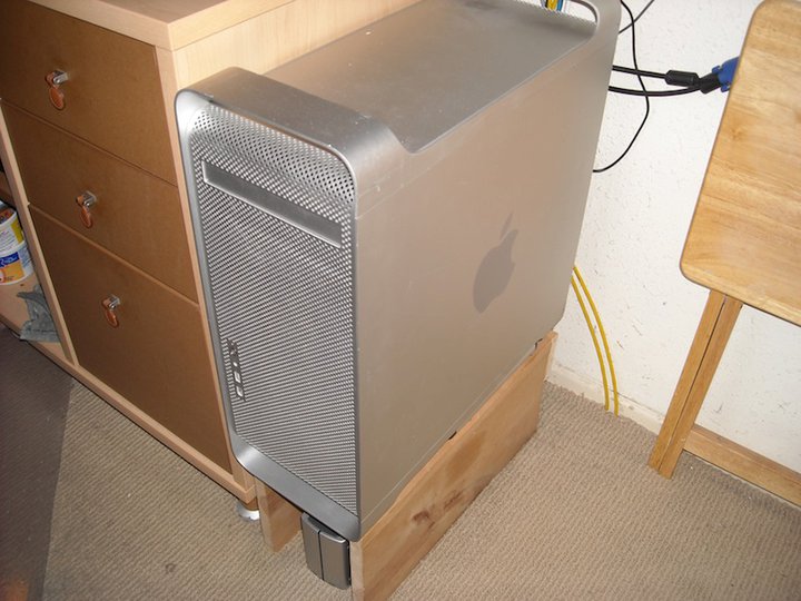

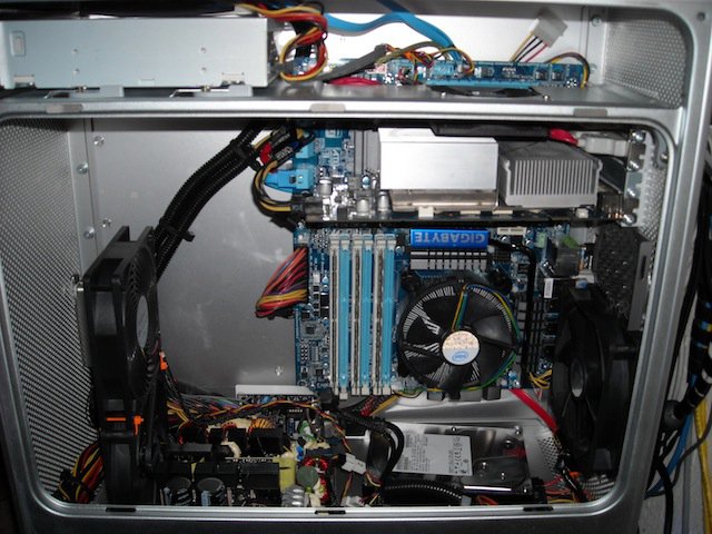

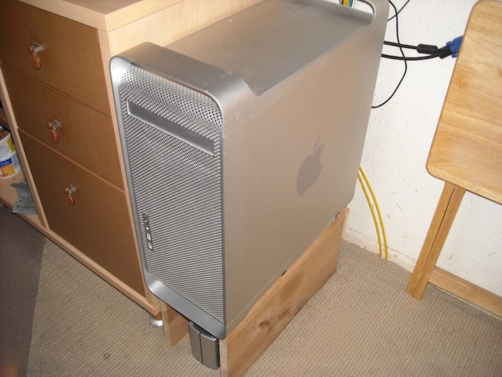

I did the G5 hack case, it was cheep (free) and easy to do, these are old pics of test fitting the fans and hdds.
Be sure to buy a Mobo tray with PCI brackets. It'll make mounting the motherboard 100x more easier. Just have to cut the back out and rivet the bracket in.
