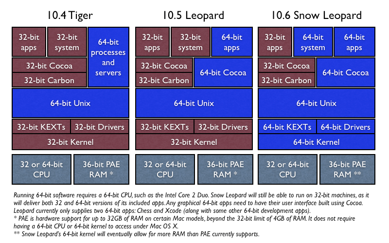

Hello, and thanks in advance for your thoughts and your help. A question was brought up on the macrumors forums about the shortcomings of the 2006 mac pro. Basically someone said that he would not get a used 2006 mac pro because "it can't boot into Leopard in 64-bit." I asked him what he meant and he said that he didn't think it was "true" 64 bit because in his system info it says "64 bit kernel and extensions - no". I poked around a little bit and found a good article:
RIGHT HERE
detailing that Leopard runs on a 32 bit kernel, mainly because every extension must be 64 bit in order to run on a 64 bit kernel, and that Leopard can run 64 bit applications even though it runs on a 32 bit kernel. The article states that Snow Leopard will be the first operating system on a 64 bit kernel.
Now, my question. Since my Mac Pro runs on 32 bit EFI instead of the new EFI 64, will I be able to have a similar 64 bit Snow Leopard experience? Will my EFI on my antique mac pro really limit the 64 bit Snow Leopard experience? Will my aluminum macbook be able to "do" more with snow leopard than my mac pro? and lastly, I am currently running the Radeon 4870 in my mac pro, since the guys at ATI snuck the 32 bit EFI onto the card as well as the 64 bit EFI, somehow. I wonder what's going to happen with all this when Snow Leopard drops. This question was brought up in a thread a few days ago and it got me thinking. I asked this question at the apple boards but have gotten no feedback. So, all of you smart folks, I look forward to your sage words on the matter.

From the article Bozz points to... does the 10.6 case (picture on the right revrt to the 10.5 case (picture in the middle if 64 bit drivers aren't (or can't be) loaded because EFI32 hampers the process in some way???

I'm not understanding your question. That picture doesn't seem to point to evidence about EFI32 preventing the 64-bit kernel from loading. I'm not saying that EFI32 does or does prevent loading 64-bit kernel, but rather that the picture you linked doesn't seem to indicate one or the other. To be clear, I don't know whether or no EFI32 will prevent loading 64-bit kernel, and that is precisely what I want to know.
Sorry... a little toio vague I guess. I'm not suggesting that the EFI32 in the mp1,1's will prevent the loading of 64 bit drivers. Like you, I don't know. I'm just wondering IF 64 bit drivers can be loaded via the EFI32. In the sturcture on the right, (10.6), the driver and kext layer shows these as 64 bits along with the 64 bit kernel. And I've seen a few reports that the 64 bit kernel won't load if the drivers aren't 64 bits as well.... I don't see any provision for mixin'-and matchin' 32 and 64 bit kernels, kext's, and drivers; and if can't your stuck with the 10.5 structure; 32 bit kernel, kexts, and drivers.
I for one won't be a very happy camper if this occurs. I know, I've read it a hundred times here already... "it won't matter, it's the future 64 bit apps that matter". Yeah, right. If that is the case, then why is apple even offering a 64 bit kernel??? A 32 bit kerel should be good enough for everyone right???
I agree with gugucom that the EFI32 boot shouldn't mater. But what if it does??? Color me paranoid.

well, you are completly wrong.
I'll be that gladly. But can you please elaborate???
hyram
when you see spinning wheel at boot, there is no more efi, kernel controls all.
drivers doesnt care what efi you have.
bootloader(boot.efi) is responsible for loading kexts/mkext for startup, and it perfectly knows about 32/64-bit kexts/mkext and kernel
Ok, but by the time you get to that point aren’t the drivers… specifically, the video drivers already loaded from the video card??? So don’t you have to have the driver match the version of the EFI??? I’ve seen many a thread where some of the newer video card’s can’t be used in the mp1,1 because the drivers are 64 bit. The GTX285 comes to mind. If the EFI version doesn’t matter then someone running SL on a mp1,1 should be able to get one of these new cards to work. If not, what am I missing here???
