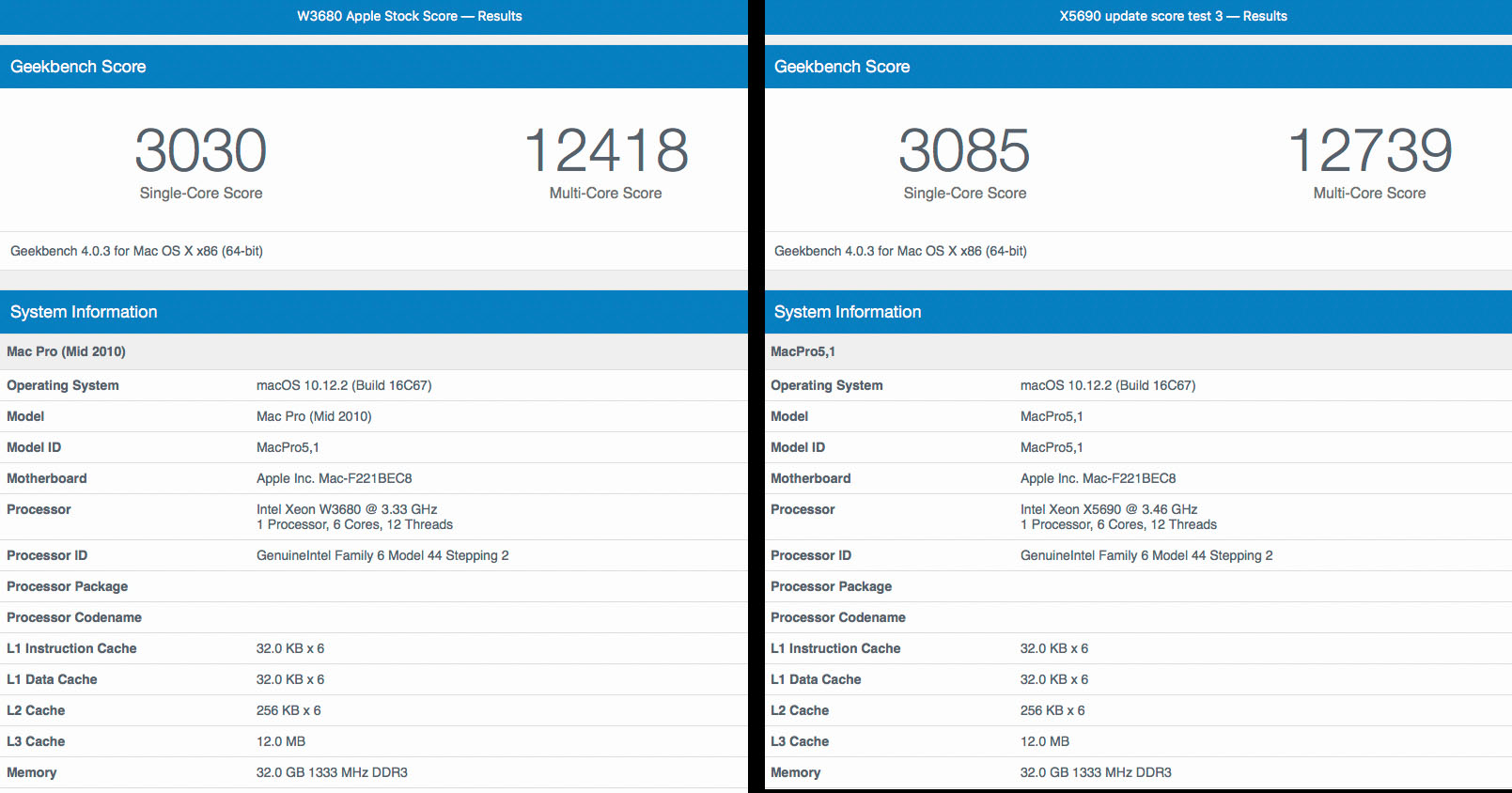

I just installed a new X5690 3.46Ghz processor in my 2010 6-core 3.33 stock Apple Mac Pro. I have to report the geek bench scores are improved slightly but not great. I would not recommend this over a new mac. I am going to let the machine run for several days to see it it burns in and improves but I feel like I have just woke up from a party with a tattoo on my forehead. Fortunately it was not an expensive upgrade and my cMP is running fine.
Will the scores get better when the new cpu burns in?
single core and multi scores.
OLD: 3030 & 12418 NEW: 3085 & 12739
Your scores are fine, but could be slightly better. For comparison my 6 core Xeon W3690 3.46 GHz: https://browser.geekbench.com/v4/cpu/1388689

I was being hopeful. However when you have a pro service do the upgrade some test the CPU tray for 8 hrs before sending it back. I just assumed I might have a bad chip.
I have run Geekbench 4 multiple times and the score has been different each time. I even ran the GB test after restarting in safe mode and the scores were 1/2 lower. I also checked Activity Monitor and I see that I have junk running in such as 2 versions of EEventManager running and one is RED(not responding) but taking 0.46 CPU time. So I have some cleanup work to do before getting to disappointed.
I do not trust the geek bench app because it basis it's score too much on gpu. I also did the same thing recently when I upgraded my CPU. But for me the real benchmark was with logic. There is a project out there to test your machine. Before I was maxing out at 70 tracks after the change I was maxing out at 170 so the upgrade was well worth it.

Your single core score performance shouldn't improve much. Going from 3.33GHz to 3.46GHz is a tiny change--only 130MHz difference. I doubt it is noticeable in any real life use.
Burn in is for testing against parts failure when something is first being used. There should be no expectation of a speed increase due to burn in.

Every Geekbench test is different but all in I got 2.7% increase on the single core test and 3.2% on the multicore. Good news the new X5690 processor only cost $200 and I had fun putting it in. The SSD on the Velocity Solo card has been the best investment of all my updates.
NOTE: Since every test run is different I suspect I have garbage in the system that needs to be removed. Sierra is bogging my cMP down.
