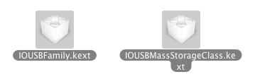

If you can find them, I believe you'll need to replace these which are in /System/Library/Extensions:
I don't believe Time Machine backs up system files, just user files, so it would not have a copy of the kext you need. that said, you could try to replace that kext, but you would need to get one from the exact same model that you have now. Each mac has different kext files for stuff like that (trust me, personal experience trying to replace a corrupt kext on a MacBook Pro with one from my Mac Pro)
You could try an archive and install (or whatever it's called)
