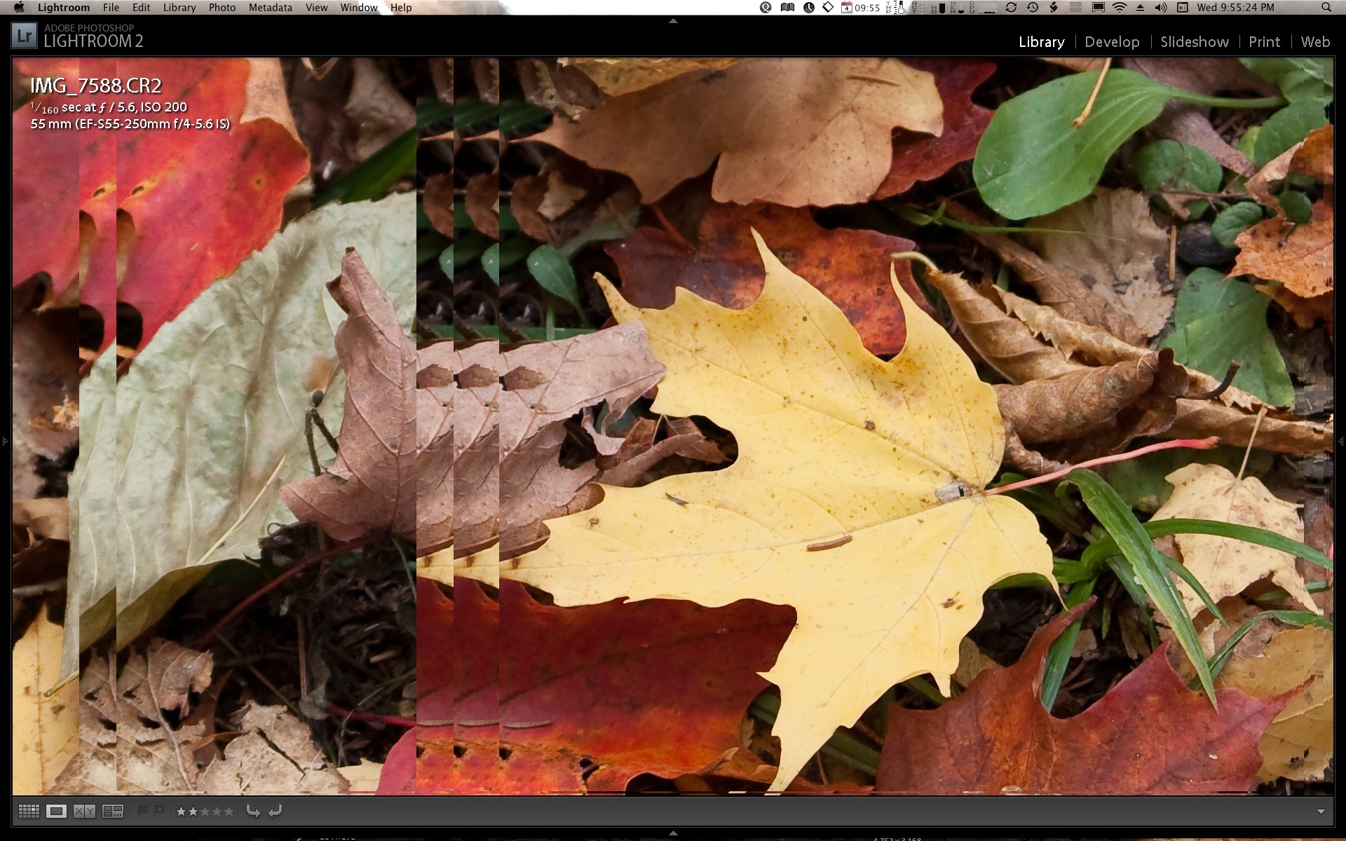

Anyway, I'm not sure what it is that I'm actually getting for my $350. I really don't see any obvious improvements. In fact I've noticed at least one thing that's not working right. In Lightroom, when I drag a zoomed portion of a photo around the screen really fast I get severe tearing (I think that's the correct term). This does not happen on the 7300GT. See attached screenshot.
That is some bad tearing there...i'm glad you were able to figure things out... is it only in Lightroom?
I'm still a bit dumbfounded that Peace was trying to say that your card wouldn't work with a 1.1 MP?....I mean who cares if Apple doesn't OFFICIALLY say it is compatible... I agree, that is probably what they would tell you over at the Mac store... which is why SOME of their techs are so sad. Anyone who just concludes something is not compatible without research shouldn't be a technician anyways...
My boss has has the same problem on his 2009 MacPro since upgrading to Snow Leopard. It didn't happen in Leopard. We figured it was the OS.
Hey guys, does any of you happen to have this card and Lightroom, and are running SL (10.6.1)? Have you noticed this much tearing on your setup?
Lightroom tearing, while admittedly annoying, is not a killer issue for me. I'm just afraid that this may be an indication of other things potentially being wrong with this card on my system, or with my particular copy of this card. I have tried fast-dragging an image in PS4, the Finder and Safari and have seen no tearing. Also no tearing in Lightroom in Windows 7 running in Bootcamp. Actually, the card seems to hum right along in Win 7. My Windows Experience score went up from 4.2 running the 7300GT to 7.4!!!! Sorry to say, but LR seems a lot faster in Win 7 than in SL, at least when it comes to importing RAW files. Hm...
I have a MacPro 1,1 with 6GB RAM, official 4870, heck I even have the same monitor as you and I have no tearing issues in LightRoom. I'm not sure whats causing it on yours, or my boss' 4,1 who has the same issue.

Regarding the tearing issues, it does look like it might be OS related. I don't see it under Win7 in Boot Camp. I'll fire up my 10.5.7 Leopard partition tonight to check LR in that environment.
Yeah, the tearing is probably a result of bad ATI drivers in OSX. Next update, 10.6.2, will bring updated drivers. Hopefully some fixes to your problem.
I have the 10.5.7 drivers lying around somewhere. If tearing is gone when you test tonight, give me a shout and i'll upload them so you can try installing them in snow.

I could only get very minor tearing to occur occasionally in LR (2.5) but only when violently dragging a zoomed-in photo back and forth (Don't usually find myself doing that under normal circumstances). Tearing never remained long enough to grab a screenshot. Photos are camera Raw files from Canon Rebel XTI.
Setup is: MP 1,1 , ATI 4870 (apple version) OS 10.6.1, 6GB RAM...
Have you tried Lightroom 3 Beta yet?
Did my little LR test under 10.5.7 and saw no tearing. BTW, benborman, I use a Canon T1i and work RAW in LR, just like you.

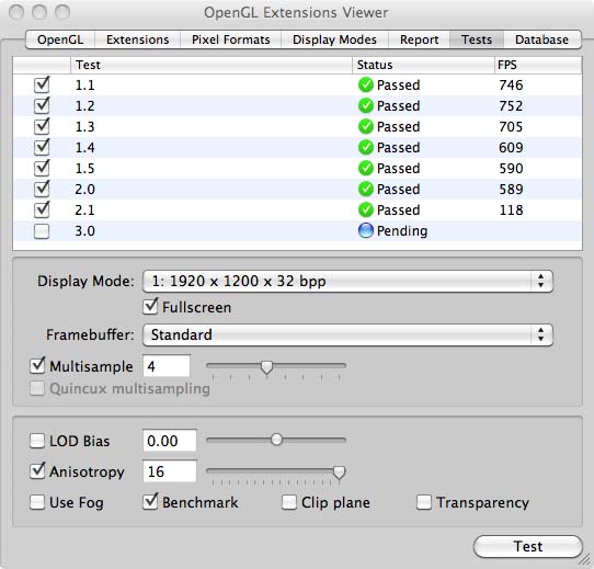

I'm attaching a screen shot of the OpenGL Extensions Viewer test page. I ran the test using the same settings as on the krull site. My FPS numbers are 5-10% lower. I assume it's because he ran his tests on a newer/faster machine.
So it seems the verdict is my 4870 is working well enough under SL, hence I don't think I'll bother Cindori about the 10.5.7 drivers.

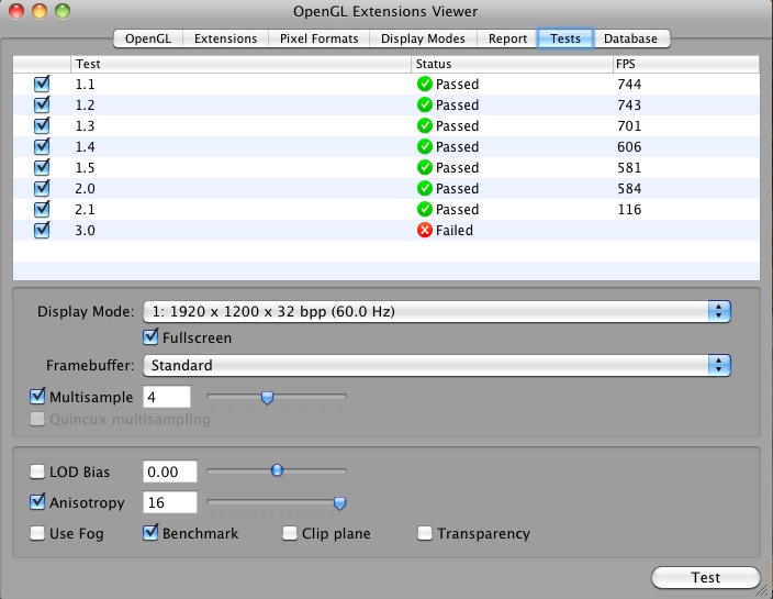

Yes, some of the test figures out there were run on faster Mac Pros. Here's my OpenGL Extensions Viewer results for the 512MB XFX 4870 (flashed with Apple's ROM) that I put in my Mac Pro 1,1 2.66GHz 2xdual-core (4 cores total):
As you can see, my figures a pretty much the same as yours.
