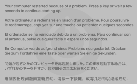

I've had a problem with my 3,1 Mac Pro (see sig).
I was on it and it froze and blue pixel stripes come across the screen. Upon restarting, it got back to the desktop (but not fully loaded), and the blue stripes came up again and it froze.
Now, on restarting it gets to this screen...
...and proceeds to restart over and over again.
Anyone have any idea what's wrong, or what hope I have to fix it?

OP, don't bother. You need new graphics card... or bake this one -> google (it should work few weeks or months but it will fail again). 8800GTs are dying like that. It's common issue and symptoms are clear.
I thought that could be it, so I switched the DVI cable to the ATI 2600XT. Would the 8800GT still crash the computer even if the screen's not connected to it?
I would like to report that you are correct sir.
I took out the 800GT altogether and everything is back to normal.
Many thanks for your help guys 🙂
