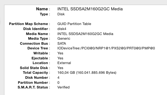

Another odd thing is that the disk appears as ejectable. I wonder if that's the problem: The system sees this as an ejectable disk and therefore won't boot off it.

And OSX still believes that the disk on the Velocity card is "external", not internal.
Is there anyone here with a Velocity card in their Mac and could do a quick check for me, please?
Please open Disk Utility and check if the disk's Location is Internal or External.
If it's internal, some more info, such as the card's IDs etc. from the System Profiler would be nice, too.
Here are my values from Disk Utility (with my old SSD on the Velocity card):
And from System Profiler's PCI view:
As far as I know, any drive not connected to the Mac Pro's built-in SATA ports will appear as external.
Reactions: crjackson2134
I just watched the installation video and noticed that it, too, showed the Card's SSD as External. Okay, so that's not the issue here.
