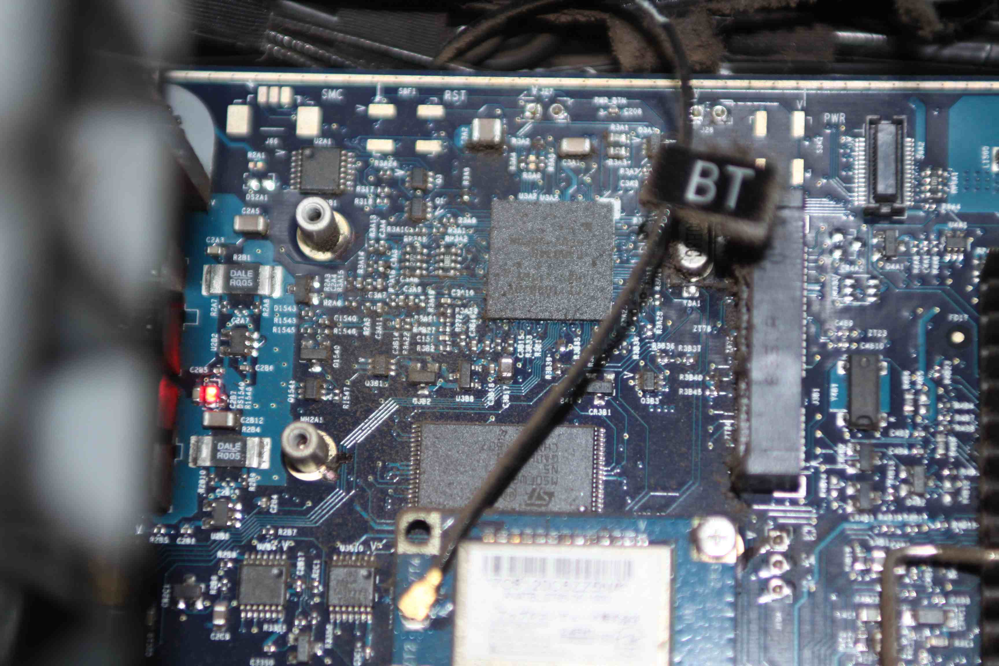

red led

After all , I really don't think that my problem is or was electrical issue , so I'm trying to understand what is happening with a lot of Mac Pro early 2008 , that suddenly have been power off alone , and has the led red near bluetooth . Someone told me that this is a serial problem , that Apple Computer didn't do a recall and the problem is with the chipset . I've changed one to make a test and since saturday it has been working fine - no power off and no red led near bluetooth . I hope that is the final solution . After some more tests , if everything is ok , I'll send this report to Apple Computer .
I am not sure what that light is. Can you send an image?
Have you checked the diagnostic LED's, which are located between the DIMM risers? There are instructions at http://www.scribd.com/doc/38650092/Mac-Pro-Early2008-Copy#outer_page_154
Spidey!!!
The led isn't located between risers boards , it is near the front fan and bluetooth , according the picture attached , and you can see an old discussion at Apple Suport Comunities :
