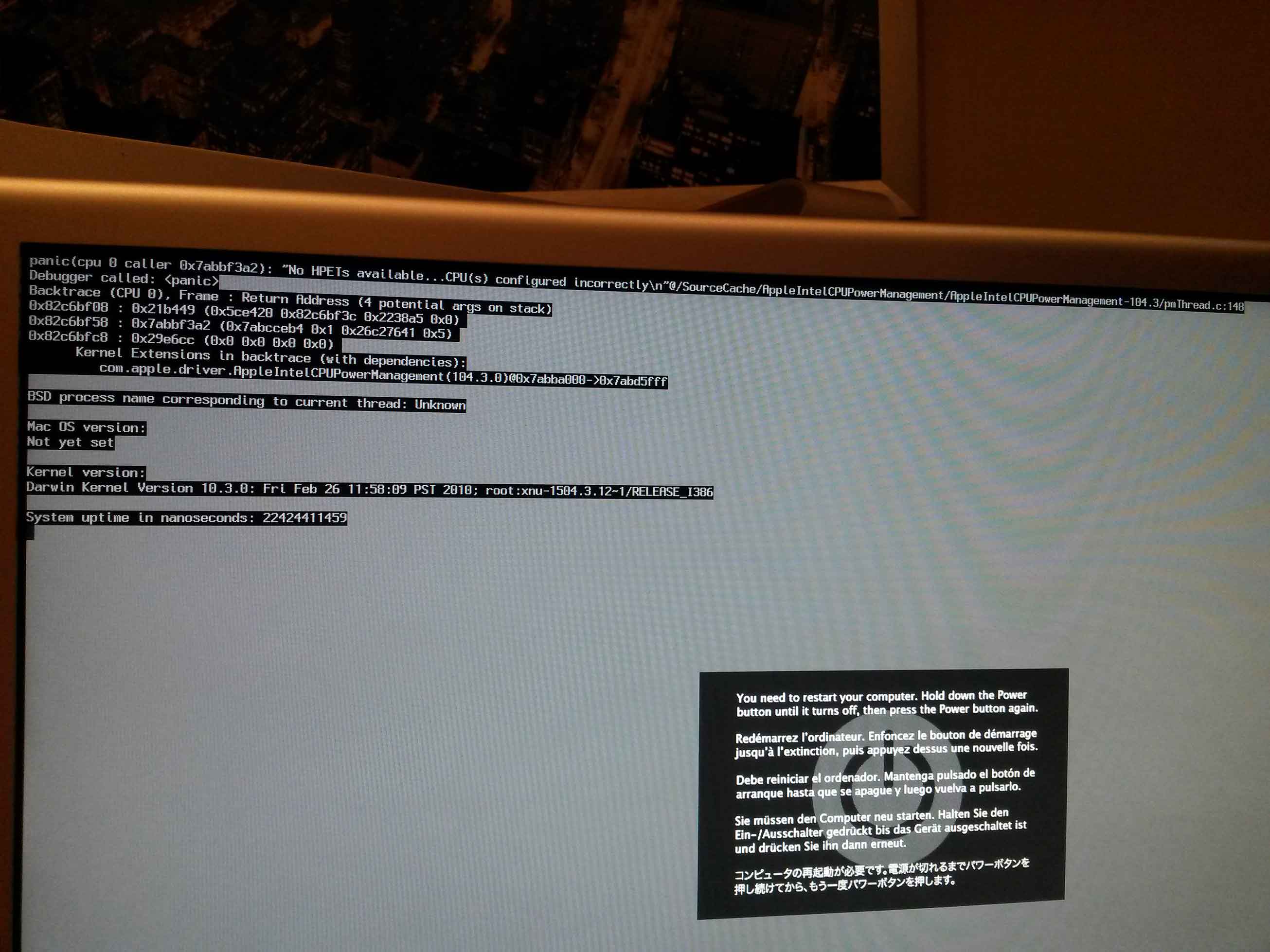

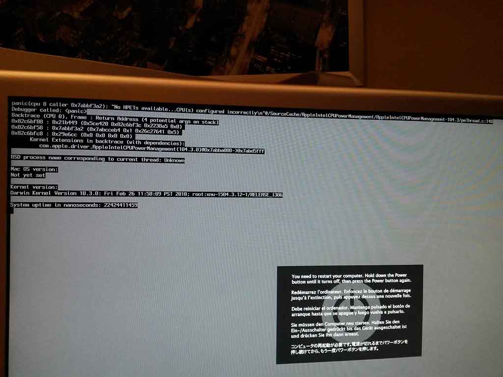

a while ago i had to replace the RAID card battery, so i did this, over a year later the same thing happened again, but as previous just left it and the system seemed fine for ages, until last night i was working in PHOTOSHOP and everything just froze and the screen kind of appeared GREEN, could not do a single thing. So restarted the mac, this time grey screen for ages and a message appeared, (macs version of blue screen) (see attached).
I restarted the machine and this time a flashing question mark folder!
