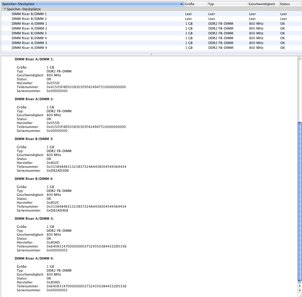

I installed 8x1GB RAM on it but i can only see 6GB at the System Profiler.
The two hidden RAM-modules are perfectly working if i plug them on Riser 1 and 2 in Dual-Mode (Riser A - DIMM 1 // Riser B - DIMM 1).
The Modules are all grouped in pairs.
If i change the position of the not working RAM-Modules, they arn't working at the new place.
What can i do, to fix this problem ??

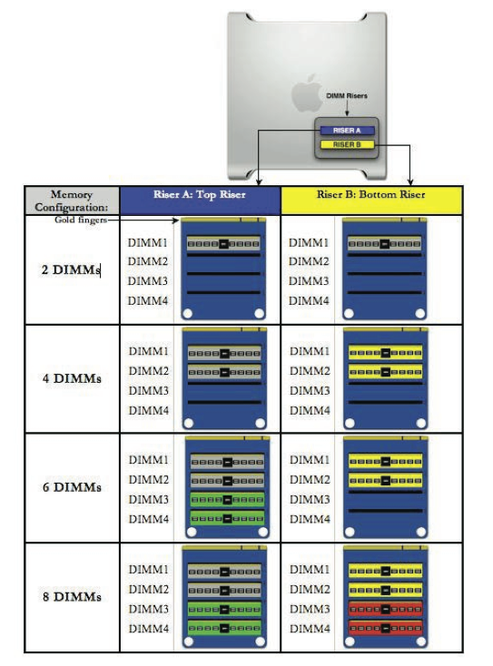

I have checked all RAM-Modules in the 2GB Mode (see Screenshot 02).

hmmm ... i thought the daughterboard could be damaged ... but when i change the position of the damaged RAM, they cant be seen at the new position (in Profiler). For example:
This is my status:
Riser A - DIMM 1 - OK
Riser A - DIMM 2 - OK
Riser A - DIMM 3 - OK
Riser A - DIMM 4 - OK
Riser B - DIMM 1 - empty
Riser B - DIMM 2 - empty
Riser B - DIMM 3 - OK
Riser B - DIMM 4 - OK
If i change Riser B - DIMM 1 and Riser B - DIMM 2 to any other position it looks like this:
Riser A - DIMM 3 - empty
Riser A - DIMM 4 - empty
Riser B - DIMM 1 - OK
Riser B - DIMM 2 - OK
(only for example!!! I could try every position)
Maybe your' right to buy new RAM-Modules with 4x 2GB ... ;-)
