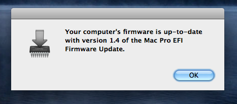

I agree, the behavior is strange. I find it bizarre that this application is kept around at all after applying the firmware. Maybe someone else knows of a situation that can be useful. If I had tried running it like you did before reading this post, I'd have been concerned too.
On an 09 Mac Pro it sit's in the utility folder and says this if you click on it...

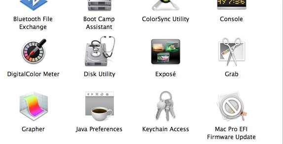

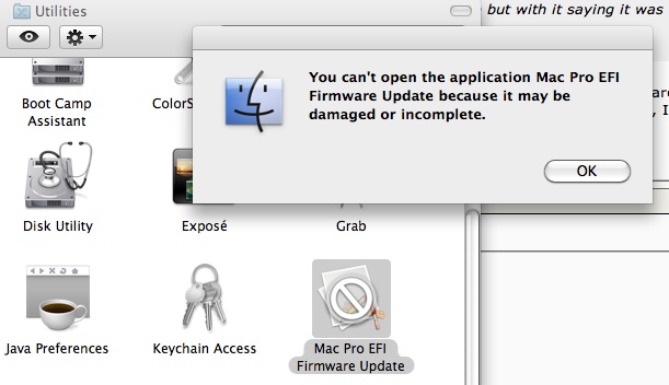

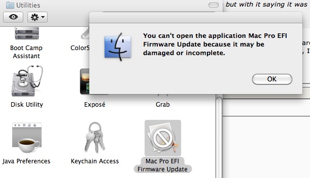

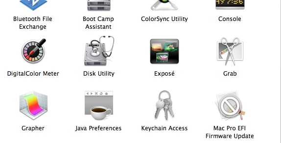

Here's the pics of the app in my Utilities folder on my mid 2010 Mac Pro after installing firmware 1.5.
You'll see the app has no proper icon and the error message saying it is incomplete or damaged when you try to run it.
Is this what you get dissolve?
