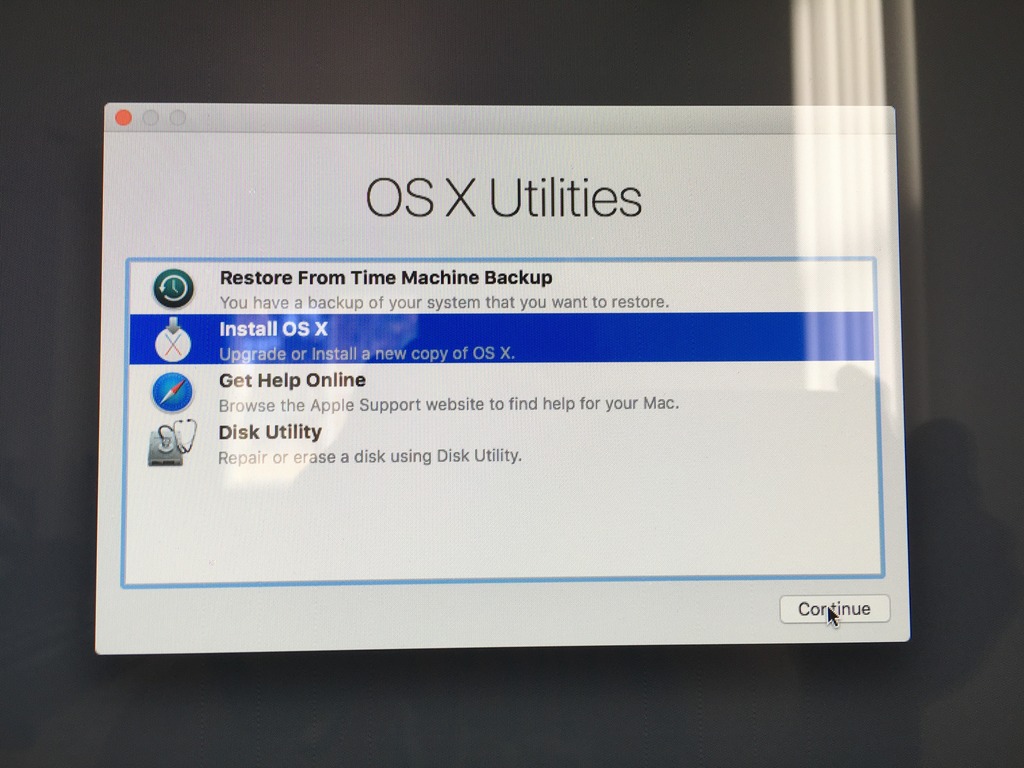

First remove all of the hard drives apart from the one you want to do a clean install to just so you don't wipe anything you need by accident.
Hold down ALT when the machine starts and select the USB stick as your boot choice.
When it loads up (can take a while), choose disk utility from the menu bar and format the drive you want to do a fresh install to. Once it's wiped close disk utility and follow the instructions to install OS X.
Sit back and let it do its thing.

At this screen what do I do?
