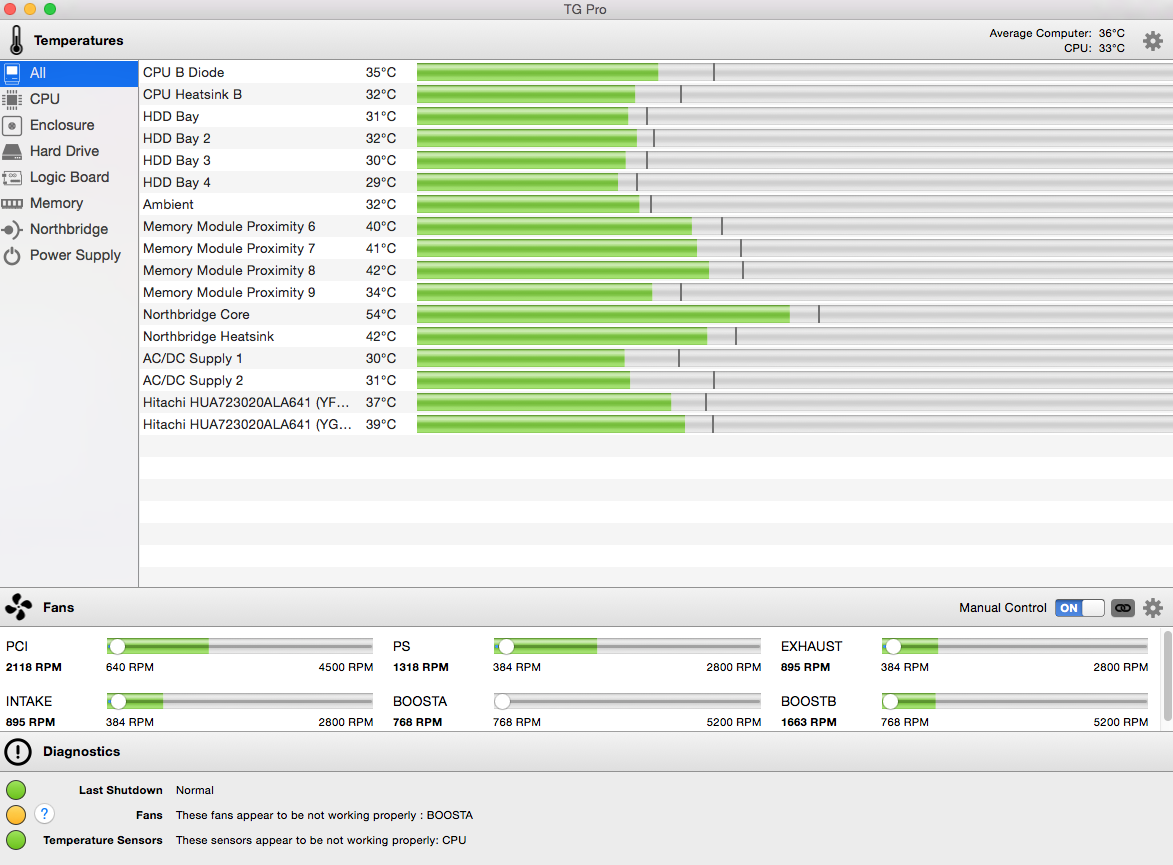

i got a problem. i did a 8-Core to 12-Core UPGRADE and now the Core A and Diode A is not showing up Temperature and speed in TG PRO or iStat.
in System Monitor it shows up 2x 2.66 6-Core, everything works fine, but BoostA makes constant noise.
PRAM and SMC Reset is done.
nothing changed.
TG Pro in manuall mode on and off.
Screenshot from system manager.

Note that CPU A and Heatsink A temperatures are missing in your screen shots. Basically, the heatsink isn't contacting the correct surfaces, so the temperature data isn't getting through, so the fans are operating at full speed.
