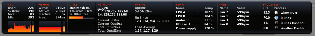

Here. I wasn't sure how to get RAM temps.

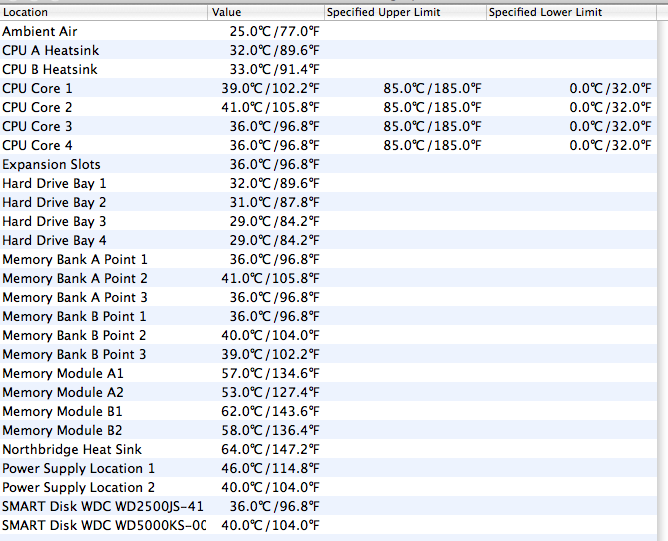

Guess I should post my current readings as of right now.
Memory Module A1/A2 are the stock Apple DIMMS
Memory Module B1/B2 are the OWC 1GB DIMMS (actually, they are the NetStat DIMMS....that's what they sent)
As you can see, the OWC DIMMS are running hotter. This is under no load.
-Kevin
Yikes. High Temps.
I don't know what any of it means.
i didn't bother getting RAM with heat those heatsinks.
bad?

What's your memory configuration. Brand, Amount, and Location?
The one bad thing about iStatpro is that for some reason I can't get it to get a temp reading on anymore than the first 2 modules, I'm guess on Riser A1/A2. For me those are the stock Apple 512MB DIMMS. As you can see from my image, those are running cooler than the OWC DIMMS.
Yours are a little high, but looking at your system, it also looks like you were doing something (your CPU was working hard)? Alot of your readings were high...CPU, RAM, Power Supply. What's your setup look like? Is there airflow?

1 Gb FB-DIMMs can be expected to run hotter than 512 Mb FB-DIMMs, there's twice the number of transistors in there...

My RAM temps are similar, maybe a little lower. 123-129ºF. 4x512MB modules from Apple. My other temps (ambient, HDD, CPU, power supply) are all 10-20ºF cooler than yours though.
Any idea...generally...how much hotter I can expect 1GB DIMMS to be over the 512MB DIMMS? 10F higher?
Under little load, with an ambient temp reported as 70F, my Apple 512 DIMMS on Riser A are running 130F and 122F.
The OWC 1GB DIMMS on Riser B are running 137F and 131F.
Under load the OWC DIMMS tend to spike much higher than the Apple 512 DIMMS.
