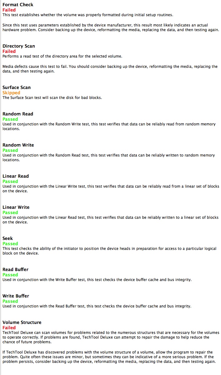

I just ran Techtool Deluxe and this is the result I get back for my SSD. Otherwise all other HDDs prove fine.

Are you sure the tool is optimized to work with SSD"s though?
It also appears that the "Failed/Skipped" sections are for mechanical disks.
That's the problem, I think this tool is not accurate as it was put on the market in 2006 long before SSDs were on the mainstream market. Is there any other way I can narrow down the problem without having to take in the Mac Pro into the Apple store.
