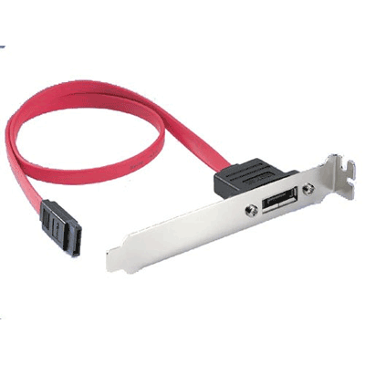

If you really want it (what would pretty much destroy the resale value of the machine), cut a hole in the front and use a standard SATA to eSATA cable like this: (minus the slot cover of course 😉)

If not, the easiest thing to do, is use what Transporteur linked. Unscrew it from the PCI bracket, use the hole to pencil the opening and screw holes on the case, and get out a Dremel to cut away the aluminum. Then screw it down (might want to get different screws of some kind, such as flush mounts or Button type Torx for example).
Finally, attach the SATA end to an available port. If you don't have one, get a SATA card (here as it's the only card that's selectable on the ports, and the seller will ship internationally; just understand if you use this, it cannot boot OS X, only work via drivers here).

He'd need to be able to make a custom board. Past that, the device Transporteur posted would be the best, and easiest solution (just mod the case, and attach the cable to a SATA port; no PCB work).
