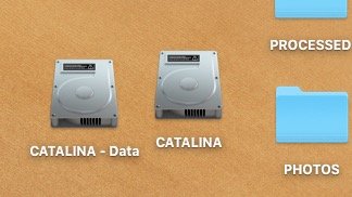

I have now installed Catalina via DosDudes patcher, and it appears all good so far although I’ve not really tested it yet. 👍
I installed it in a separate internal hard drive that had another Mojave OS on it I used restart on for maintenance purposes of the other internal drives. I installed it on a new volume on that drive. One little thing, I now have this volume and another similarly named volume that also appear on my desktop and are a bit of clutter.
CATALINA
CATALINA - data
I have tried to hide those in terminal but I think perhaps I’m not doing it correctly as they still appear… any suggestions to hide those on the desktop?

This is the structure of a bootable macOS drive on Catalina and later.
CATALINA is a locked, unwritable volume that contains the macOS.
CATALINA - Data is a volume that contains everything else; apps, user files, etc.
It's called a 'volume group' (this is in APFS) and it should show as 'CATALINA' in Finder, anyway just leave it alone, if you double click any one of them you should get the same window opening, with library, apps, users, etc.

Yep, the ' - data' drive only appear on the desktop when Mojave is the start up disk, I have another hard drive in the same Pro with the Catalina OS on it, it doesn't appear there when using Catalina OS, which is fine. I've always had dual OS on seperate drives in the same manchines for disk maintenance purposes. Catalina works perfectly on the test rig so that will go on the other 5.1s now. I have two new Mac Studios planned for purchase in March to add to the office so all good.
